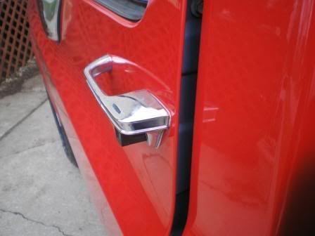

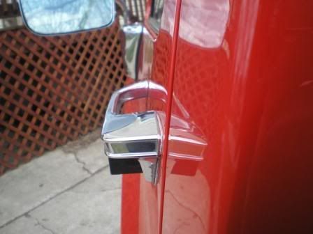

When shut all the way, the door is flush with the cab.
This is what happens when you don't shut it hard enough.

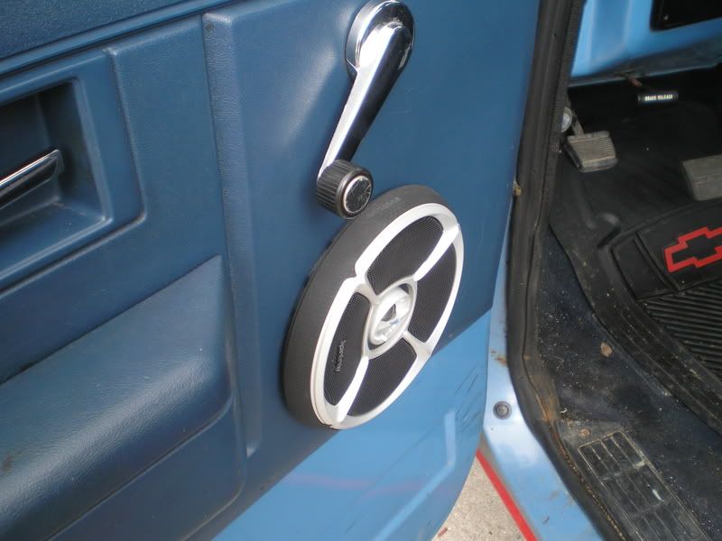

The speaker is no big deal. Just a little guy in the open spot below the window crank.

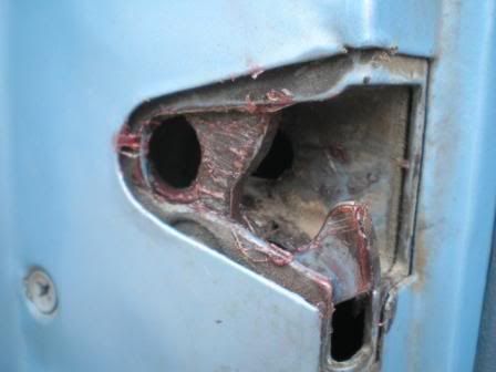

Here's the latch. You probably can't see a problem by looking at it I guess...

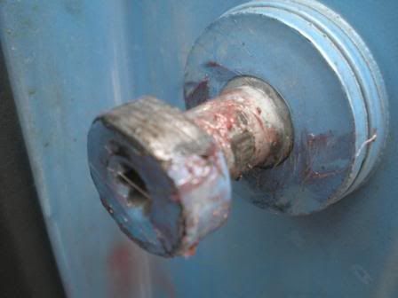

The striker, but I assure you, my door pins are strong. The door doesn't budge when I move it. The truck just rocks side to side.

Loosen the striker so there is still some tension on it and shut the door. Press in towards the cab slightly and hold the handle button in to open it nice and slowly. Tighten the striker bolt so it doesn't move. that should get you in the ball park. From there adjust it a little this way or that way accordingly. Good luck
