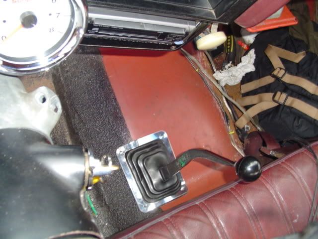

He converted it to a Hurst Indy shifter.

Ahh the old Hurst 3 speed floor shifter. They are such a joy to drive. Perfect H pattern or they get jambed into two gears at once. Nice tach for a 6 popper.
