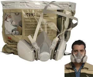

I use a regular 3m painters reperator for Fumes and vapors.  It will filter Iso's if it is new.  If you start smelling paint, then you can assume Iso's are also getting through.  This is a very much debated topic - it's up to you though to determine if you want to assume the risk.
This is what I use:

I work as a maint mech in a GM paint shop and we get tested every year for isocyanate exposure. Simply stated, You don't want that stuff in your lungs guys. It doesn't come out.
