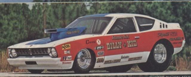

i've been thinking more about this lately, and i've come up with another plausible explaination:
If we look at the following picture, and i know it's a "mitsupar" but it still looks cool anyways,
We notice that the really fast drag cars are built low.  But if the wheels were located in the stock positions, the top of the tires would scrape against the bottom of the fender lip openings.  Therefore, in order to be able to have a low ride height, the tires must be located several inches inboard to clear fenders.
i just think it looks so cool irregardless.
