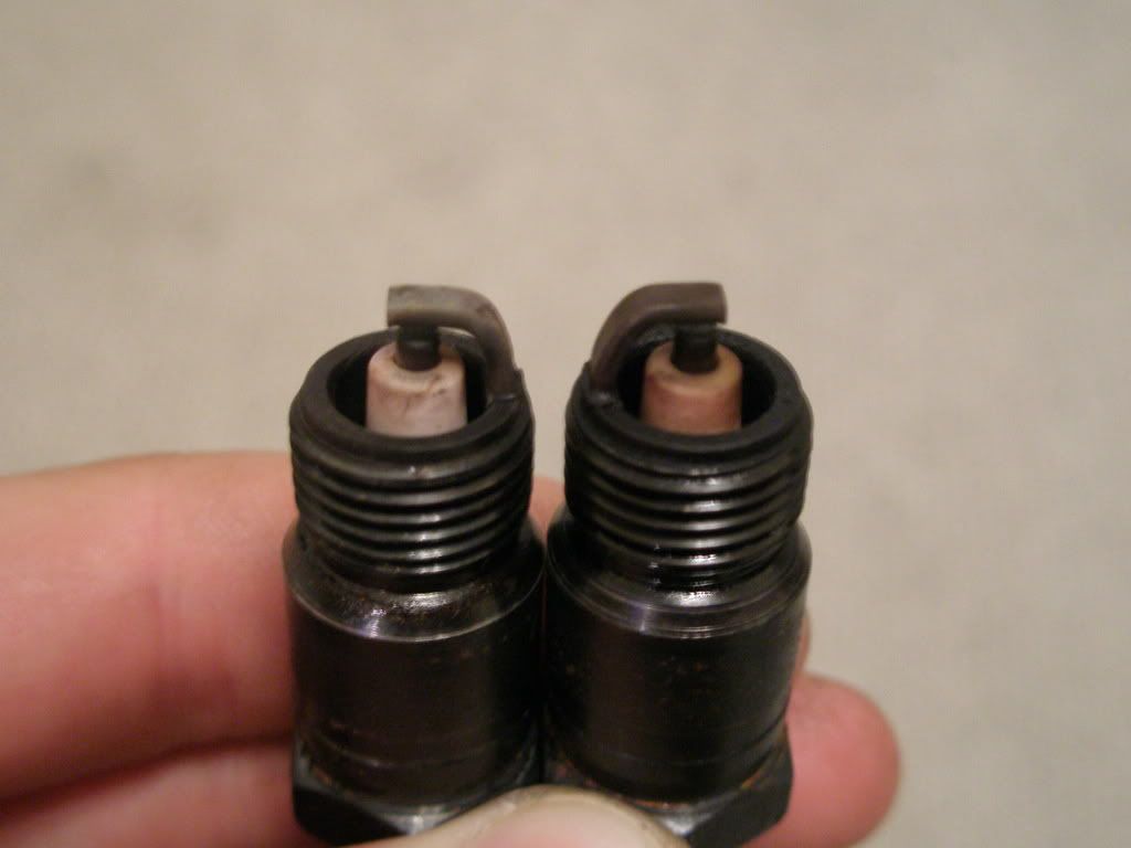

Okay so I've had the new 350 (stock with headers, edelbrock intake/carb) in for a while and it runs pretty good overall. But I have a "soft spot" from about 1000 to 1500 rpm while gently accelerating in top gear. No matter how lightly you roll on the throttle there is some noticeable hesitation. It almost feels like my old 305 used to feel when it was under heavy load/light throttle and just pinging away, but in this case I can't hear any pinging. Hit the throttle hard enough to drop it down a gear and it runs fine. 1500 seems to be the magic threshold. Also, I've never been 100% staisfied with the power. That may be my unrealistic expectations for a stock 350 (but I can barely chirp my 235/75-15 all seasons from a dig, even with 3.73 gears and a 3.06 first).
I've checked very thoroughly for vacuum leaks. My vacuum gauge indicates about 19" at 850 idle in park, but the needle slowly fluctuates between about 18.5" and 20". My timing is about 14* initial with about 35* total (in by 3000), my vacuum advance adds an additional 15* and its hooked up to ported vacuum (I tried full vacuum a while back and it didn't seem to make any difference, also I must pass the sniffer test every year). When I was running stock .075" x .047" rods in .098" jets, there was a tiny lean surge while cruising at highway speeds, big hesitation off the line, and occasional popping under heavy throttle. I switched to .073" x .042" rods and it ran much better. I adjusted the floats (as per Edelbrock specs) some time after the rod change and a very small amount of the off-the-line hesitation came back, but the soft spot didn't change in severity. I've tried all the way to a .070" x .037" rod; the off-the-line hesitation disappears, but the soft spot is still there and the gas mileage drops noticeably.
To make things even more interesting I pulled all my plugs today and they all indictate a lean mixture, except my #8 which is almost perfect. Here's a
link
for a pic of my #5 and #8 plugs for comparison (all the others look similar to #5). The resistance in the plug wires checks out OK (#5 = 676 ohms, #8 = 644 ohms). Any thoughts would be appreciated.

Your plugs look ok. If it's not pinging with the plugs you're running don't worry about it.
