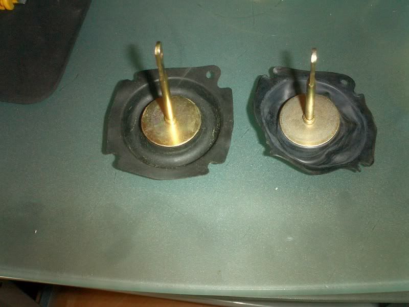

Picked up a new diaphragm and compared it to the original.
Looks pretty sick..i noticed where the spring sits that its been sitting to one side,would this cause the secondaries to bind a little causing the diaphragm to twist the way it has done.;D
Dave

« Reply #13 on: August 04, 2008, 03:09:59 pm »
No the pooling stopped after i fitted the new diaphragm oddly enough,could the powervalve still blow out even with the blow out protection.

« Reply #14 on: August 04, 2008, 03:37:24 pm »
well, how old is the holley? the diaphragm may have gotten old and torn without being blown out. It might also have a opening point that's too high for your engine ( I doubt that).
