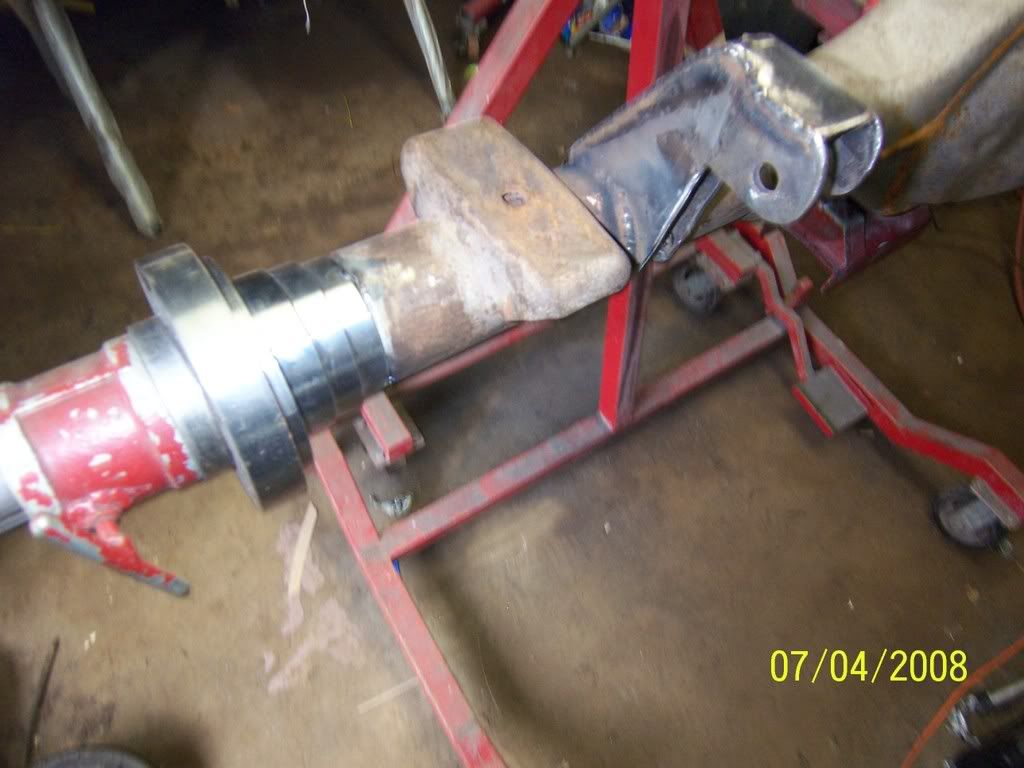

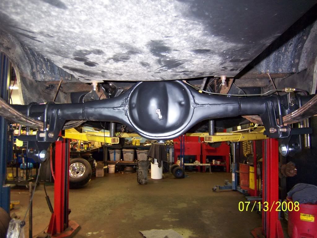

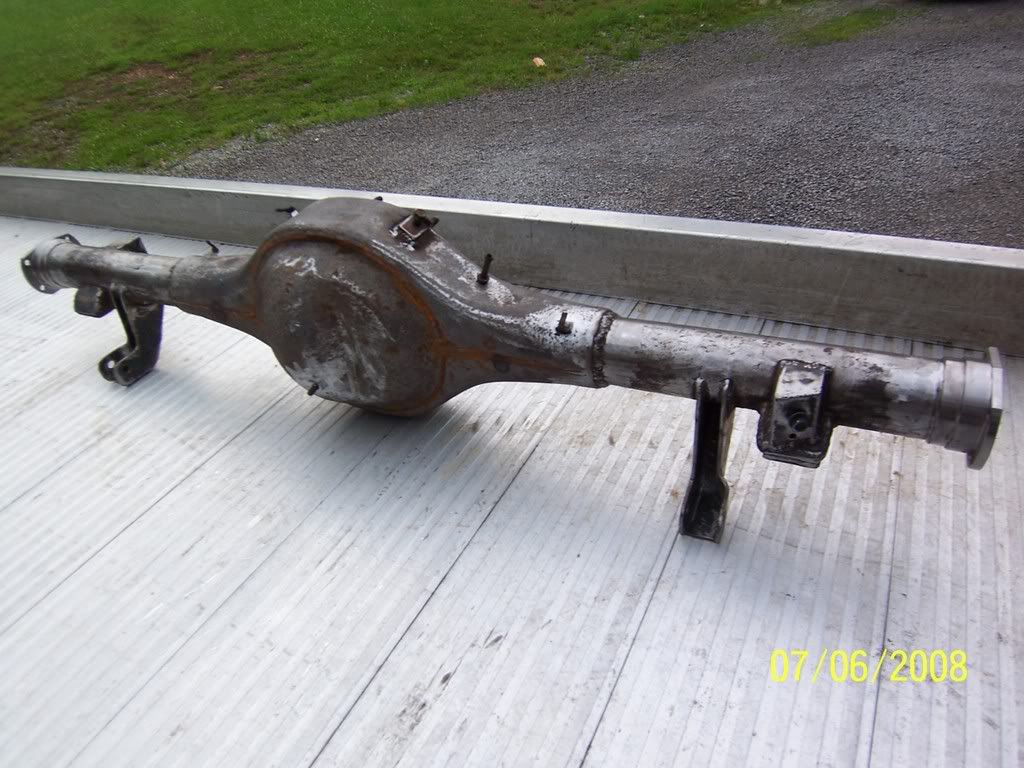

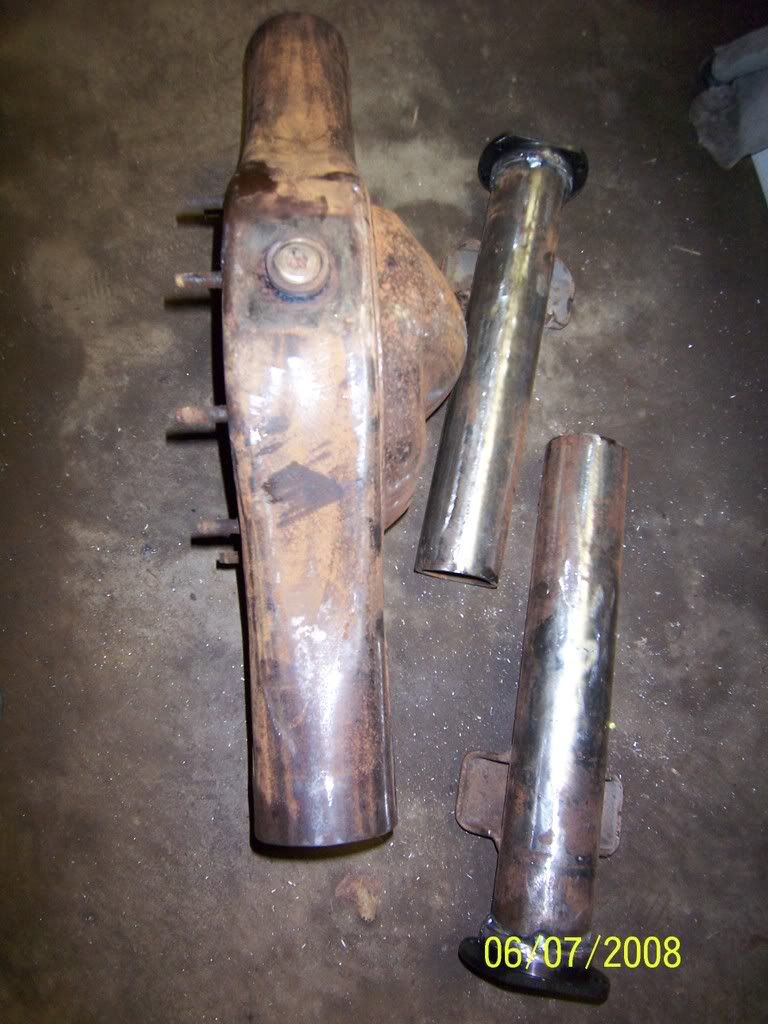

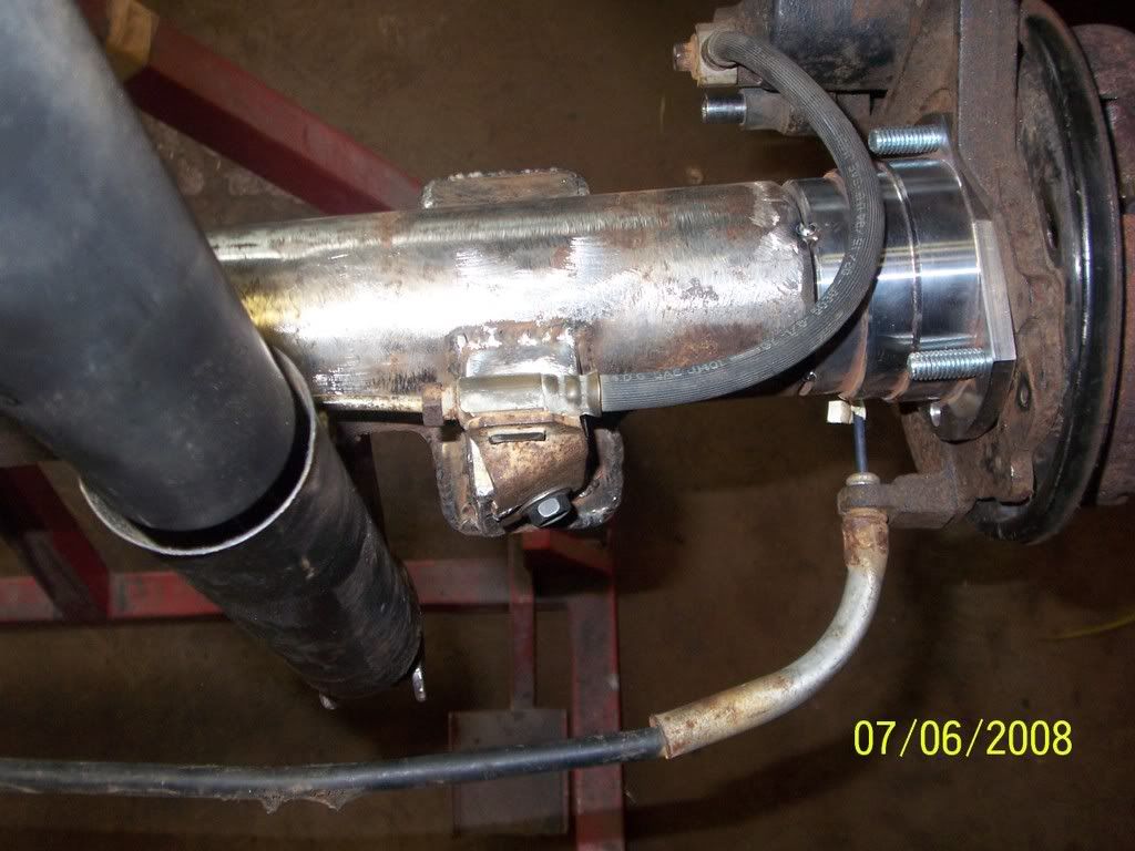

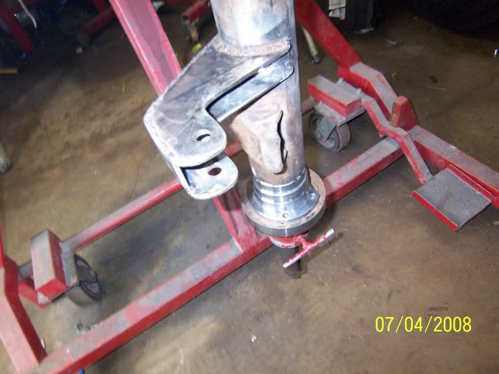

I had mentioned a while back that I was preparing for a 9" swap. Here are some photos as it went along. I built a jig to narrow 9" housings many years ago. On this one I used a 9" housing center, the GM truck axle tubes (so the U-bolts, plates ect. would be the stock size) turned upsidedown & Ford axle bearing ends. The center section is a 31 spline 3.70 gear for now (I may try a 3.89 later). The brakes are Crown Vic discs.

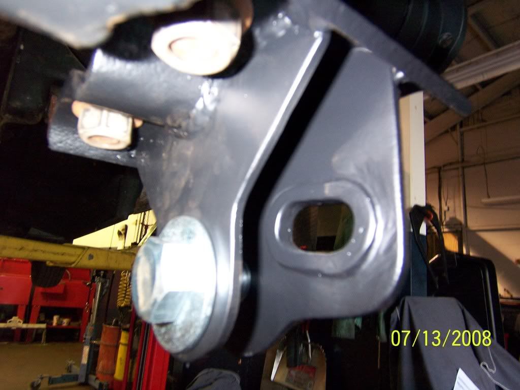

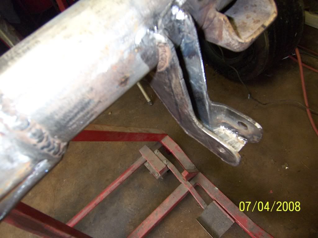

A couple shots of the homemade shock brackets:
I'm using Rancho RS9000 9 position shocks (mounted vertically)

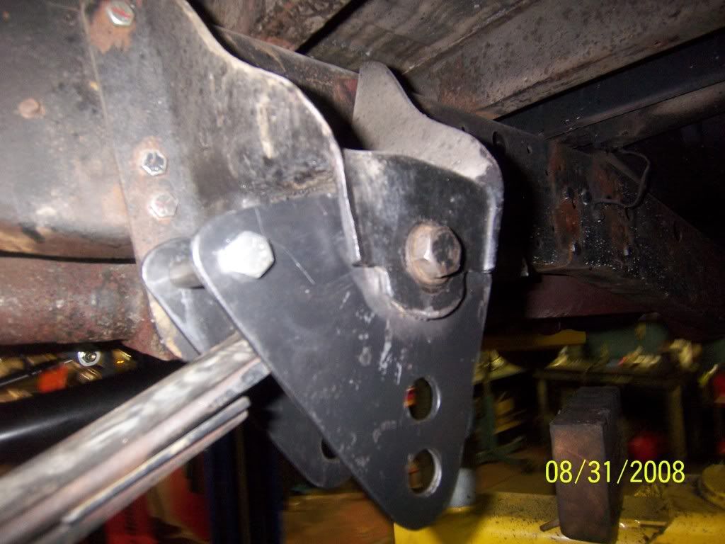

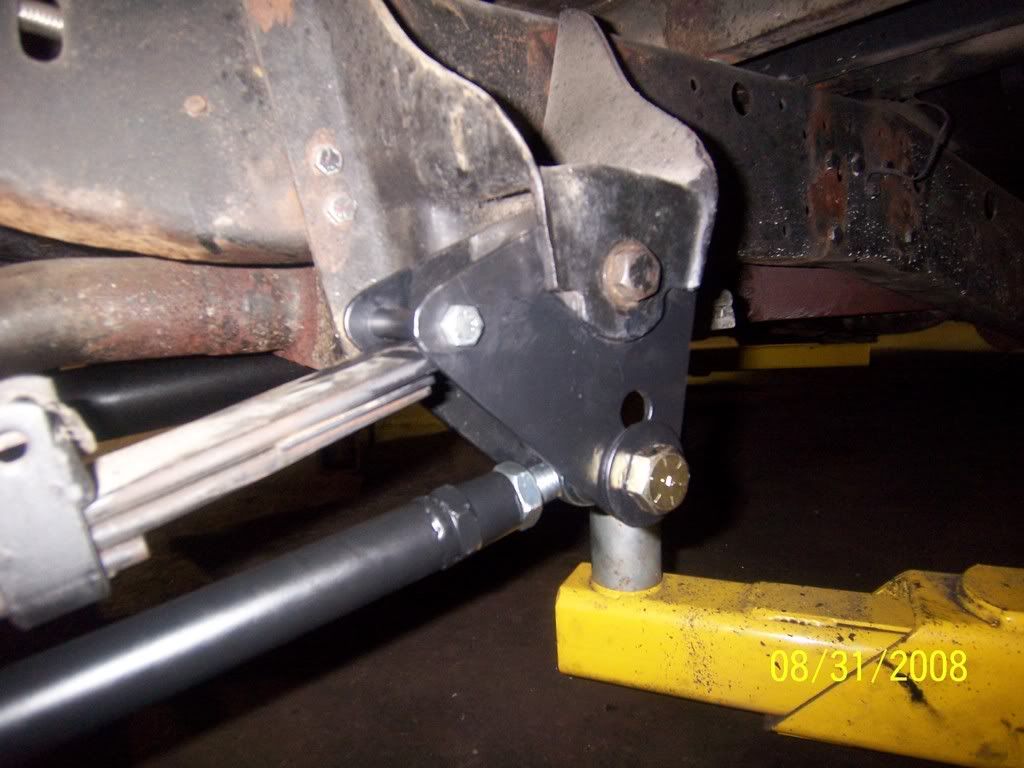

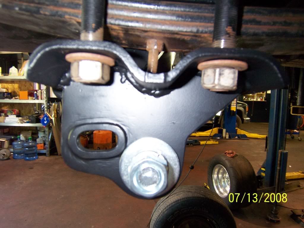

While the lower U-bolt brackets were off, I made some "Cal-trac copy" traction bar mounts with a tie-down incorporated.
The rearend was installed on top of the springs & the rear hanger/shackle were turned over
Please excuse the "ratty" looking undercarrage, this is a stress relief, play toy, definitely not a show vehicle. The outcome is, I got it done just in time to test it at Norwalk Raceway this past weekend. It works GREAT! I'll post some more photos from the race when I get a chance. Lorne

Thanks for the complements guys! Some days that's what a guy needs to forge ahead. Chop, I started doing the "original tubes" on Mavericks & such, the 8" uses the same (if using 28 spline) axles, bearings, ect. as the 9". The problem with them is a posi for an 8" is nearly like hen's teeth & the gear selection isn't as good as the 9". What I would do is really just change the housing center, then came Camaro's & even a couple Vega's (the older ones have all 4 mounting arms on the tubes). Stewart, What have I done to my truck that disappoints you? Changing it from the stock? The Ford rear end? Each of us enjoy working on & personalizing our trucks or we would not do it or be on this site sharing ideas, ect.  I realize the Ford rear may not be for the die-hard GM guy, but it has some advantages.... Changing gears in an hour, if you break a carrier strap the housing isn't ruined, close gear spacing (3.70,3.89.4.11) the bolt-in axles, ect. I thought other parts (the shock mounting, rear hanger flip, ect.) may be of interest to some. I could see if I had chopped the frame off, put the biggest tires I could buy & leave the stock 305 that would not serve much purpose. After all, hotrodding in it's base form started by guys adapting more powerful, stronger, different parts to a vehicle they have to accomplish whatever it is they are after (looks,performance, ect.) I have mentioned before, I've got allot of auto hobby interests & am a well rounded hotrod guy... the truck being it started out life as a GMC is just part of it. Try to tell the streetrod guys that they can only use a Mustang II front if it's going under a Ford. My truck is a good, sound working piece that is used daily all summer, it suits our needs & desires. Most importantly...gives the wife & I quality time doing something we both like. Lorne

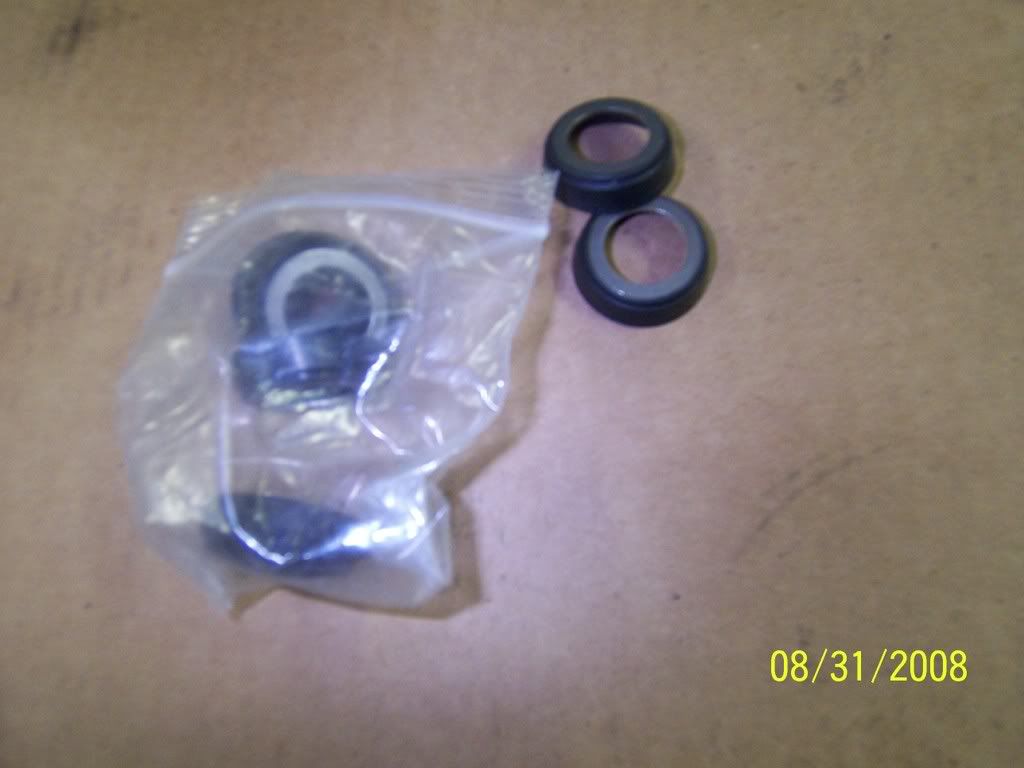

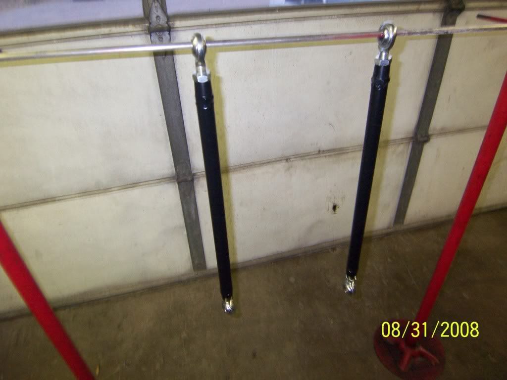

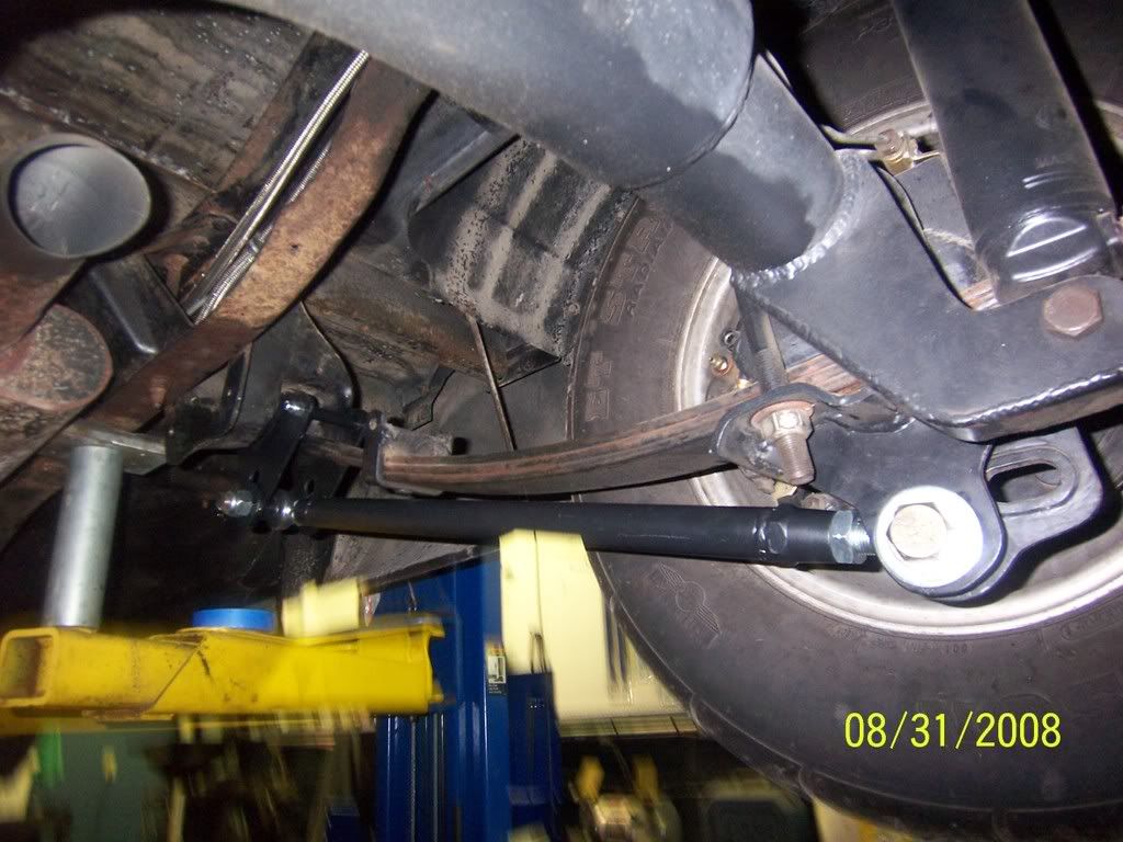

Over the weekend I found time to make & install my traction bars. They are designed after ones that John Calvert gets credit for the original plan. Out of respect to John & Chris who sells Cal-trac bars, I have no intentions to do a step-by-step or discuss diamentions, ect. Besides, I didn't find a set, measure & copy them, so who knows...maybe mine don't work as good either. More or less a little encouagement for the do-it yourselfer. On a side note... I got these little rubber boots for the rod ends, Seals-it I think was the company, they are pretty slick. I stuck a needle tip grease gun along the edge & filled them up. Should work well to keep the grease in & the dirt & water out. Now back to the track next weekend to try them out. Lorne
