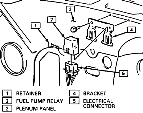

where the heck is the fuel pump relay located?
Re: Tank Selector Switch Problem??? Won't Start
« Reply #7 on: August 06, 2008, 08:22:46 pm »
In the engine compartment. Slow down there cheif. Stop changing parts and unplugging things and bypassing this and that. There's a simple systematic approach you can take to diagnose it. There is a test lead right next to the fuel pump relay. Jumpering B+ to the test lead will energize your fuel pump. You can do this to determine if it's the control side of the circuit or the load side of the circuit that's causing your problem if in fact no fuel pressure is even your problem to begin with.
« Reply #8 on: August 06, 2008, 08:25:12 pm »
Here's a pic of the relay for you. It's on the passenger side
