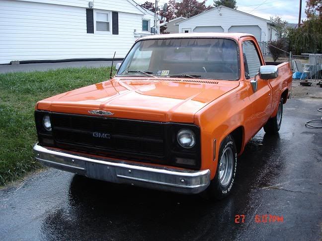

Thanks man.  It has round headlights now but what year grills would I be able to bolt right up without having to change the hood latch or anything else?  I've tried to find out on my own with GOOGLE, the search button, etc. but haven't really found a spot on answer.  Here is a pic of the front of the truck and yes the "hood ornament" is coming off asap also.

well from seeing the front a little better now it looks nice but i what year grille are you wanting to use?

I'm thinking maybe a '77 Chevrolet grill and headlight bezels.  I don't really like how the headlight bezels on the '79-'80 trucks surround the marker light also.  Thats really the biggest thing that bothers me about this grill, other than it having a very poor rattle can black paint job.  I'd love to run a complete '73 grill, but don't want to go through changing alot of stuff if its costly or a pain in the rear.
