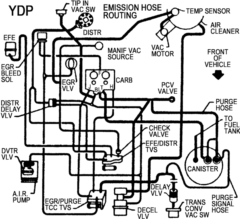

HEY GUYS IM NEW HERE, I HAVE A 86 CHEVY C10 305 4BLL, I AM IN AZ SO I DO HAVE TO HAVE EMMISSIONS DONE, BUT I REG UNDER MY DADS ADRESS IN PINE TOP SO I DONT HAVE TO GO THROUGH EMM...I HAVE ALOT OF VAC LINES PLUGED AND NOT RUN, WHICH IS FINE IF NO EMM, BUT WHERE DOES THE EGR PLUG INTO THATS CAPPED OFF, AND IF ANYBODY HAS THIS ENGINE WITH ALL THERE LINES RAN OFF THE CARB, I WOULD LIKE TO SEE PICS.....THANK YOU

Well i have most of the lines hooked up, but there are a few off the carb that are capped, dont know where they go, i do need to know where the egr plugs into though, i do have a few plugs in front of the motor that have 4 vac lines coming off and another next to it that has i think 2 or 3 all capped off as well

« Reply #3 on: November 03, 2008, 08:35:15 pm »
actually theres a bit of difference between 79 and 86 vaccuum lines. Here try this:

« Reply #4 on: November 03, 2008, 11:05:32 pm »
I ALREADY HAVE A VAC DIAGRAM, I REALLY NEED TO KNOW WHERE THE EGR VAC PLUGS INTO, THATS THE ONLY THING I DO NOT HAVE RAN, RIGHT NOW ITS CAPPED OFF.....

« Reply #5 on: November 04, 2008, 05:10:05 am »
If you have the diagram then just run the hose according to the diagram. The EGR should have a solenoid and a thermostatic vacuum switching valve connected to a ported vacuum source.
