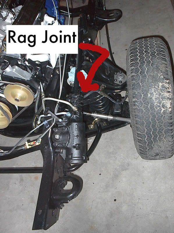

Check the rag-joint, too.

OK.... thanks czz145a.....  but that is the rag joint???

The rag joint is the flexible joint where the steering column linkage connects to the end of the steering box.
