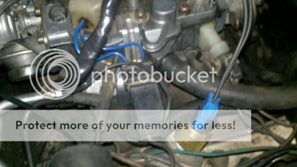

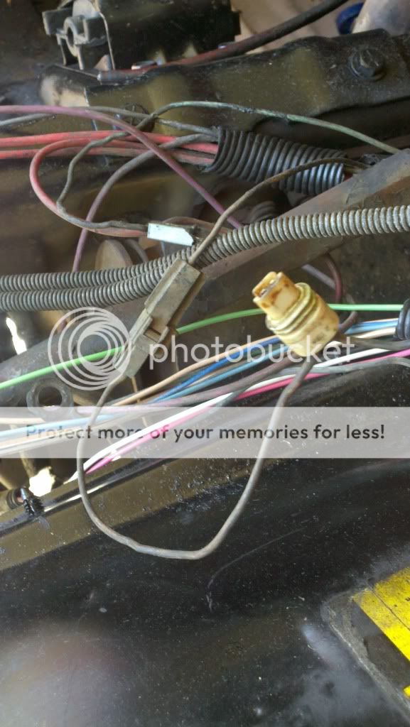

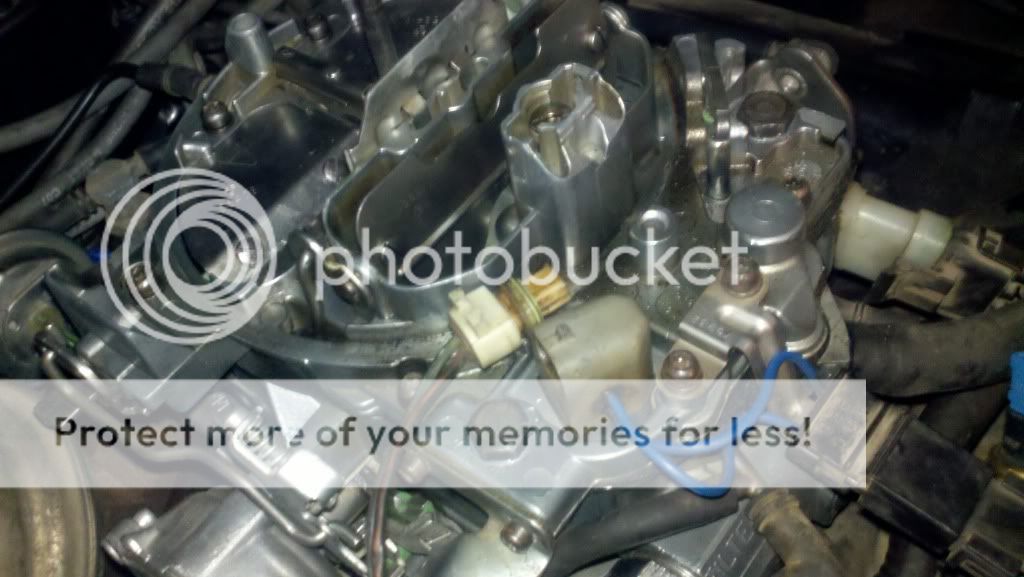

been looking at the wires from the solenoid connector and found out that right where the plastic wire cover were ,the wires were like with no insulation,it almost looks like thats how it suppost to be,they both at the same lenght and theres also a 3 wire that it also connects to the solenoid but from the blue connector side... anyone has this type of carb or wiring like mine?
the 3 pic its the wiring of my brother truck, he got a 1986 chevy custom deluxe,hes carb. dont have that blue extra wires coming from the mixture control solenoid like mine...

The plug in the q-jet is the dual capacity accelerator pumps, it is activated by the CTS in the thremostat.  If the CTS is bad or unhooked it will be dumping fuel all the time.
http://forum.73-87chevytrucks.com/smforum/index.php?topic=10151.0

i have a new cooling thermostat sensor n new wire to it cuz the connector was broken...
