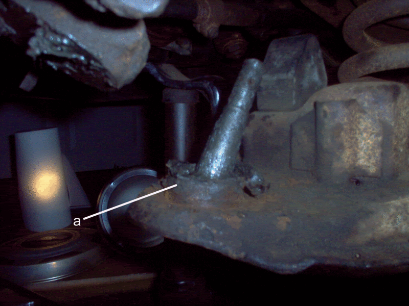

Please view the following document:
Is fig.a part of the control arm or is it part of the actual ball joint?
This is an 83 c-10 2WD.
Edited by: Stewart G Griffin at: 9/10/06 2:22 pm

Its part of the balljoint. If you look at your new one,you will see it.
