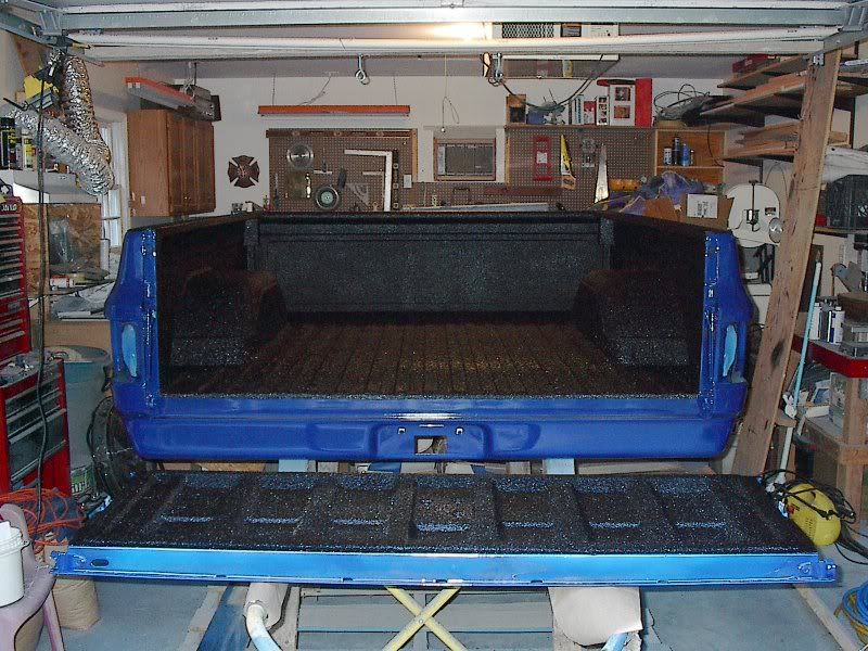

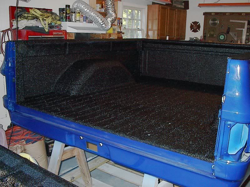

Just finished my bedliner.  I used this off ebay - two part mixture with added rubber.  Worked VERY well!!  I would definately recommend.  Very messy job though.
http://cgi.ebay.com/ebaymotors/SPRAY-IN-on-BEDLINER-KIT-BED-LINER-GUN-PURE-WHITE_W0QQcmdZViewItemQQ_trkparmsZ72Q3a1205Q7c39Q3a1Q7c66Q3a2Q7c65Q3a12Q7c240Q3a1318QQ_trksidZp3286Q2ec0Q2em14QQhashZitem180290526974QQitemZ180290526974
Here is my bed:
What do you think?
Jeff
86 Chevy C-10
350, TH400

« Reply #1 on: September 19, 2008, 05:01:08 pm »
Looks awesome!

« Reply #2 on: September 19, 2008, 05:16:20 pm »
A most excellent job!

« Reply #3 on: September 19, 2008, 06:40:36 pm »
Cant see it to well want to come up north and do mine so I can see it better ??
Looks a lot better than what I did :( I used Herculiner on the frame..

« Reply #4 on: September 19, 2008, 07:48:35 pm »
That looks Good!

« Reply #5 on: September 19, 2008, 10:03:57 pm »
looks great! thats what i want to do to my mine.

« Reply #6 on: September 19, 2008, 10:46:58 pm »
i have been waiting for this great job JJSZABO lol

« Reply #7 on: September 19, 2008, 11:14:09 pm »
Looks great. I've been wanting to try that myself.

« Reply #8 on: September 20, 2008, 06:29:27 pm »
Thanks guys - the bed goes on the truck tomorrow.

« Reply #9 on: September 21, 2008, 05:45:51 pm »
looks better than the $350 line x I had done.....

« Reply #10 on: September 22, 2008, 08:33:02 am »
WOW - thank you
