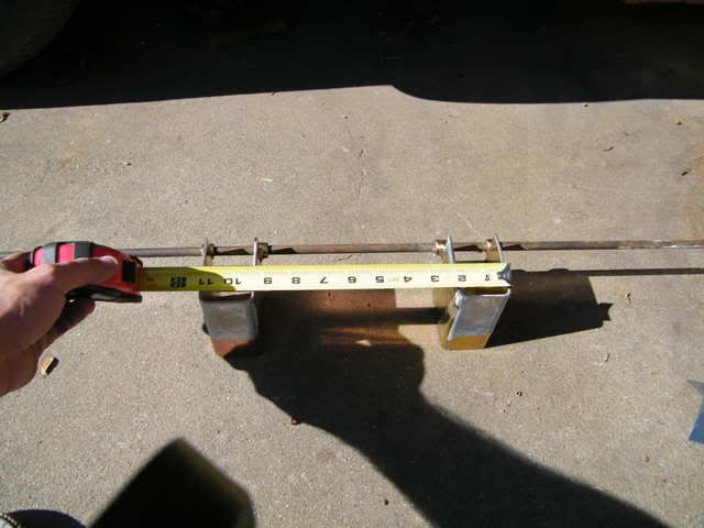

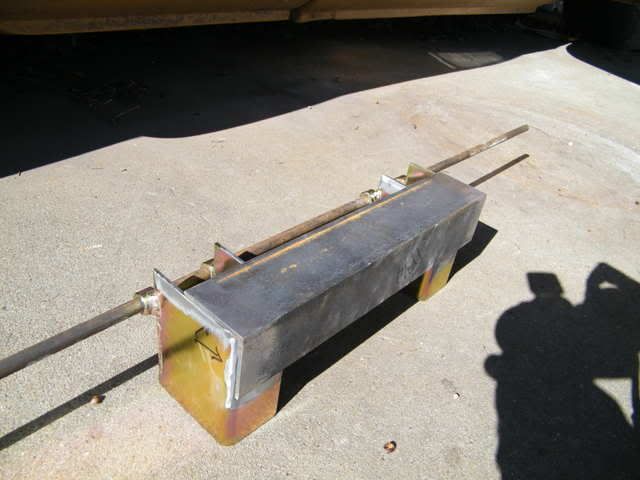

Not complete yet but here is a start
First I dissasembled the hinges and ran a piece of 3/8" rod through the hinges. I had determined the maximum spacing I could get in the door jamb was 11 1/4".
I cut a piece of 2x2 angle iron to 11 1/4 and welded it to the back side of the hinges.

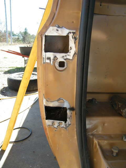

Next I located the hinges in the jamb and clamped them in place so I could mark the holes.

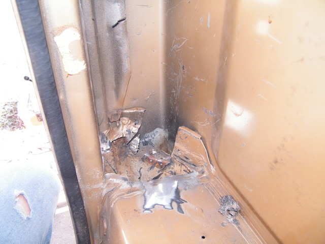

My bottom hinge was low enough that it interfered with the step in front of the back wall so that had to be cut out as well. Not easy with the tools I have so it is ugly. You could mount your bottom hinge higher and avoid this but the further apart the hingers are the more stable they will be.

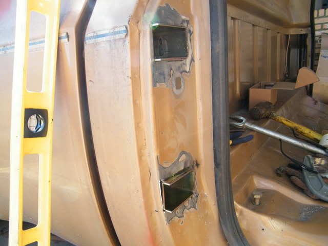

Once I cut out enough room inside I slid the whole assembly into place.
Make sure everything is square and trim off the excess hinge and tack it into place.
If you are confident everything is square you can go ahead and weld the hinge in at this point like I did or wait till you finish the door as well.
Tomorrow I plan to have the passenger door finished so look for more in a few days.

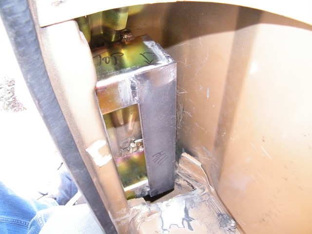

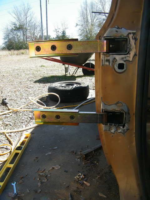

I put the door latch back to keep the door shut while I welded in the bottom hinge. The door latch is where the top hinge goes so I had to do the bottom and then remove the latch to do the top hinge.

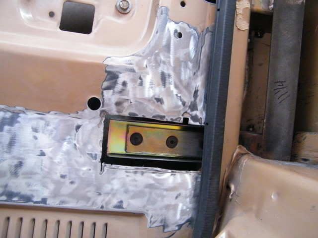

The hinges sit deep in the door so I had to make some brackets.
Once I cut out the louvers there where some big holes in the end of the door that needed to be filled as well so I made another bracket.
