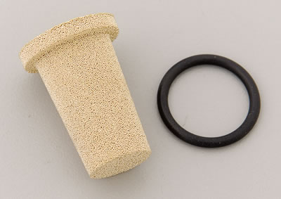

I searched the web and I only found a few articles/threads mentioning them. But they were conflicting. I have 2 filters in my system - one before the electric fuel pump, and one between the carb and regulator. Last time I took my carb apart, I found crap in it. The stuff looked like that pepper you get from Pizza Hut or Dominoes. I'm not sure where it came from though. All my lines are either braided or aluminum, and I run a fuel cell(with foam). Anyway, when I put the carb back together I threw in those little filters that go in the fuel inlets. Was that a bad move? Will they be a big restriction in my system? Is it possible that the crap I found in the carb actually came from inside the carb?

Are you talking about the sock filter on the inlet? Its not a bad thing to have but they do periodically plug up with junk. the nice thing about them is they can catch a potential piece of crap from getting into the float chamber.

They are the little metallic cylinders that go in the fuel inlet. I think I've heard them called cintered filters...I think.

like this?
http://store.summitracing.com/partdetail.asp?autofilter=1&part=EAR%2D230107ERL&N=700+115&autoview=sku

Yes, something like that.

Team, Those have a rep. of being restrictive, I've never personally used or tested them to verify. The "pepper" sounds like the rubber from inside the braided hose. Did you cut it with a abrasive wheel? It's a good idea to run a coffee can full or so of fuel through the lines before hooking up to the carb. anytime you install a new hose. Lorne
