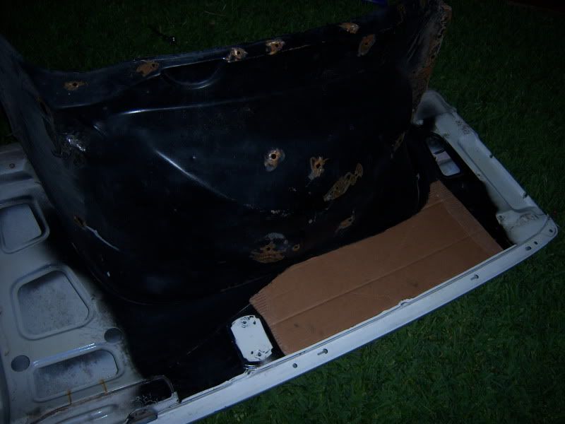

My painter/ body man came over and got the  fire wall piece glued on today in a couple days he  will tach weld the outer  edges

« Reply #202 on: June 17, 2011, 11:47:14 pm »
