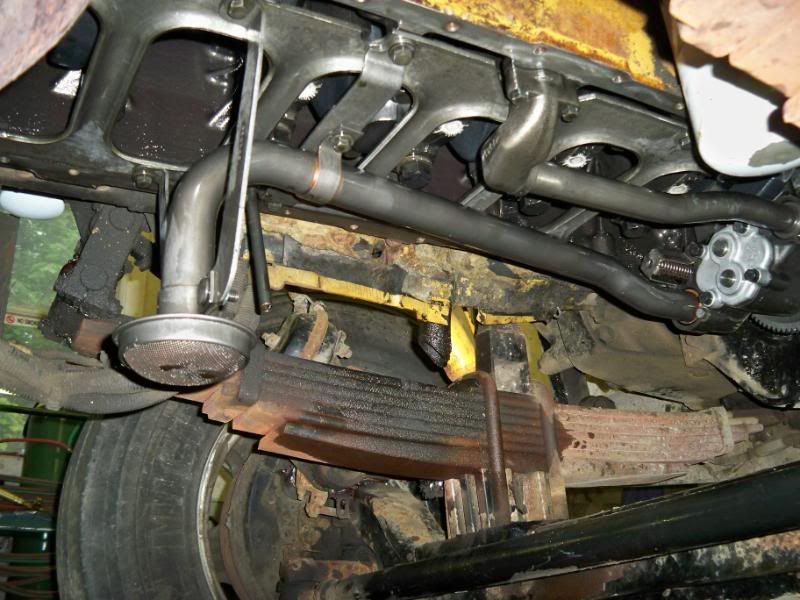

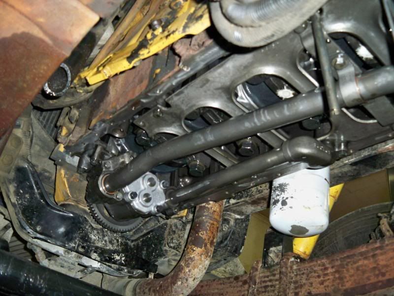

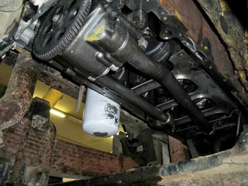

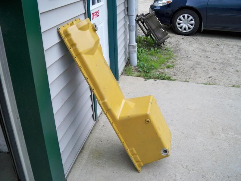

What I did Friday.
Pete 359, 475 Cat.
Oil pan had a crack in the rear right corner up near the mount flange. Had it tigged, and I painted it.
New pan is $1,400.00  :o :o
That was easier to get off then a small block pan on a 4x4!

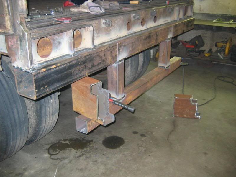

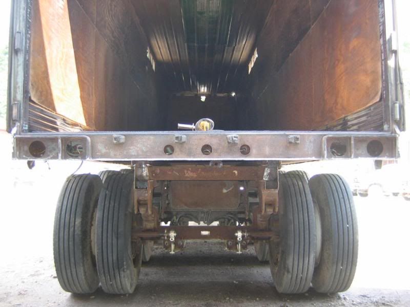

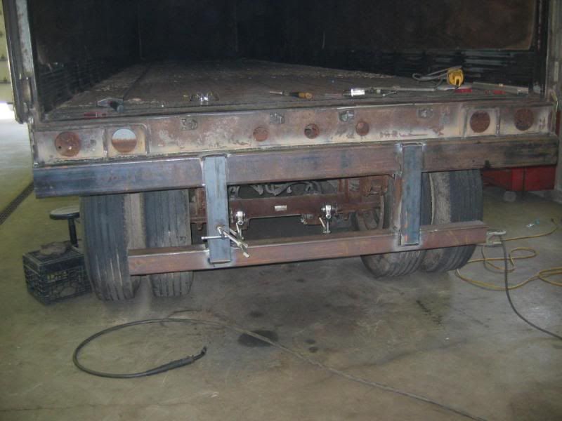

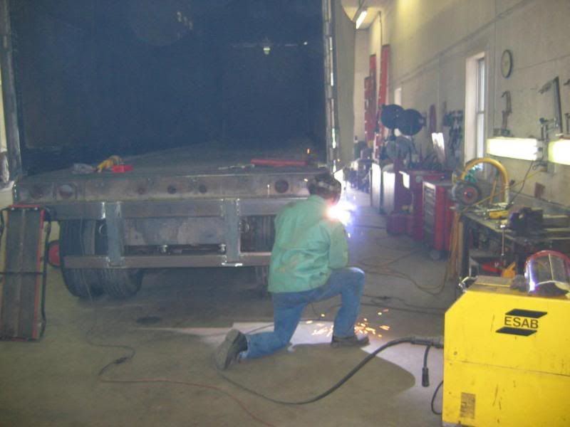

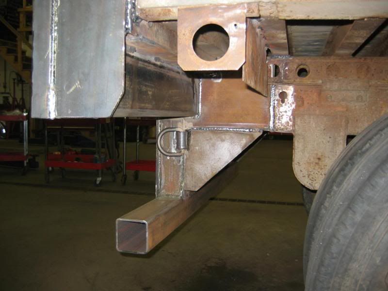

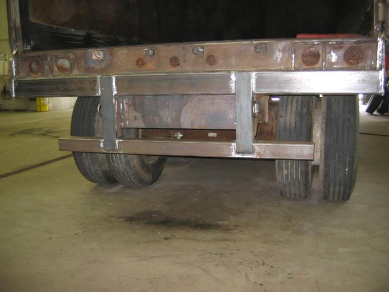

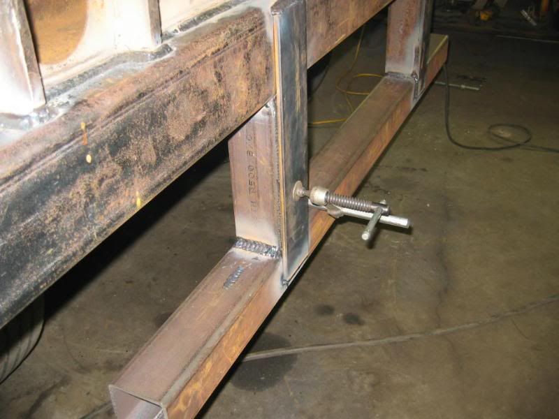

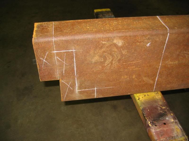

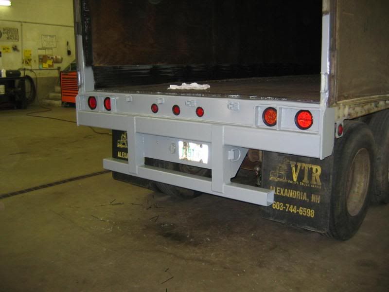

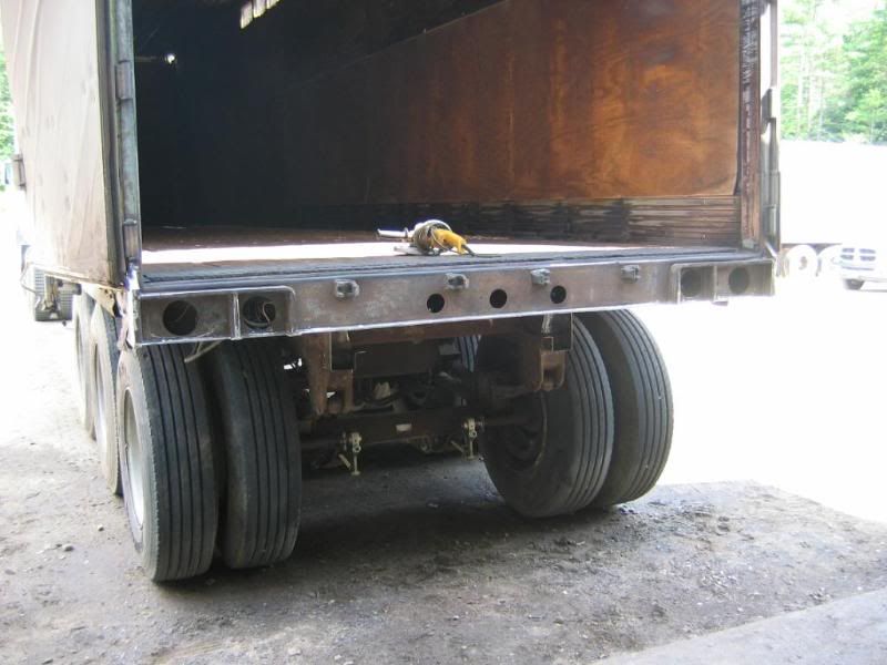

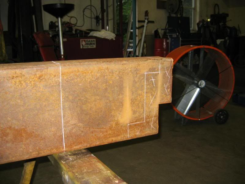

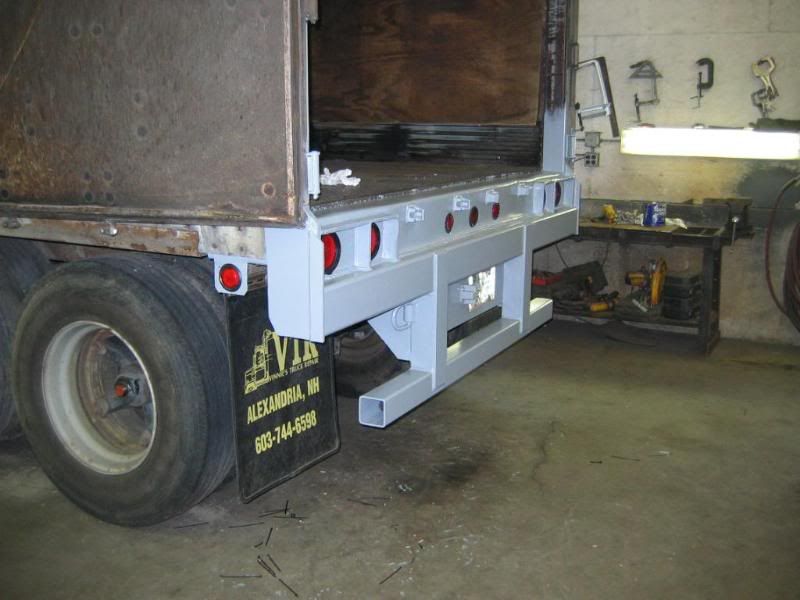

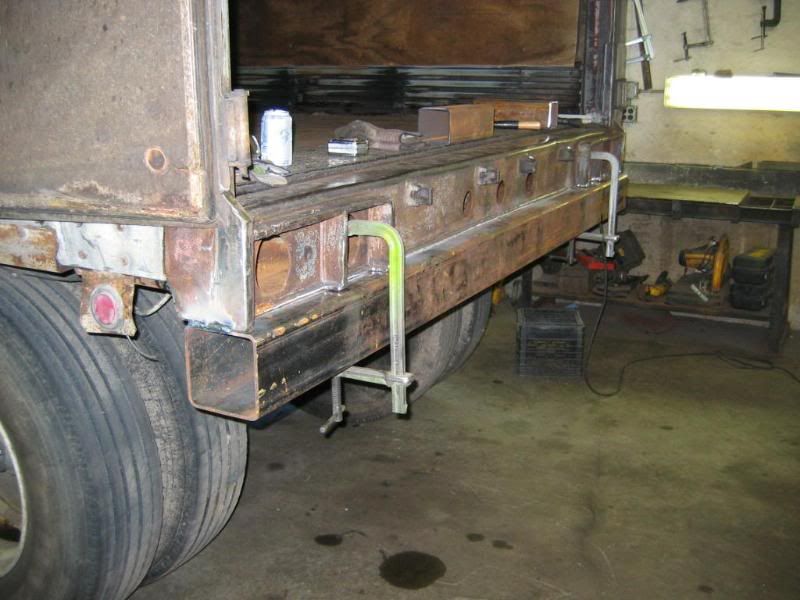

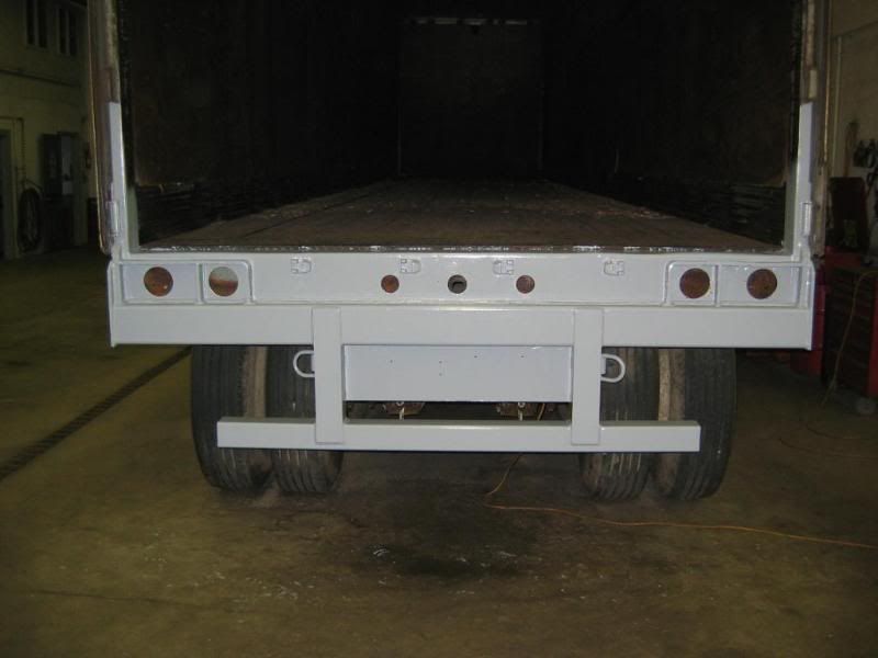

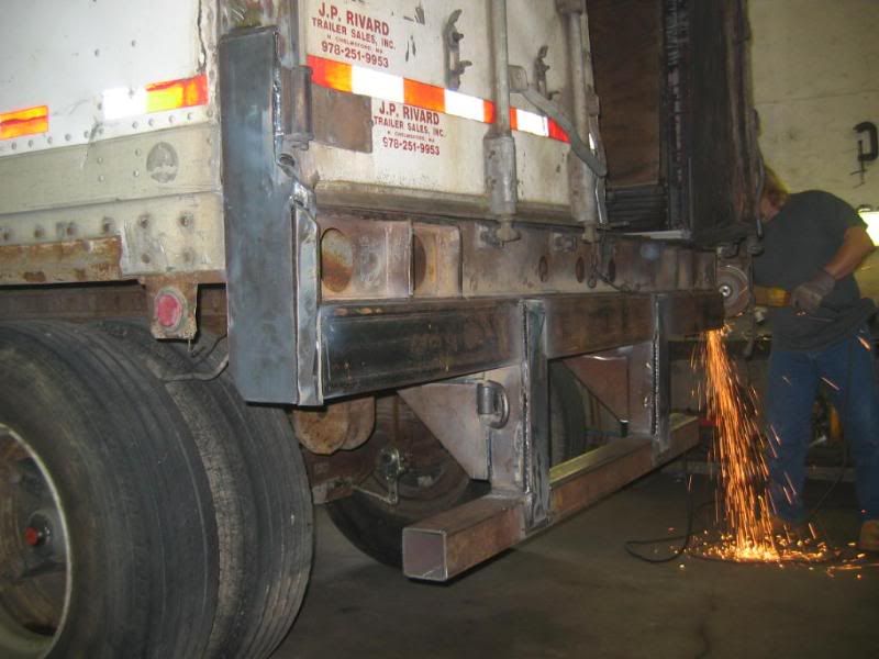

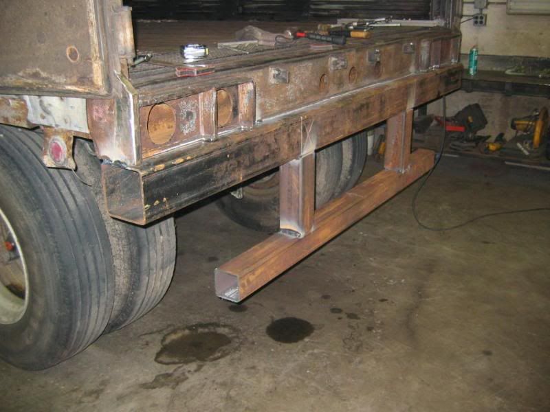

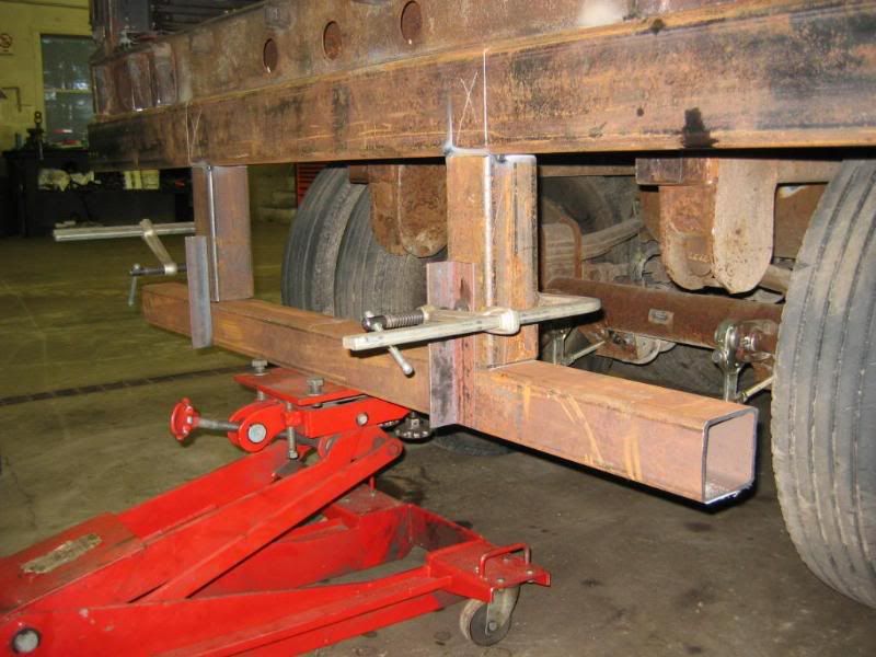

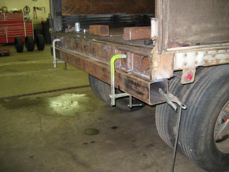

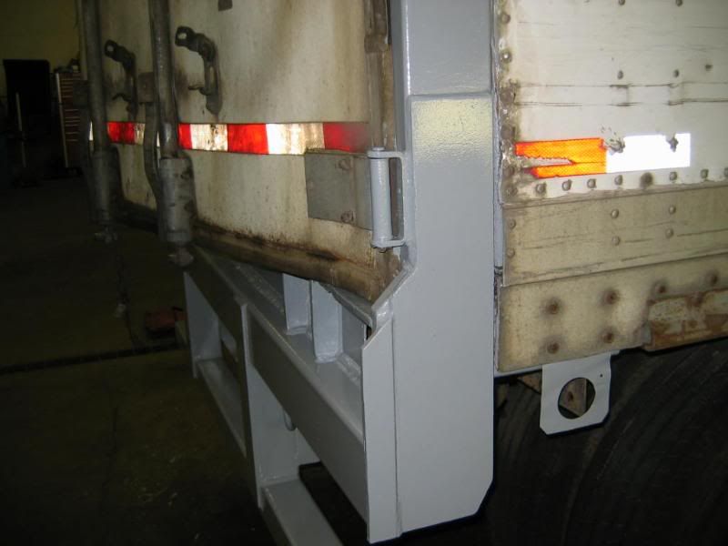

Work couple days last week!

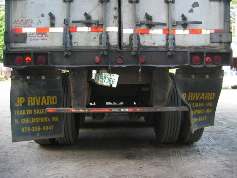

Before!

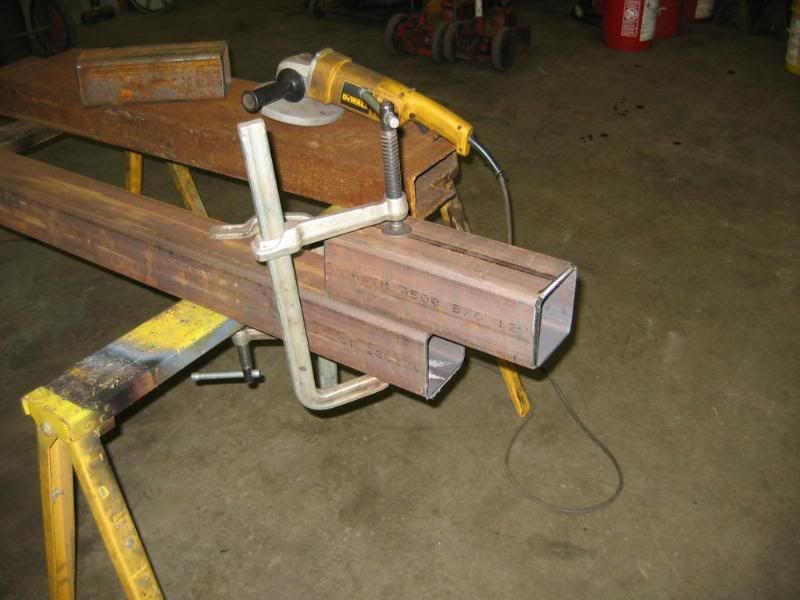

Grinding away!
Let the boss have a little fun too!

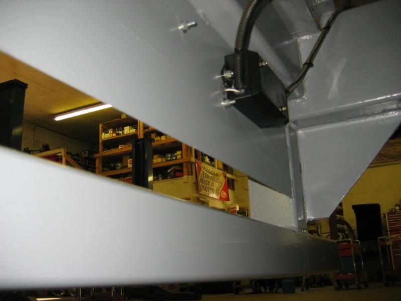

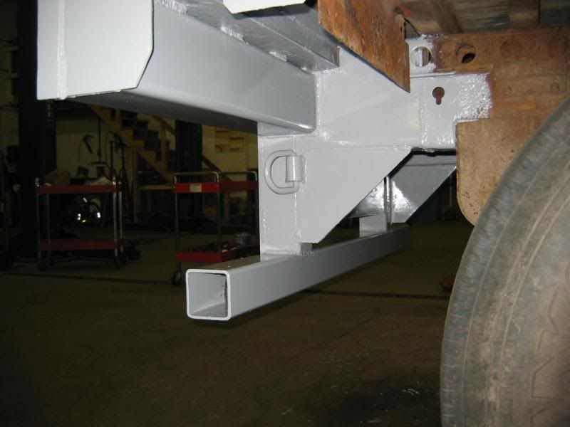

After!
« Last Edit: August 18, 2009, 08:57:09 pm by Blazin »

Your getting pretty good at those. ;D
Re: Pics of work.
« Reply #50 on: August 18, 2009, 09:01:37 pm »
Talked to the skidder operator. He said he tried to wreck the last one I built!

Dang, what are they doing??? That looks about as tough as an anvil.
Re: Pics of work.
« Reply #52 on: August 19, 2009, 09:54:38 pm »
The trailer gets loaded with 100,000 120,000 lbs of wood chips. Most times the landings are soft or muddy. In order for the tractor get moving the skidder pushes him. If you look in the before pics you will see the bumper is all bent up. been pulled back out a dozen times, and had hackpro braces welded to them etc. The original bumpers are only tied into the box, and rear door opening of the trailers. they are stamped steel about an 1/8" thick! I fill in the gap between the suspension frame, and new bumper.
Some of these guys could break the horn off an anvil with a rubber mallet!  ::)

Very nice work!

I would love some tuff rough bumpers like that in my truck.  ;D
Never give up.
Re: Pics of work.
« Reply #56 on: August 20, 2009, 08:00:43 pm »
By the way that is Chassis Saver, with a caot of SEM acrylic enamel with activator in it. Brushed, and rolled on!
