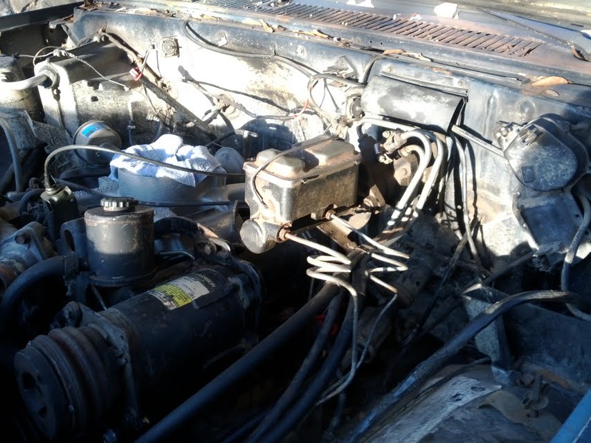

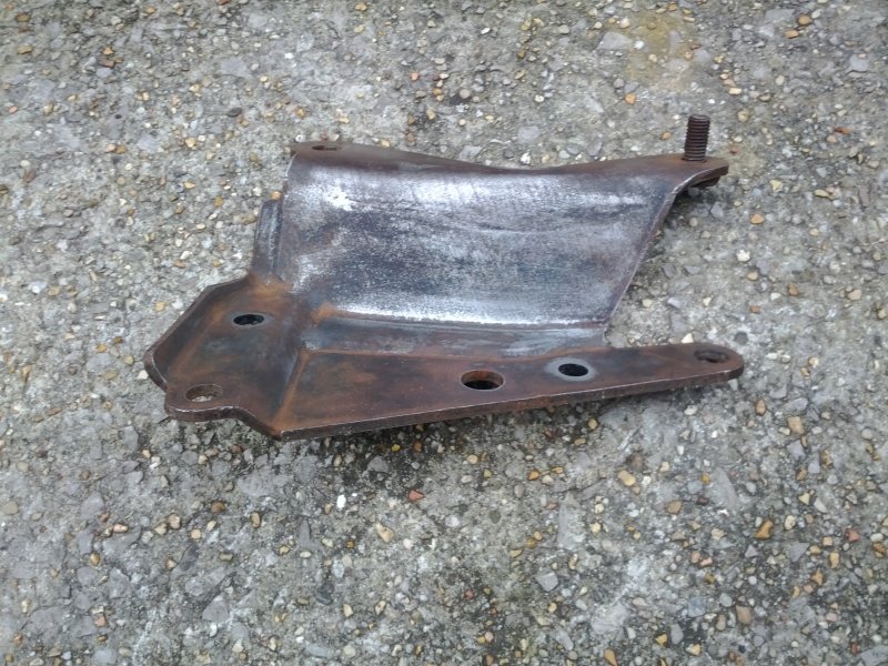

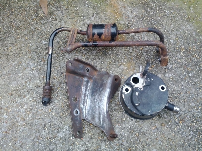

Friday, Feb 3rd, 2012 The AC related parts finally showed up from Diesel Depot, thought I was going to get a lot better of a manifold for the pump, that would fit, but oh well...
Cleaned up the bracket and painted it to keep it from rusting
Installed the remote fill Reservior on the Pump (18mm, flat screwdriver), put the new AC bracket on and installed the Power steering setup.  The proceeded to put the old AC compressor on the truck.   Still need to get studs for the lower mount that goes in the manifold but I have the potential to have AC now.  (15mm, 13mm)
Still need to get a remote hose and finish putting the hydroboost in, but it is nice making some progress again...

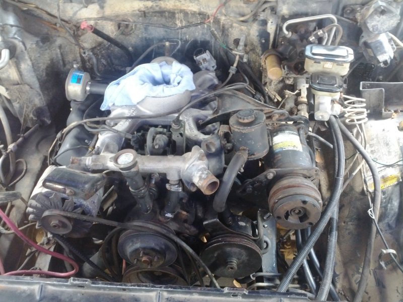

« Reply #68 on: March 21, 2012, 11:55:21 am »
Saturday March 10th, 2012: Got bolts long enough for the lower manifold/AC mount and got the AC compressor mounted finally.  Then proceeded to install the Hydroboost system, got it all hooked up to the pump and the power steering reservoir.

Cris looks good  can't wait to see it all come together
those brackets would be a pain to build and probable as hard to find
« Last Edit: April 01, 2012, 03:27:56 pm by junkman. »
Re: 1985 K5 Blazer: Added another one to the stable
« Reply #70 on: April 02, 2012, 05:15:10 pm »
Yes they were a pain.  The hardest to find was the TV cable bracket though.
