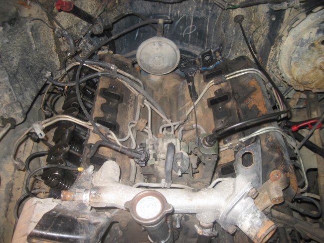

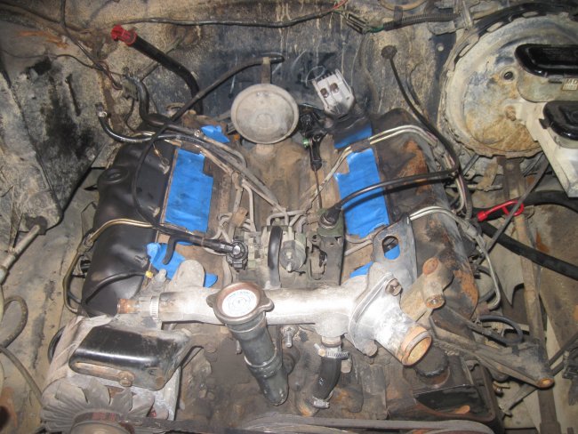

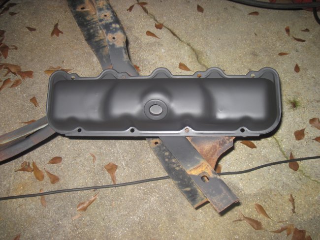

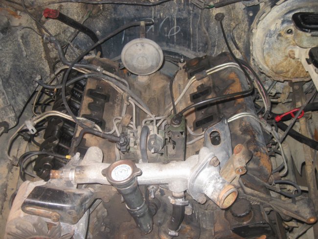

Saturday, Dec 3rd, 2011: After receiving a new open plenum intake, valve cover and fill tube, TV bracket and 85-93 Glow controller, started the disassembly of the topend.  Got the intake and valve cover removed.  Cleaned it up and installed the new TV bracket, glow controller and then put the valve cover on before it got too dark.

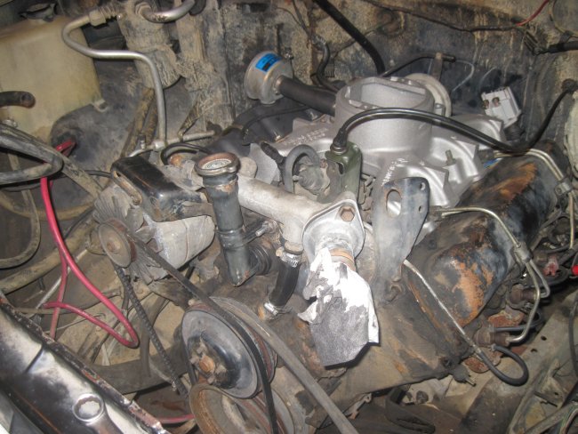

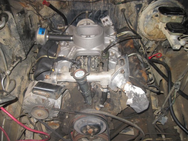

Saturday, Dec 10th, 2011: put the new intake on with associated parts.  Removed the power steering assembly to verify the mounting for the AC pump brackets.  Found they didn't work.  Need to find a remote reservoir for the existing pump to go with the Hydroboost I am installing.
