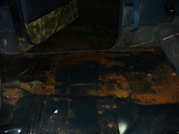

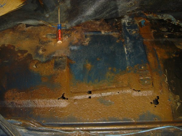

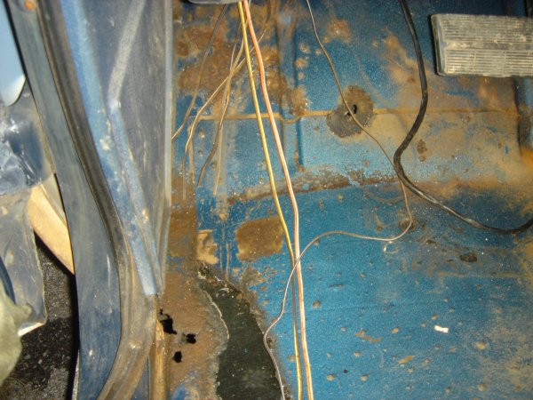

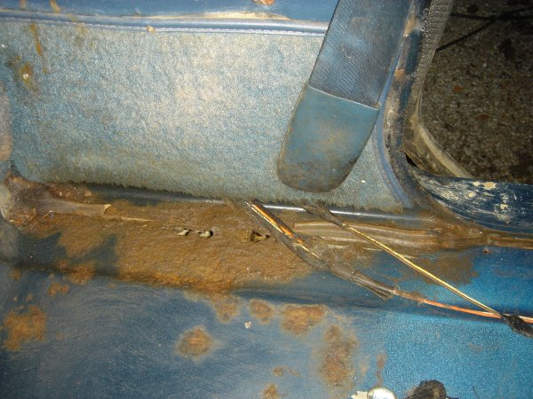

Saturday, March 15th, 2009: pulled the front seats and carpet out to access the rust damage
Saturday, June 6th, 2009: replaced the rear window track rollers, gutted the complete interior to find all the rusted area.  Found out the rear power motor only works going down now....

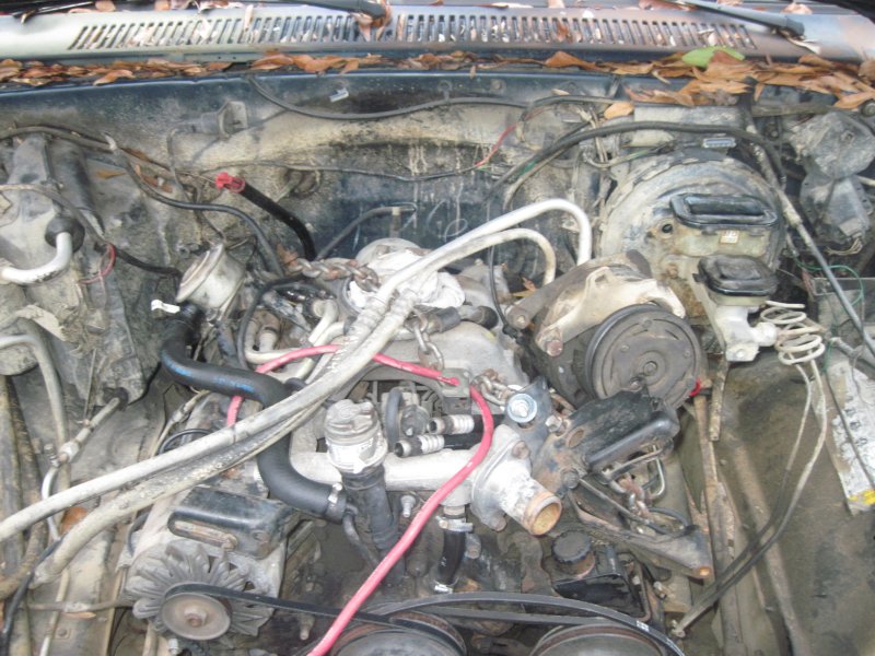

Oct 22, 2011: Sometime in the past I put the starter on but neglected putting the engine bolts on.  So today I pulled the started BACK off and put the bolts in and then put the starter back on.

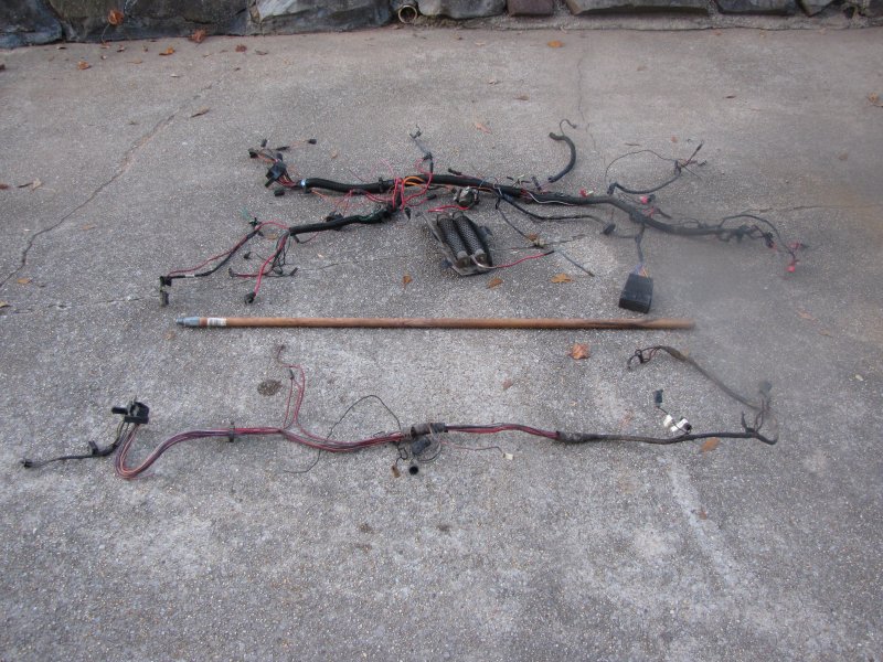

I also pulled the Gasser harness out and I am currently verifying that the CUCV harness I got from the 6.2L donor will work with the the 1985 harness.  I still need to remove the 24V circuits, but hopefully I can make what I have work with little modifications.  So far it looks ok, but I really would like a Civilian harness diagram to compare what I have to.
CUCV on the top above broom handle, Gas below...

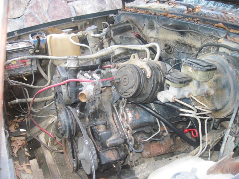

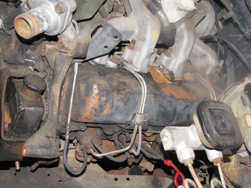

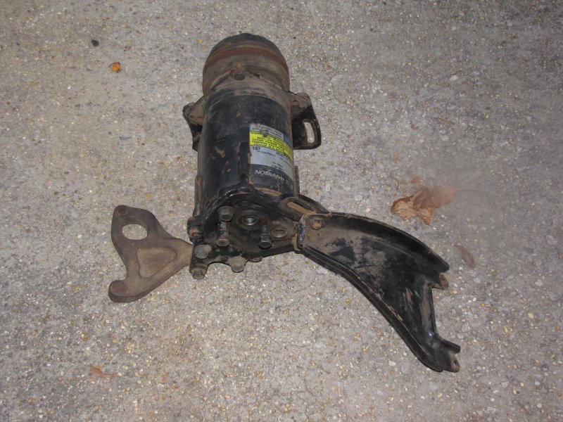

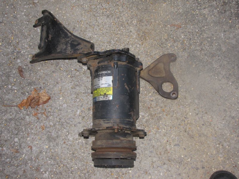

In addition I started figuring out how the AC hooks up.  I found how the Brackets Vile sent work, but it appears I need another bracket that goes to the front of the head as mine has the povision for the second alternator.  Anyone have pics on this?  Vile, do you happen to have the other bracket?
I am confident that the wide bracket bolts to the intake on the 2 studs pictured, and the lower bracket got to the exhaust, but the front I don't have.

I know I posted pix of the bracket set up in another thread for someone. It was a while back. I'll see what I can find.
Re: 1985 K5 Blazer: Added another one to the stable
« Reply #28 on: October 23, 2011, 09:41:23 pm »
can't find it. It was scanned out of one of my manuals....
