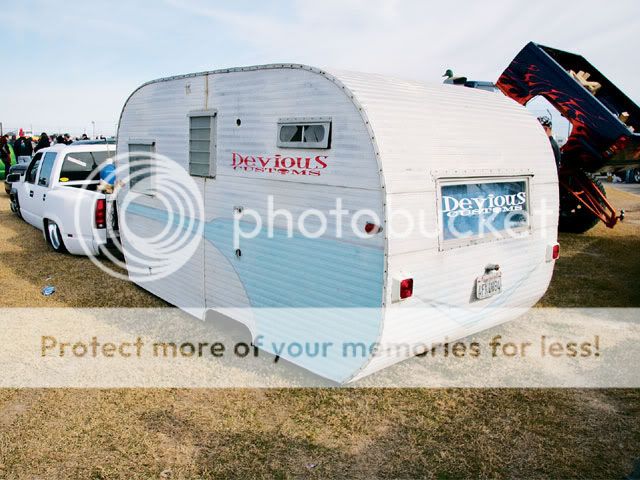

by the way heres is about the size of my camper..I dont have any picts of mine, but very similar to this one just in nicer shape, but this guy body dropped his Dually & his camper..yep the camper too

« Reply #14 on: April 10, 2009, 10:22:36 pm »
It's silly as heck, but for some reason I kind of like that....  :-\
