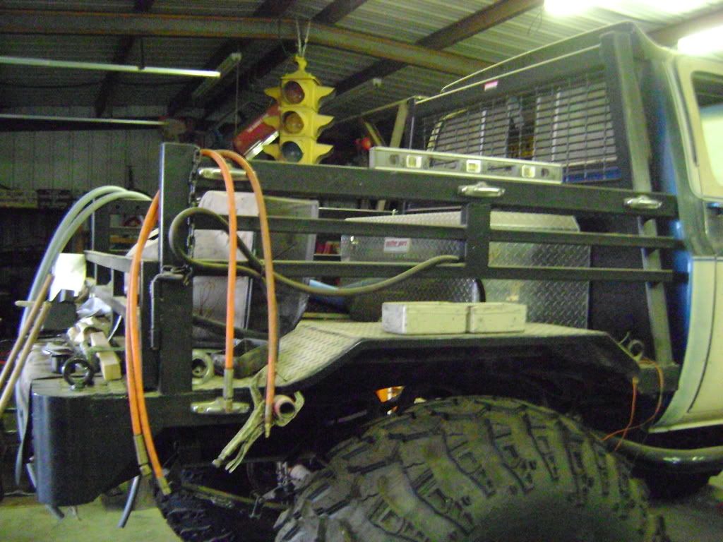

I didnt know what you were talking about at first, but now I do. I have a friend that has built a few. Here is his current project. Sorry for the poor pics

Wholey balls, what are those like 53s he runnin there? I really like the bed that he made. those fenders are nice accents with the diamondplate on top looks sweet. But yes that is what i'm talking about.

Im not sure on the tire size, I forgot. He has a tendency to build everything overkill. It all works well, and will handle alot. The funny thing about this one is that it has all of the best parts in ut for some serious offroading, bigblock(500+hp),built 4l80e ( I think) Dana 70 rear, Dana 60 front the works, but will just be a street queen. He has built, sold, repurchased, and now rebuilding this truck for many years.
