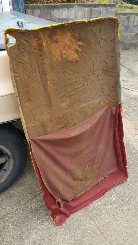

Saturday, March 21st, 2015: Headliner finally gave up and started falling on the truck so this day I removed it.

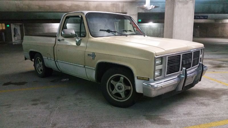

Friday, April 10th, 2015: Random parking deck picture.  Truck is NASTY...  But I do drive it everyday.

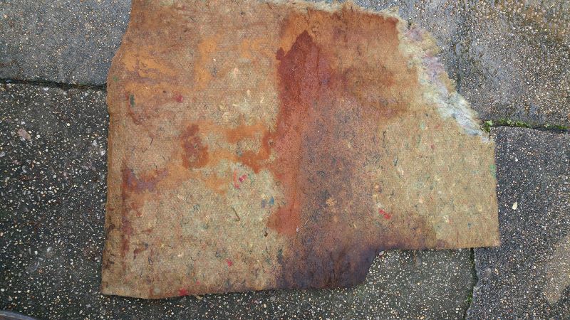

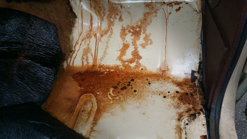

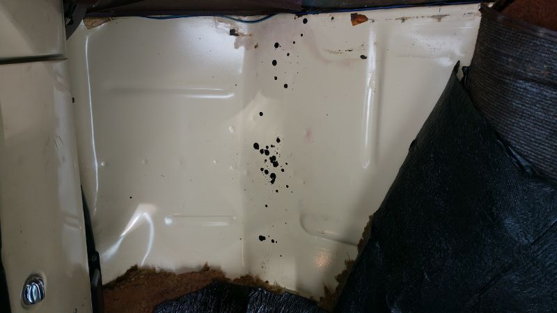

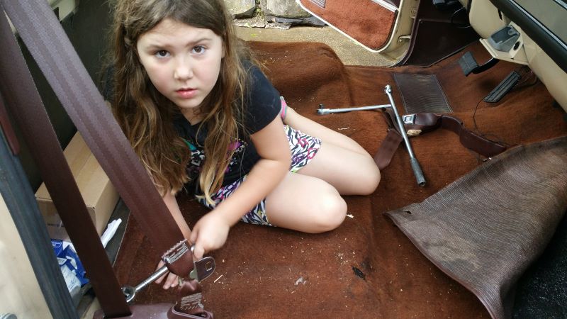

Saturday, April 18th, 2015: Windows were getting really foggy over the past few weeks and I discovered that the heater core I replaced barely a year ago is now leaking in the floor, A LOT!  My daughter wanted to help take bolts out so...
Pulled back the carpet and found this... Again...
This felt in the flooring was pretty bad, so I just cut it off and removed it.
Luckily the floor was easily cleaned back up.

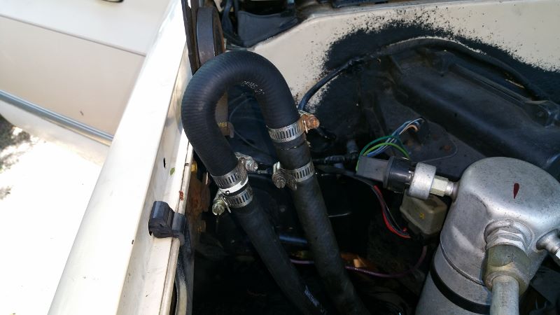

Since it was LS powered I couldn't just cap everything off and the loop I had in the waterpump last time was collapsed, so I had to wait until the the parts store could get me the U hose and I just pulled the existing lines off.

Sunday, April 19th, 2015: The U hose came in and I wasted no time putting it back on.  Since I didn't have AC and I had a leak I left it like this until it got cold.

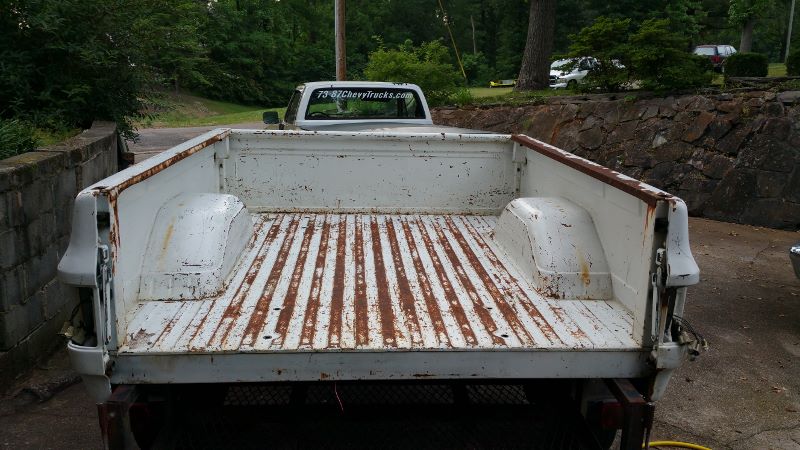

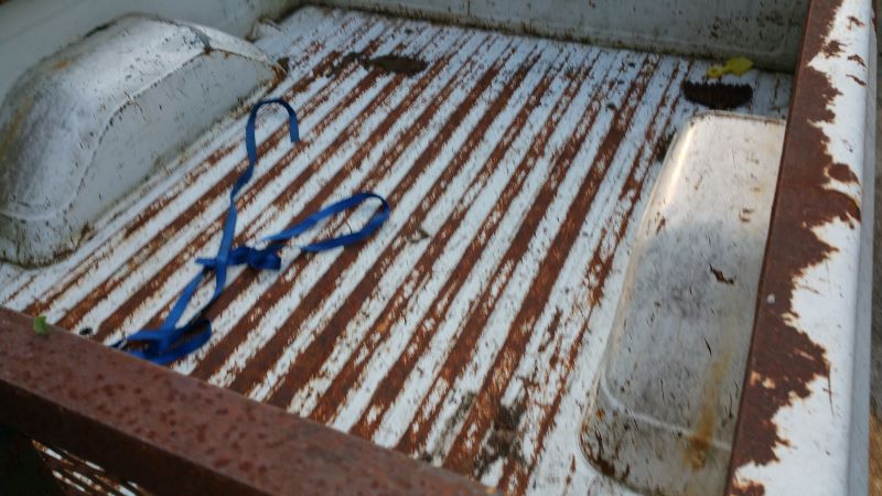

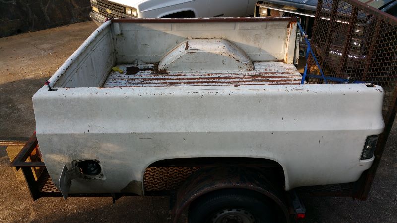

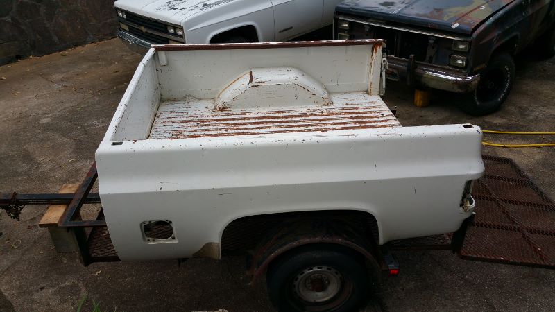

Saturday, May 9th, 2015: I went and picked up my spare bed so I can do some modifications to it that will allow me to drive anywhere and fill up the tank.  Previously I had two gas stations that I knew I could fill up at and it would only take me about 8 minutes to get gas as it wanted to spill out.  I had plans to go on Power Tour and I needed to be able to go anywhere.
Bed lacks much in the way of pretty, but I won't mind cutting it up as I found it from a friend and it was rotting in the woods.

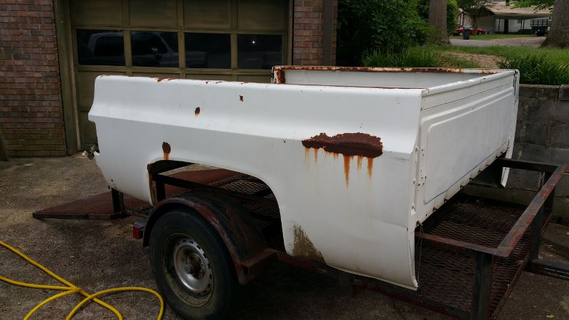

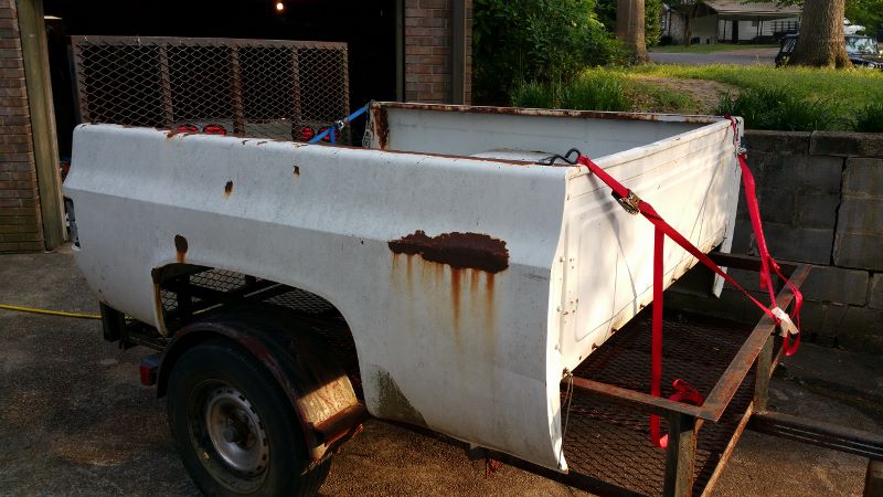

Tuesday, May 12th, 2015: I spent the afternoon doing some serious washing on the bed.  I also talked to a place that said they would fill the door on the drivers side and put the gas fill hole on the passenger side.  I just needed to find a donor opening and either fab a gas fill or find one from a Blazer.

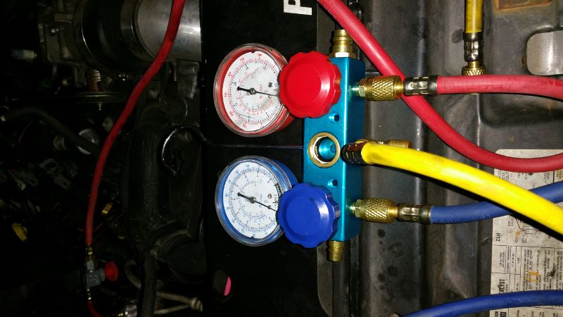

« Reply #329 on: December 09, 2015, 09:35:56 pm »
Wednesday, May 13th, 2015: Seeing that I am going on Power Tour I figured I would need to charge my AC, so I vacuumed down the system and let it set overnight.  I ended up charging it later on prior to going to Power Tour but the pulley setup was giving me fits.  I had issues with the original Novack setup so I called them and the told me they would send me an updated setup that used a different pulley.  So far other than a weird vibration when the AC is on at the idler everything works ok..  I also ended up NOT using it during Power Tour, just ran with the windows down.
