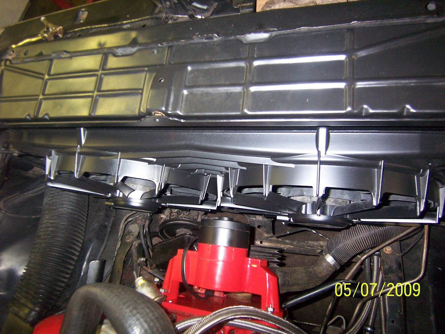

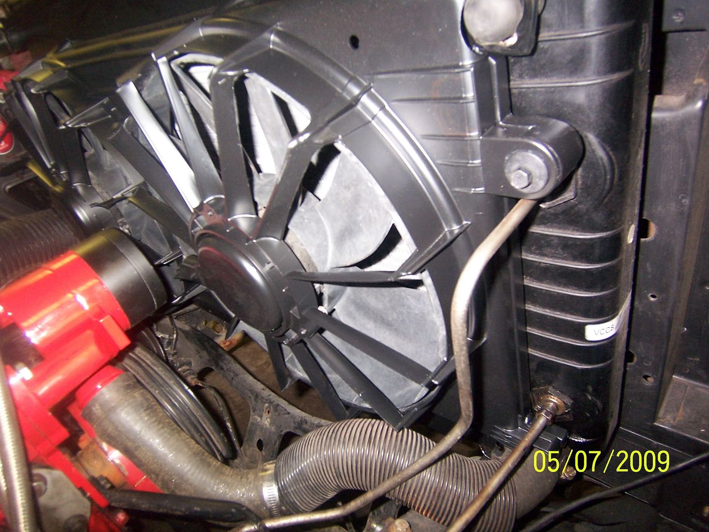

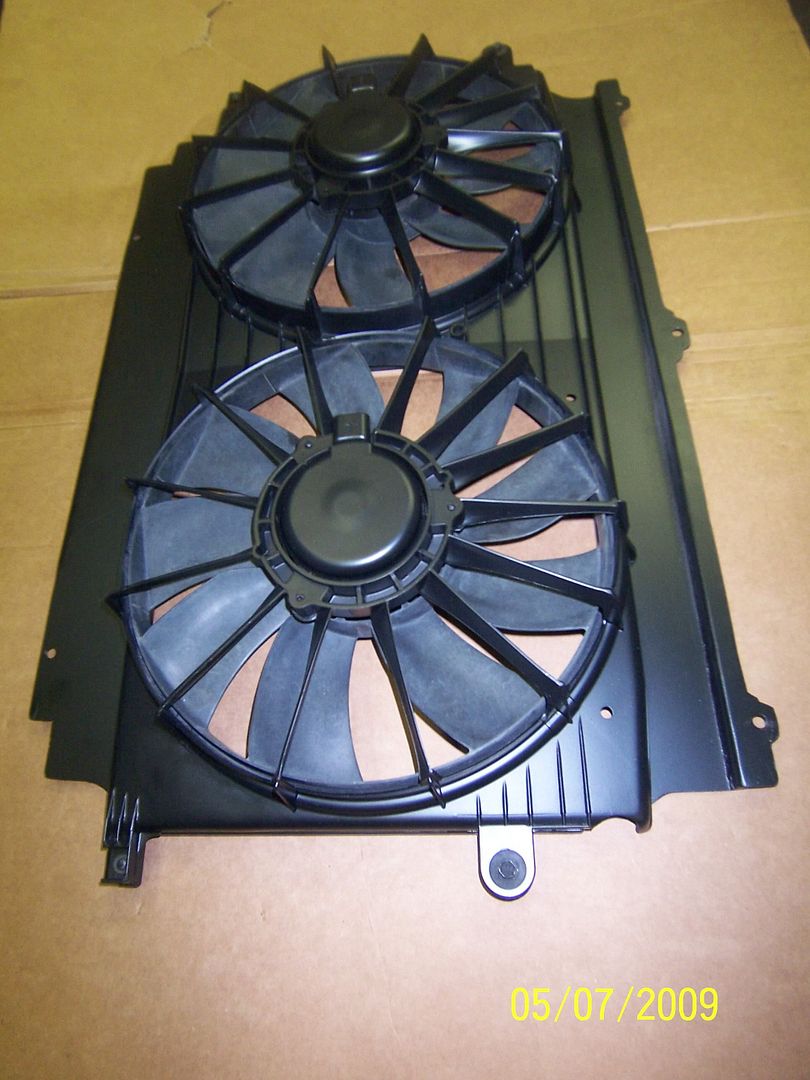

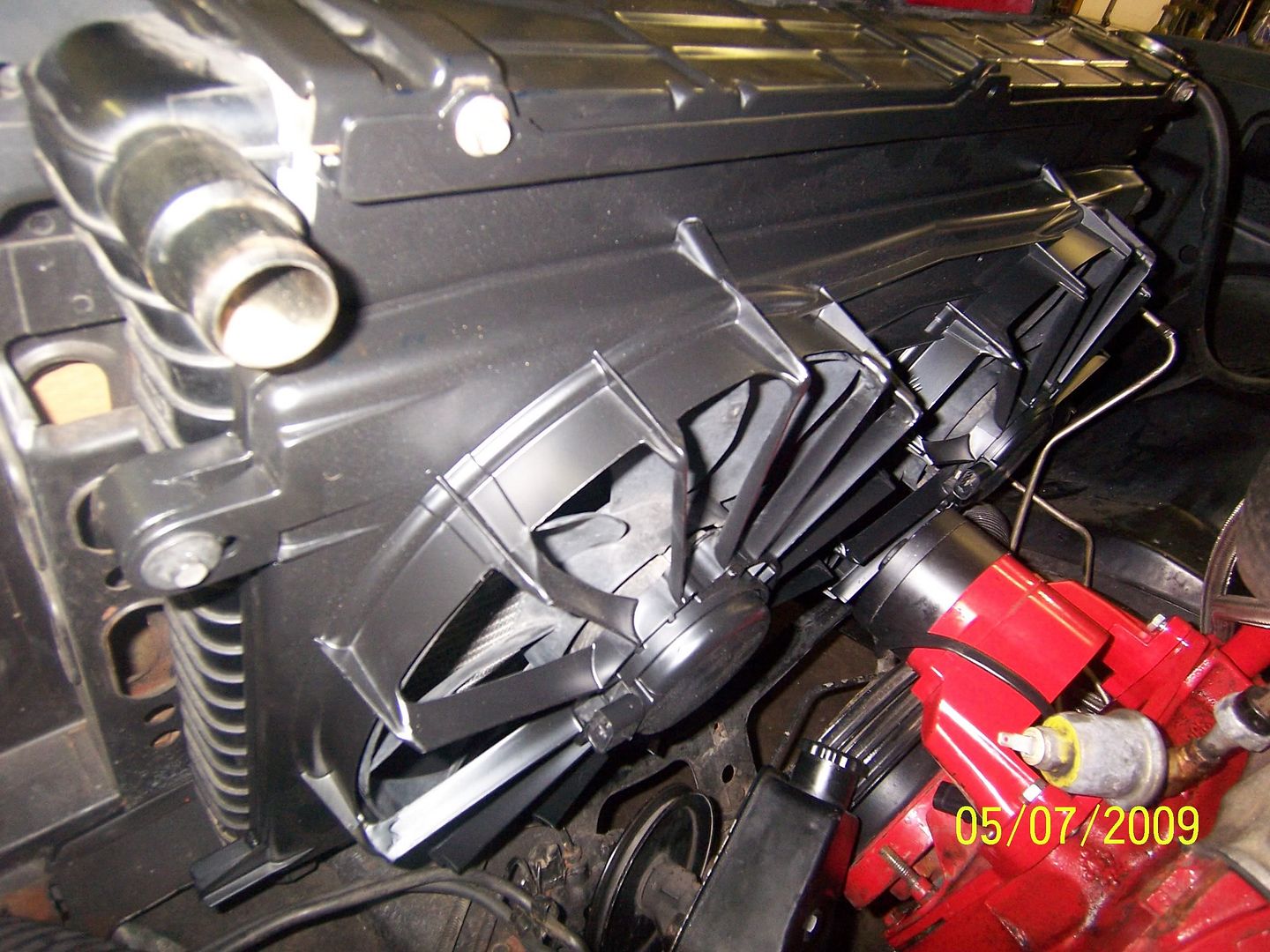

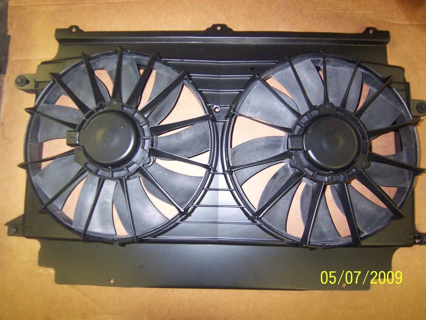

Here's my latest project...Some of the Water pump won't apply to most of you, but I thought I would share my fan findings. It may not be the absolute best fan set-up, but it's a really good fit (with some home-made bracket/shroud) for our trucks. I found this by pretty much an accident (no pun intended). It is from a '99 Seville. I brought it home, having a couple broken spokes of the shroud from a wreck & found as I was figuring...just how well it fits & is sized well. I did remove some irregular "growths" from the shroud, like a indent (in the wrong place) for the upper rad hose & a molded in triangle hose holder & some other unneeded molded in tabs/holders.
 Here are a couple in the fitting stages

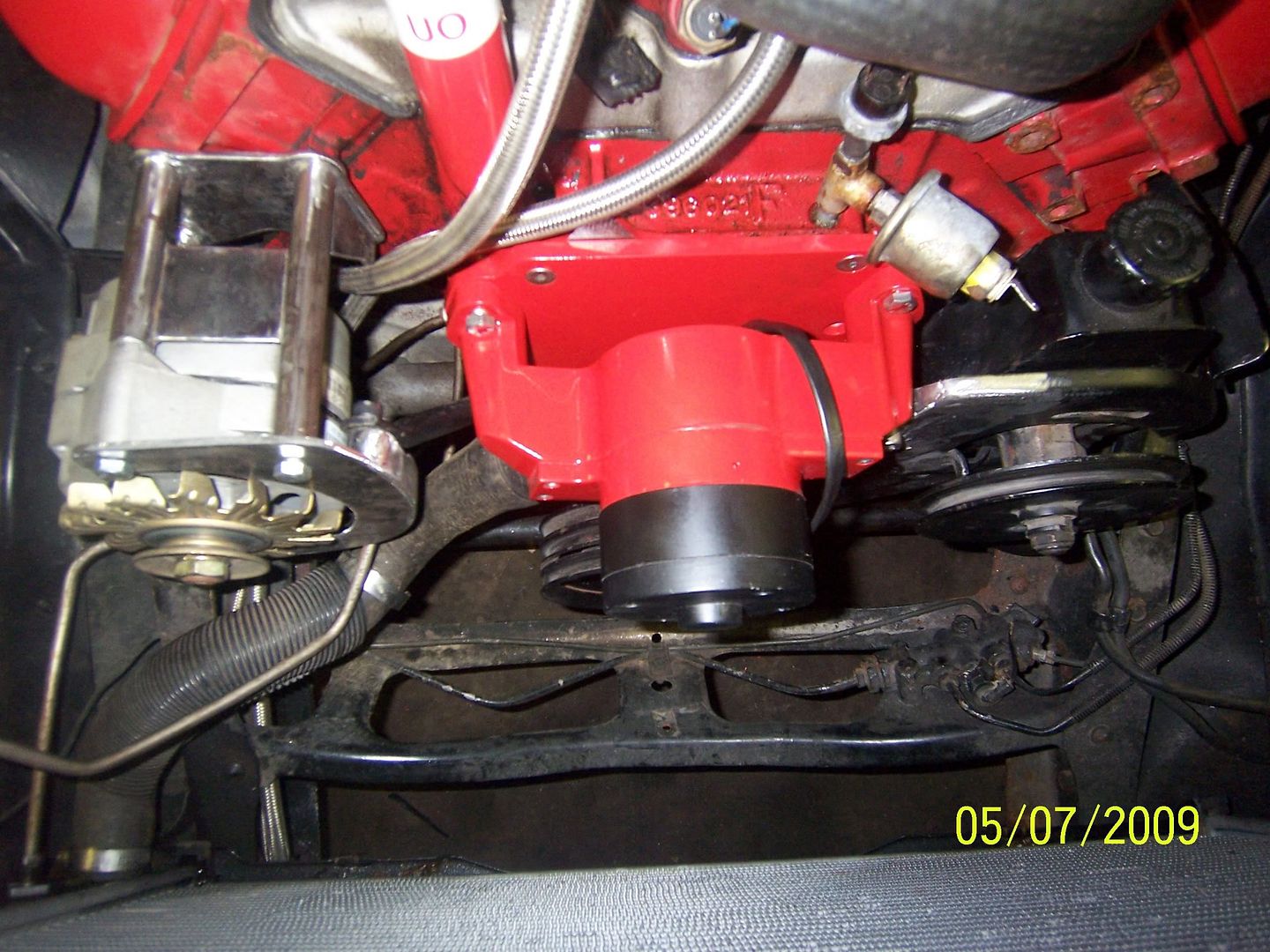

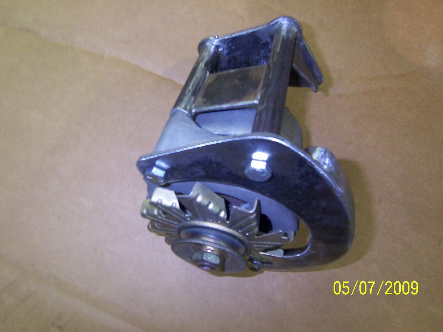

 Here is a couple shots of the home-made alternator bracket & modified power steering bracket
 Installed for test-fit & belt lengths... That is a small block Chevy water pump adapted to the Olds engine

Vile, It's the same radiator that I put in when the truck was built...a Aluminum/plastic tall replacement for our trucks. The top support is Chevy truck also, originally I bought the radiator, top plate & shroud for a big block truck.

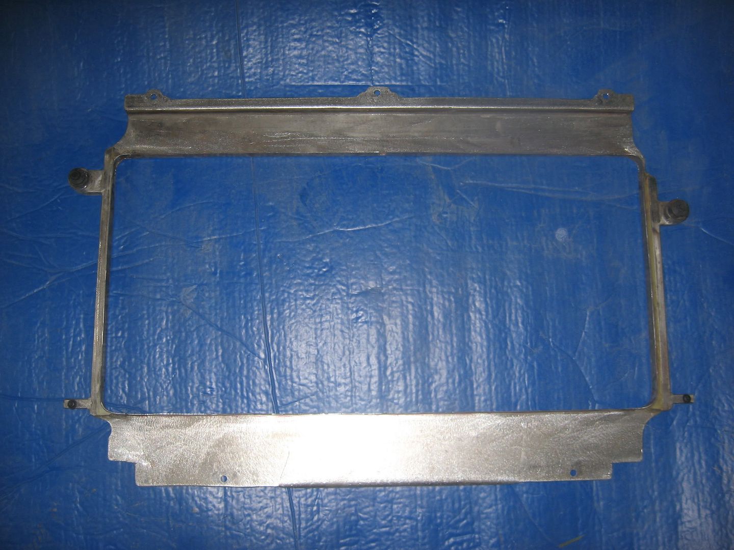

 What I did was start with a 2'x3' sheet of 16ga metal & cut out the center hole, folded lips on it, ect. The top area is a piece of light angle iron cut to match the Chevy top plate. The sides have a piece of 1/2" square tubing for support & to close off the shroud...basically I laid the original shroud down on the metal & marked the mounting holes & tank width, then laid the Caddy fan assy. on & figured what was needed to mount it where it fit & went from there. I thought I had a picture or Two of the metal part separate, but I didn't find them. The Black area in the photo is metal, the Gray is the Caddy shroud. I painted the other side of the Caddy shroud so it all looked the same.

Very cool, Lorne! In the recent issue of Hot Rod where they fix up a 73 2wd stepside, they found a dual-fan Flex-a-lite setup I believe that apparently fit the stock rad pretty much perfectly. Aftermarket dual-fan setups are a heck of a lot more expensive than a junkyard OEM find though.

Sux, I did see that article. Those are 12" fans & way the shroud is (very flat) & installed, it leaves allot of surface area not having air pulled across it. Also I personally am not a fan of their attaching method (those plastic ties through the core) with the weight & vibration of the fans, could lead to a need for radiator repairs. A bracket/mounting plate of some sort would be better, it leaves the radiator to "float" on the rubber cushions & the fan weight/vibration is left to the rad. support. It may not cause a problem this week or next...maybe never, but still not the way to go.

I found the pic's of the fan bracket in bare metal (they were on another disc for some reason). This should make it a little clearer as to what was done. Lorne

1) Could we get a break-down of all the parts nessesary, specifically part #'s?
2) i think the main thing is an exact, step-by-step instructional on how to install electric fans the right(safe) way.  Specifically, the whole fuse/relay issue, so as to prevent a fire.
3) Why again, did you have to fabricate an alternator mount?
Offline eventhorizon66
  • Posts: 1909
Re: Electric fan & Water pump installation
« Reply #8 on: August 13, 2009, 11:03:15 am »
Electric water pumps don't have provisions for the alternator bracket like the stock pumps do.

Offline drag80
  • Posts: 50
« Reply #10 on: September 26, 2009, 01:42:30 am »
you can buy a alternator bracket that bolts on using the water pump bolts, I beleive moroso makes it..but it's not cheap though
