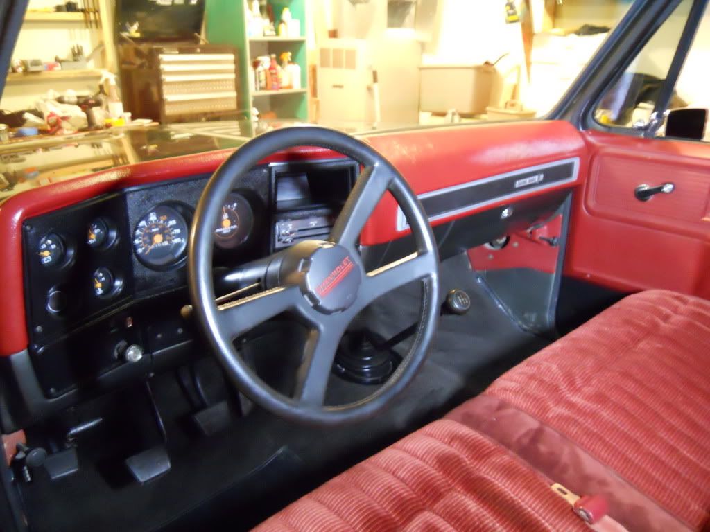

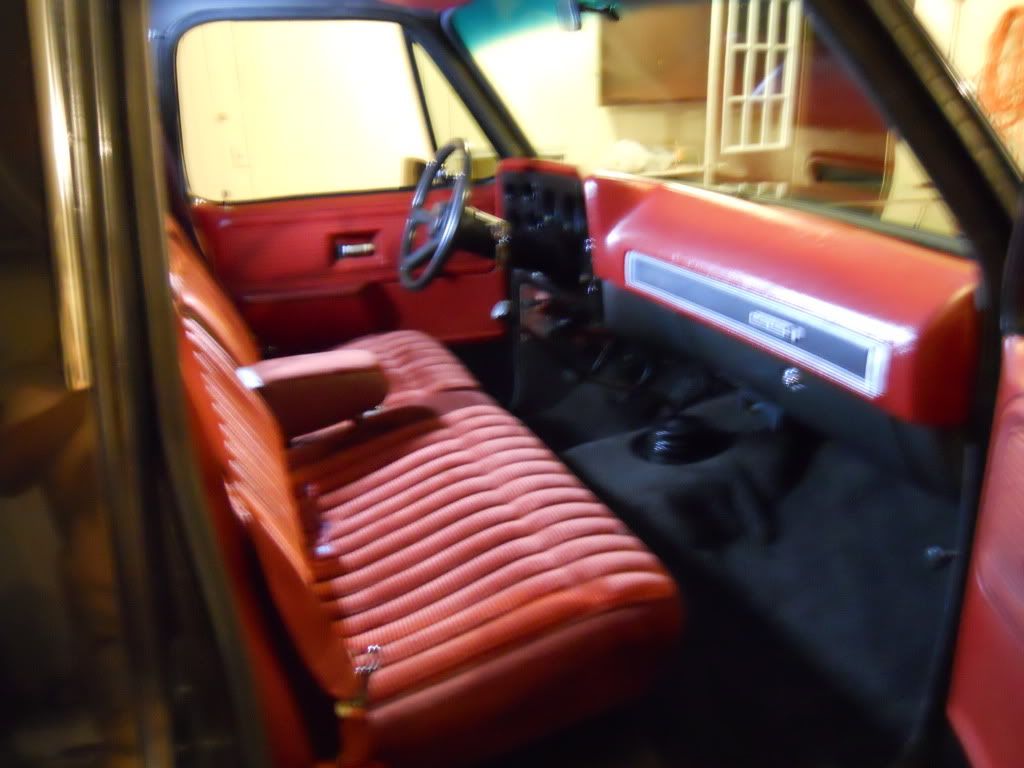

here are some pics of the seat for heavychevy91 and some other misc pics.
[imghttp://i686.photobucket.com/albums/vv222/titera1/DSCN0438.jpg]http://[/img]

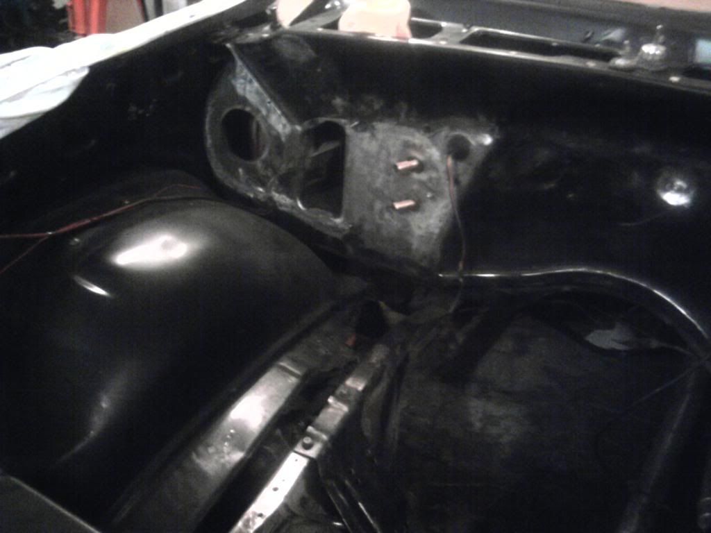

Some progress made;
I brought the truck home to begin the engine and trans swap today.
I removed the 250, drive shaft, clutch linkage etc pretty much everything except the crossmember.
To start the clean up, I removed the washer fluid tank and hoses and they will not be going back in.
I also hid the entire head light wiring harness inside of the header panel and inside of the fender.
For the battery i will turn it around so the post are pointed toward the header panel and run longer cables inside of the header panel and inside of the frame along with the wiring from the starter, I installed a mid mount alt bracket to keep the wires low and they should be hidden fairly well.
I removed the heater box as well along with some other items on the fire wall
I want to install a newer fan from a 94 chev, Is this the right year to get?
What is a good way to remove the tar like rubber coating on the firewall?
btw I am leaving the fenders on.

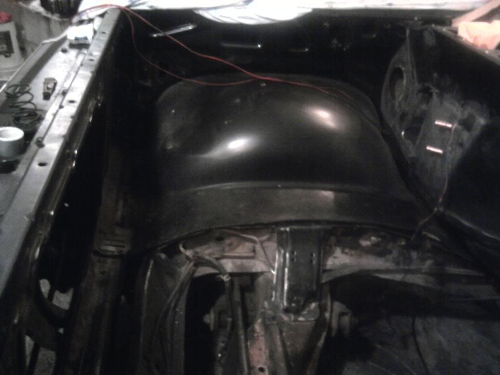

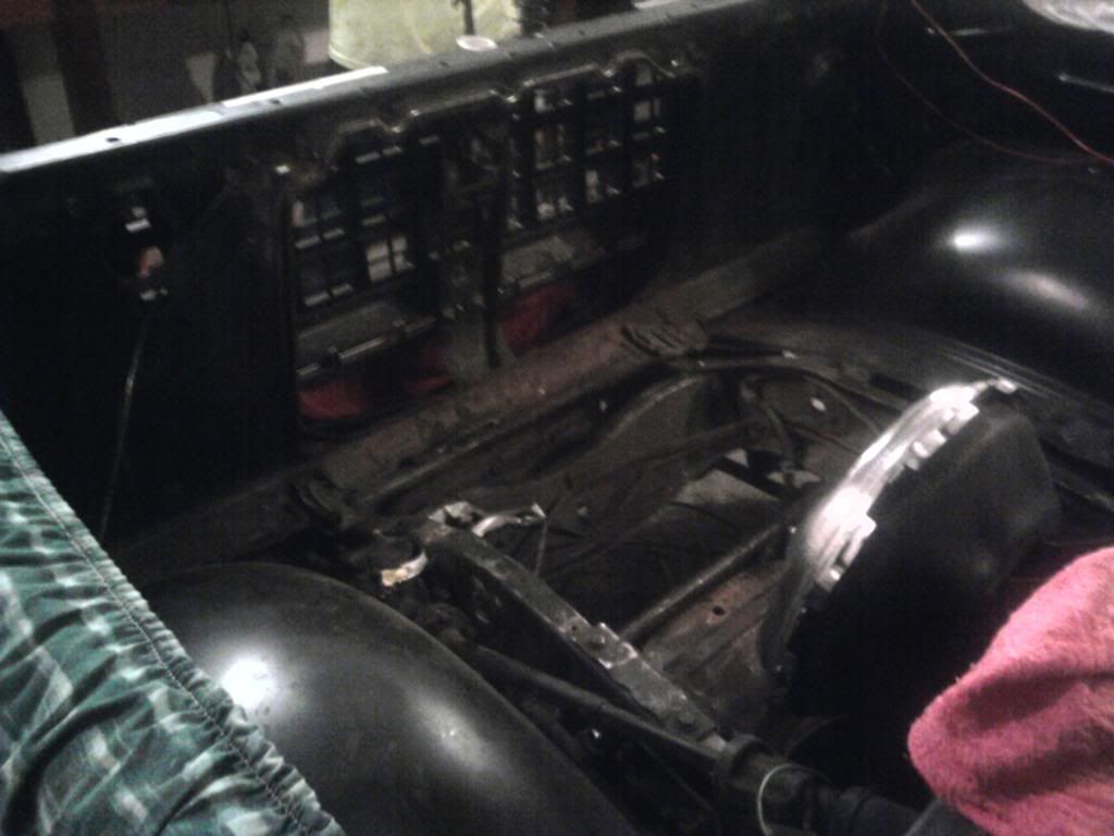

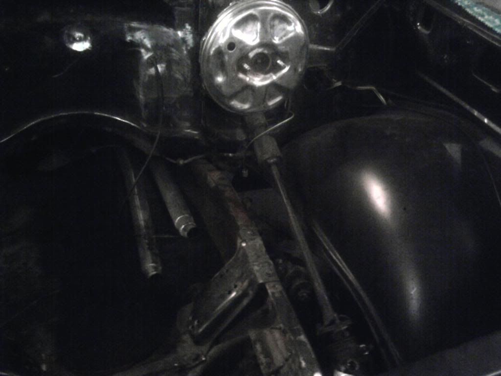

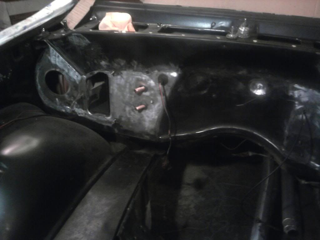

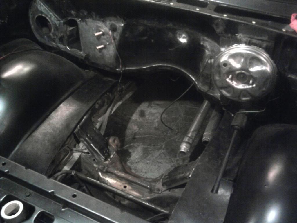

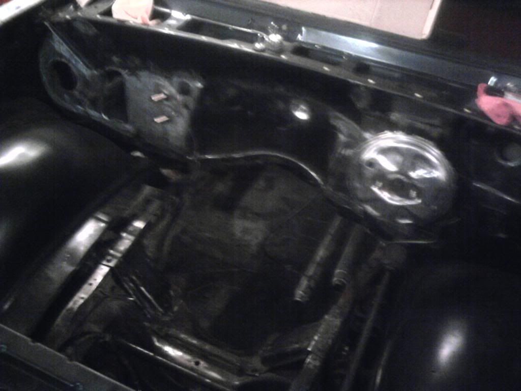

Made some more progress this weekend. I removed the transmission, crossmember, I also ran a new fuel line on the engine, mounted the alternator, starter, new pulleys and some other misc parts.
I also took some photos of where I am at as of now.
A little fuzzy because they are from my cell phone.
heres a pic coming out of storage
some pics of the underhood clean up
I made some covers from rubber to cover between the inner fender and frame rail
Last Edit: February 27, 2011, 07:05:43 pm by 1980c10
