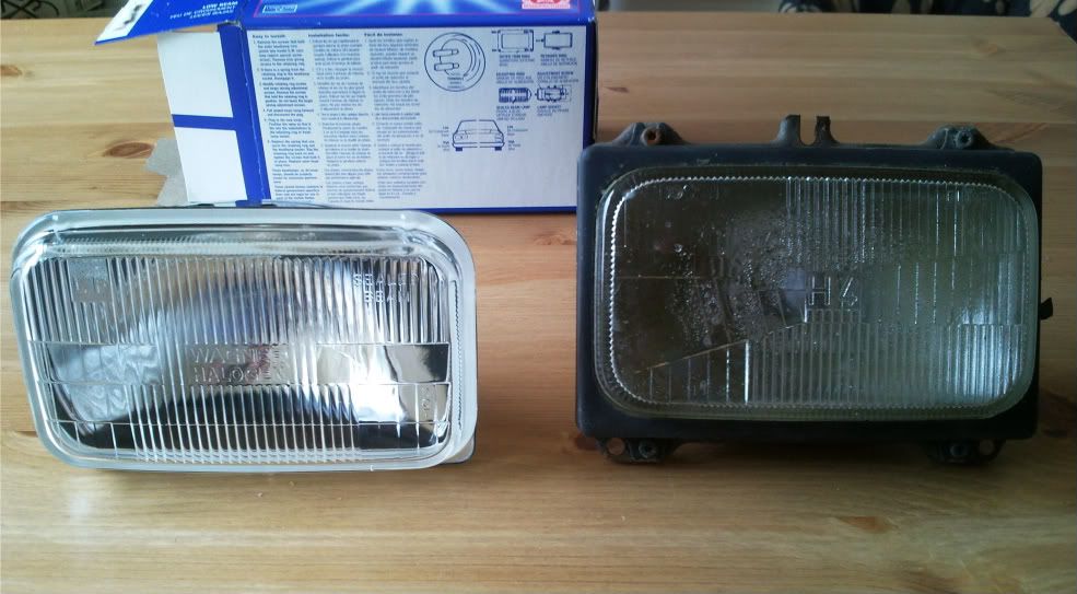

I've had to order some new headlights, the one on the left is the new one and doesn't have the black surround like the one on the old one to the right.... the black surround holds the light in place on my front end with those open ended clips (one up top and one to the right), is this the right part because the guy in the shop says this is the ONLY headlight listed for an 89 crew cab front end.....
Also.... If I wanted to put an 85 - 87 grill onto my truck, with dual headlights (stacked one above the other) will my front panel (off an 89 Crew Cab with dual side by side headlights) work with that set up??

Your H4 headlight should have a replaceable bulb in it where as you picked up a sealed beam.

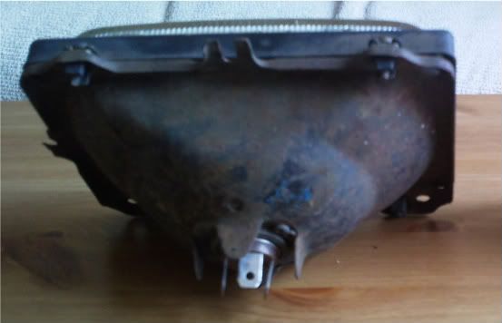

Thanks Vilezambonie, how do I get the bulb out???  ???
Here's the back view...

Take the 4 screws out holding the headlight in. Then you should be able to see it.
