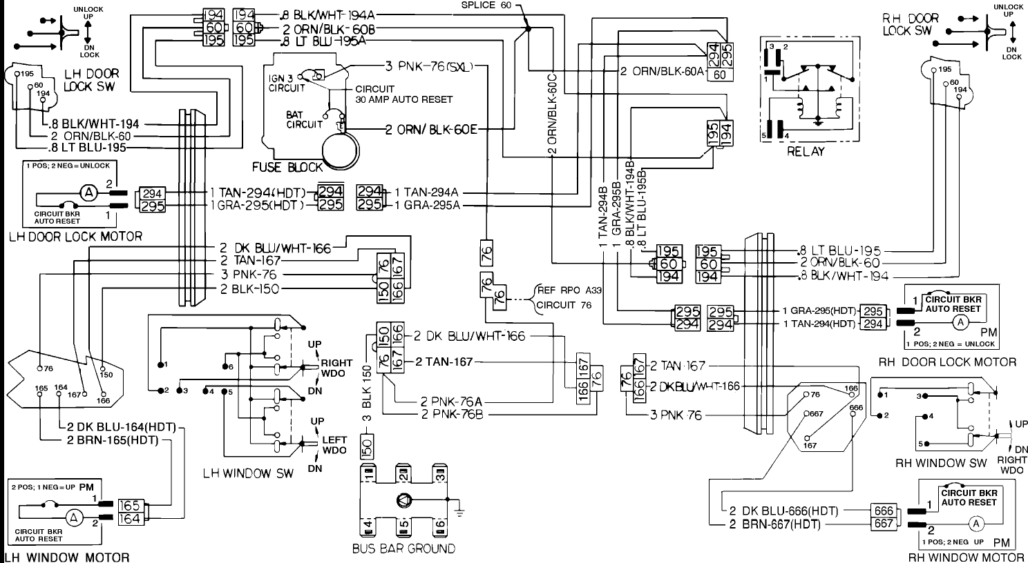

The shop manual shows mine, a single relay,(1987) behind the dash attached to the brake pedal bracket. It looks like the heat/ac ductwork would have to come out to get to the relay.

Whew. No wonder it's got a 30 amp breaker.
