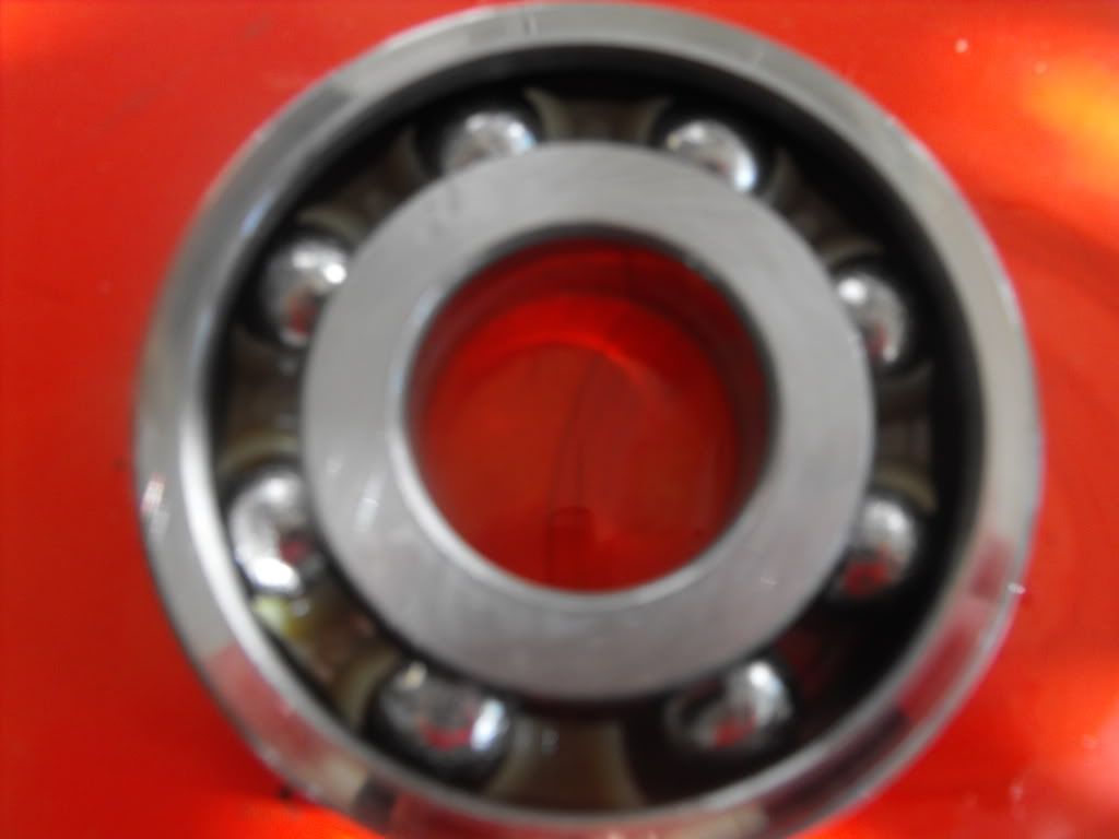

Tore it all down found the bearing in the back is gone (why is the cage plastic?) , one of the syncros is cracked.
The person that worked on this should be shot. He put 80/90 in both the trans and transfer case my feeling it was making noise so he thought thicker oil. Both units have been apart before (Rtv instead of gaskets) but he never changed the U-Joints (still has the plastic in the drive shaft no clips).

Here is some pics
Main Shaft about to go in the cleaner
Busted Rear Case Bearing
Broken Syncro
Other Side of the bad bearing pic not to clear but alot of the balls are "pitted"
