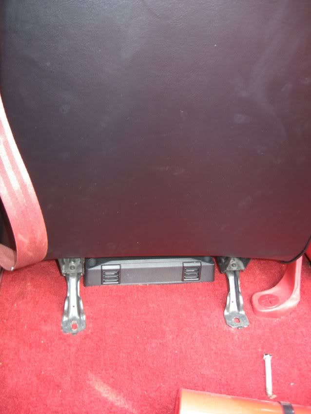

Chris, I finally got the seats back from Norm @ Norm's Upholstery in Gurly, AL. He said that the seat had been repaired in the past but that it had broken again, so he welded some bars in there and straightened the seat up to where it was supposed to be. Said it'd be dang near impossible to bend the seat again.
Anyway, here's how they had it rigged. See the 3" sleeves between the bracket and the floor...that was their solution when the seat bent. I didn't think those were factory, but I couldn't find any pictures of how they looked stock.
Before
After
(note that I don't have the screws in there yet -- I have to find some short stock ones to replace the mess that was in there)
Posts: 18512
Re: Seat Bracket 83 K5
August 24, 2009, 06:04:06 pm »
yeah, definitely NOT stock. the bottom is how they should be.

The only question I have left is whether that model (83) K5 had any type of plastic cover that covered the metal frame of the driver's seat, or not? I know they had the plastic on models around 85 or 86, but the seat frames had changed (different than mine) somewhere between 83 and 85 or 86. I wasn't sure what year they started using the plastic to hide the seat frame.
Do you know what I'm talking about? I attached a picture with an arrow -- obviously those have a different frame than what I have, but I need to know if my model would have also had some sort of "cover" for the seat frame, too....or if it was just open (seat frame visible like it is now)?

Posts: 18512
August 26, 2009, 05:22:34 pm »
What you pictured is the actual frame, that version started in 86.
None of them had covers on them.
