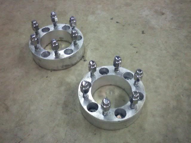

« Reply #13 on: October 19, 2009, 05:41:01 pm »
Here's the spacers I have in my garage. These are going on my 75 Blazer
