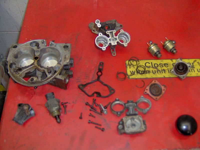

They are simple to rebuild. I need to put the article and pictures up in the tech section where I pulled mine down, but they are SIMPLE, there is really nothing to screw up on one.

Here's some pix... it's easy

It's just to show you how easy it is to pull apart

Hey vile, what's that thing in this pic? Is that the IAF or IAT (or whatever) sensor?
Layne
Posts: 1023
Re: Will a 5.0L injector work ok in a 5.7L?
Reply #27 on:
January 03, 2010, 04:49:25 pm »
Idle Air Control Valve.
