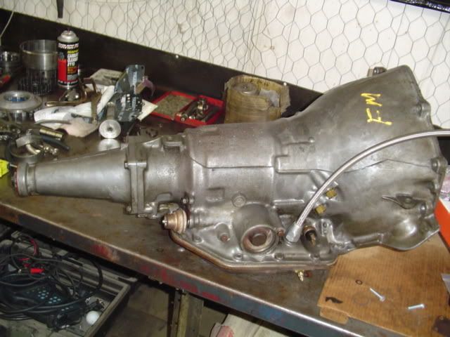

Re: I need at least a suggestion as to my despair
« Reply #4 on: February 14, 2010, 08:18:38 pm »
The gold cylinder in this pic
Just pull the vacuum hose off of it

« Reply #5 on: February 14, 2010, 08:46:58 pm »
you mean this one on the bottom side?

« Reply #6 on: February 14, 2010, 08:59:34 pm »
He meant by the tailshaft housing where it bolts up to. See it looks like a brass bell thats got a small nipple sticking out.

« Reply #7 on: February 14, 2010, 09:14:56 pm »
ok this one?

« Reply #8 on: February 14, 2010, 09:18:18 pm »
Yes that 1..
