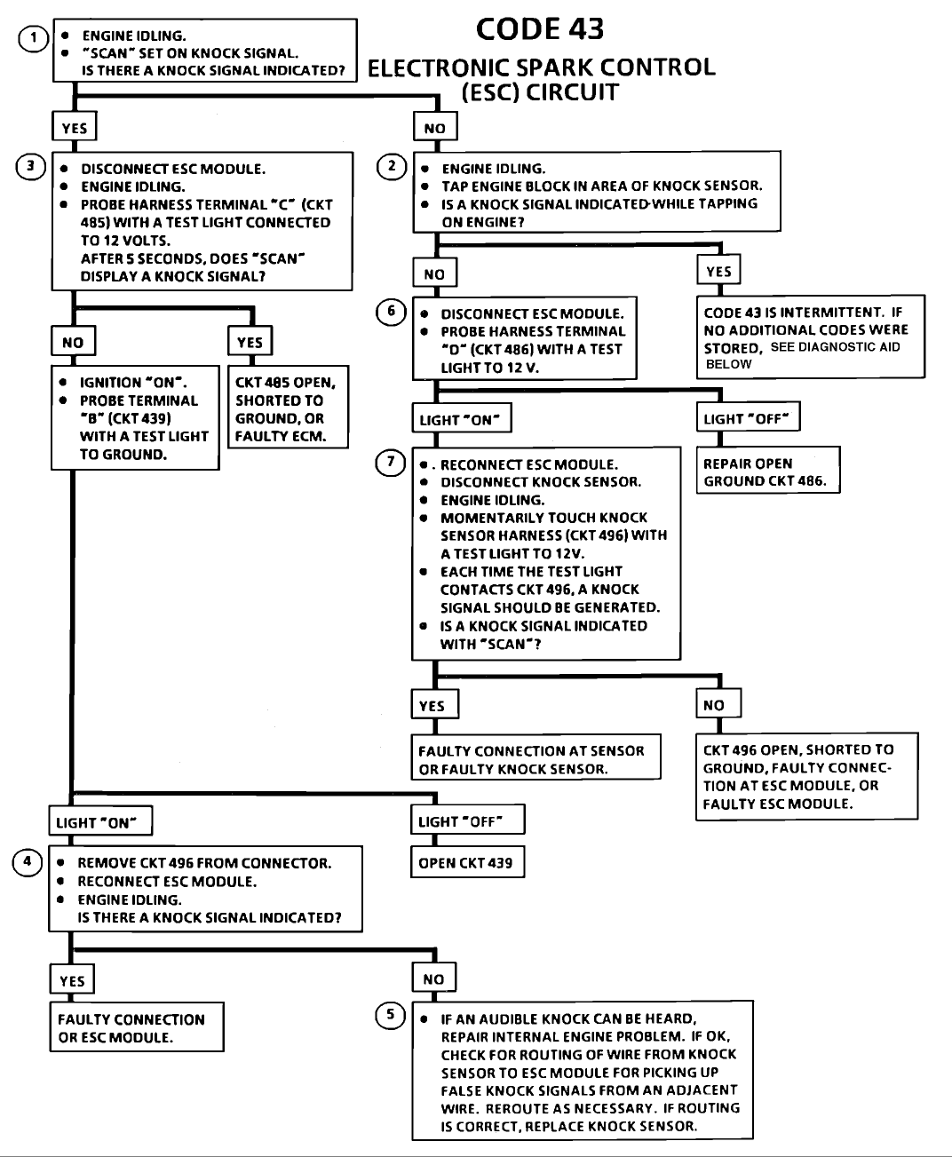

This ought to help
CODE 43 - ELECTRONIC SPARK CONTROL (ESC) CIRCUIT
 Circuit Description :
Electronic spark control is accomplished with a module that sends a voltage signal to the ECM. As the knock sensor detects engine knock, the voltage from the ESC module to the ECM drops, and this signals the ECM to retard timing. The ECM will retard the timing when knock is detected and RPM is above about 900 RPM.
Code 43 means the ECM has been low voltage at CKT 485 terminal "B7" for longer than 5 seconds with the engine running or the system has failed the functional check.
This system performs a functional check once per start-up to check the ESC system. To perform this test, the ECM will advance the spark when coolant is above 95~C and at a high load condition (near W.O.T.). The ECM then checks the signal at "B7" to see if a knock is detected. The functional check is performed once per start-up and if knock is detected when coolant is below 95~C (194~F), the test has passed and the functional check will not be run. If the functional check fails, the "Service Engine Soon" light will remain "ON" until ignition is turned "OFF" or until a knock signal is detected.
 Test Description : Numbers below refer to circled numbers on the diagnostic chart.
If the conditions for a Code 43 are present, the "Scan" will always display "YES." There should not be a knock at idle unless an internal engine problem, or a system problem exists.
This test will determine if the system is functioning at this time. Usually a knock signal can be generated by tapping on the right exhaust manifold. If no knock signal is generated, try tapping on block close to the area of the sensor.
Because Code 43 sets when the signal voltage on CKT 485 remains low, this test should cause the signal on CKT 485 to go high, The 12 volts signal should be seen by the ECM as "no knock" if the ECM and wiring are OK.
This test will determine if the knock signal is being detected on CKT 496 or if the ESC module is at fault.
If CKT 496 is routed to close to secondary ignition wires, the ESC module may see the interference as a knock signal.
This checks the ground circuit to the module. An open ground will cause the voltage on CKT 485 to be about 12 volts which would cause the Code 43 functional test to fail.
Connecting CKT 496 with a test light to 12 volts should generate a knock signal. This will determine if the ESC module is operating correctly.
 Diagnostic Aids :
Code 43 can be caused by a faulty connection at the knock sensor at the ESC module or at the ECM, Also check CKT 485 for possible open or short to ground.
Re: SES light; throws code 43... '87 Silverado w/350
« Reply #5 on: February 24, 2010, 08:26:23 pm »
Direct link for full size
Click
here

 The ground in the pic above, Is yours in good shape? Clean

Rang out pin "D" to chassis ground (alternator housing)... reads a dead short.  Ground looks good...  >:(
« Reply #11 on: March 05, 2010, 11:15:39 pm »
Pin D is ground. Whuchu talkin bout willis?

Correct.... Based on the images posted above...
I disconnected the connector at the ESC module then took a continuity reading from chassis ground to the 2nd pin in the connector (labled as "D") which read a dead-short.  I guess technically it would be jack "D" since it is within a connector, but that's not how it is labeled in the diagram.
That indicated to me the ground lead going to the ESC is good.

Did you follow the diagnostic strategy? Do you have access to a scan tool? If all of the circuit checks come out ok replace the ESC module
