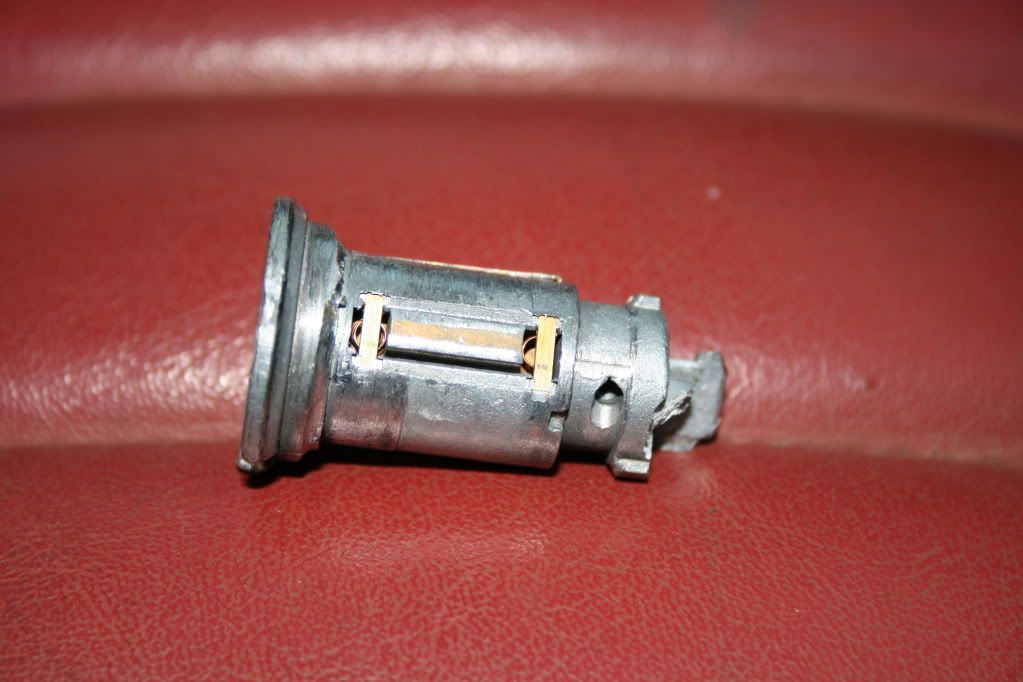

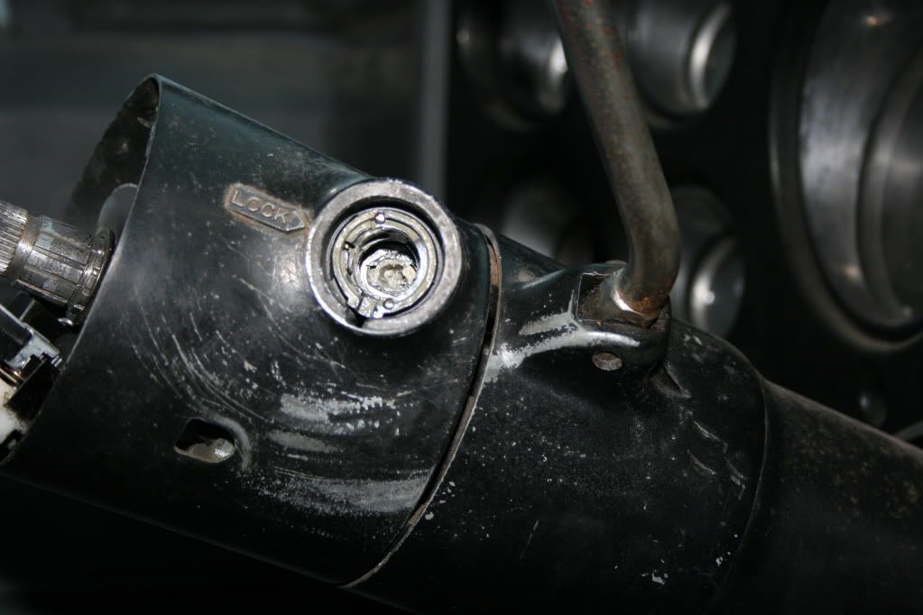

I did a search and saw a couple posts on this but I'm still having troubles. I have gotten everything off down to the blinker switch, but I can't figure out how to get the lock cylinder out. I read something about a lock cylinder retaining screw but the see only bolts inside my column. They look like they just hold that part of the column on to the rest of it. My cylinder actually broke apart inside and I had to slide the innards out and start the truck with a screwdriver. Now I can't get the outer sleeve of the lock cylinder out.

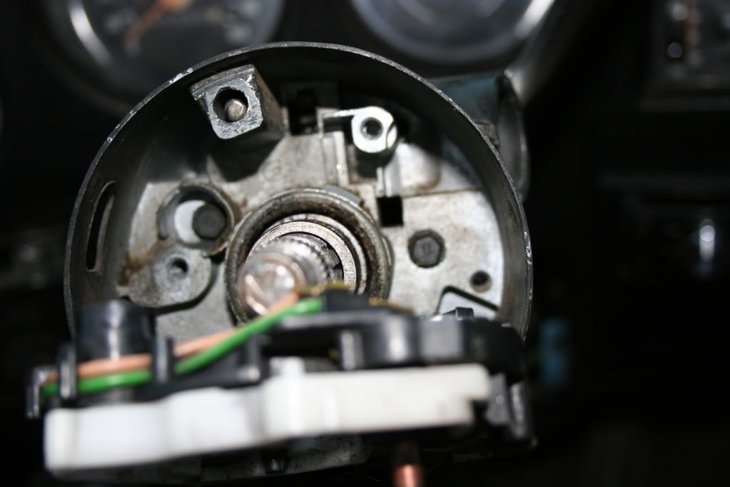

Broken cylinder
Inside of column
Broken cylinder

beside this pic theres a tab inside that square hole it has to be depressed and it should slide out look at the new cylinder you should see the tab
Offline bigfosty
  • Posts: 99
Re: Lock cylinder removal
« Reply #3 on: August 14, 2010, 03:12:24 am »
This square hole? I stuck a screwdriver in there but didn't feel anything.

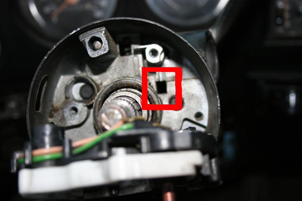

I've seen the diagram but it's hard to tell exactly where they are talking about. I think they mean the area right above the left side of the red square I drew but I just can't be sure.
« Reply #8 on: August 14, 2010, 04:32:35 am »
I want to say that the tab your supposed to put pressure on in the second pic with he red square slides in the keyway in this pic
« Reply #9 on: August 14, 2010, 04:55:22 am »
the part that brakes out is about 11o clock of your square in the valley to the right of the screw hole right above it

« Reply #11 on: August 14, 2010, 11:57:19 am »
When I did mine, the hole was filled in....   just some flash from where the part was cast...   I dont think the hole in your pic is it, it's less square and more rectangular.  just poke around, you just have to stick something through it to expose the hole.   get a small screw driver and poke around...  shouldn't take too much force to break through, then you'll have the hole. you need.  IIRC the hole is wide and thin.  but it looks like there is no hole, where it actually is.
Once you find the hole, you stick a thin screwdriver down in there and it will pop a release  think about releasing a big zip-tie, it's sort of like that.
EDIT:  If I remember Right, the hole is in the red square...  Poke a hole there, shouldn't be hard.   If its not though, you get the idea about what I meant by it being hidden.
