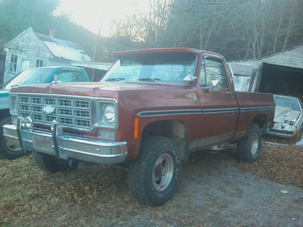

Well this is my first post here. i purchased some parts for my 82 blazer project and was really impressed with the customer service, the metal and the quality so i thought i would show you guys my other project i'm working on
i bought this 84 intending to use the motor and parts to build my 82 but after deciding to make a good work truck out of the 84 and have the ability to pull my blazer around and tow stuff i decided to go this route.
i know she is pretty rusty  ;D
tore off the old bed cause it was JUNK
the frame is solid just needs to be cleaned up
here is a comparison of how bad rust can get
picked up a turbo kit for the 6.2L pretty cheap
started tearing the 6.2L apart to build it some for boost
then i got a good deal on an 89 c30 that caught on fire. has everything i need to finish mine off
the truck came from down south and rust free for the most part
then we stripped both frames down
the plan is to take this axle
and throw it under the 3/4 ton
which means i have to remove this
next i have to remove the dually axle and cut all the rivets out and take the leaf spring hangars and use the one from the dually for the 3/4 since the two are different
what do you guys think? any advice on the dually swap or in general?
thanks
