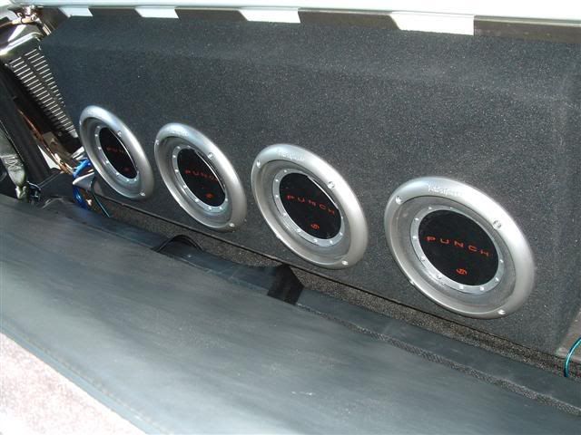

My head unit:
My 4 8" subs in sealed box:
Got my amp mounted under the seat. Everything is not complete. Getting my component mids and highs next weekend. I got my kick panels last week. Just waiting to get the speakers, and put my alarm in next weekend, and it will be finished...
The sub box fits good, and my seat goes all the way back.

Nice Setup Was wondering what amp are you running?, what model are the puch 8 's? what are the dimensions of the box if you don't mind sharing that info ?and how is the sound?
Thanks
Offline pcmcobra
  • Posts: 60
Re: Pics Of Box
« Reply #7 on: October 12, 2006, 05:49:00 pm »
I have a soundstream xta600.5 running the subs right now.
I have kick panels, and punch 5.25 components I am putting in this weekend. I also have punch 3.5 in the dash with some bass blockers hooked to the head unit.
It sounds pretty good. When I get the mids and highs in, I'll post some pics of them also.
It should sound even better.
The subs are punch 8" series 1.
I went with the budget amp and subs. I got 2 sets of the punch 5.25 components for $100 brand new. They are a couple of years old, but still new in box.
The dim. on box are....
41"wx14"hx6.5"d(bottom)x3.5"d(top)
The subs sound good, not too bassy, they could use some more power, I have the 5th channel bridged into 2 ohms@240 watts running them.
After I get the kick panels in, I'm making some brackets to mount the other set of mids/highs in the back, I'll post some pics.
