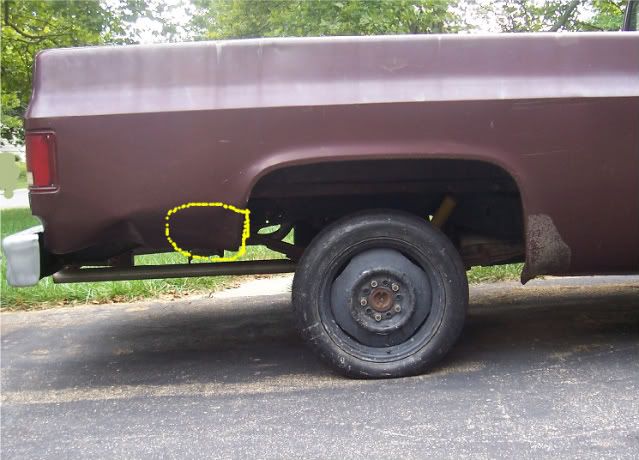

Well, i pushed it too far;  i tried to get too much out of a tire and it gave way, at the worst possible time.  And here's what it can do to a quarter panel:
It was actually a little worse---the area circled in yellow was actually pushed upwards to point where the crease is.  i bent it back down by hand.
The tread actually completely separated and then the tire just exploded:  i think the tread just whipping around at 60mph really gave the fender a wallop.
The tire was originally on the truck when i bought it and the paperwork from the p.o. states i think 1996 so that's 15 years and i was really pushing it trying to get about 12000 more miles before i was going to replace it.   But that was pushing it and it bit me and now i'm going to end up spending more $$$ than if i had just replaced the tire sooner.    So, it's ok to be frugal, but don't be too cheap like me.
Anyways, the important question is can i bend the metal back to shape myself?   Or should i bring it to a body shop?  i am not trying to get it perfect, just back to normal.  i'm not opposed to bringing it to a shop, but i would like it better if i could do it myself----i'm willing to by some tools if nessesary.

You can hammer it out with a small block of wood and a small sledge hammer and it will come back into some shape.Sorry to hear what happened, but the biggest thing is your ok and noone else got hurt.But im sure is scared the you know what out of you. It only takes 1 time to learn a hard lesson in life..

Might be easier to cut out the bad section and go to the junkyard and weld in a replacement.

  You may be able to bend it back out and straighten it out with a hammer and dolley, but its gonna take time and patience.Good luck too ya

You can straighten that out with a hammer and dolly. It's a single layer of sheet metal. It'll be way more work and expensive cutting it out and sectioning in another piece. (probly not look as good either) Get a bodywork hammer and dolly kit (a cheap one like at harbour frieght) and a book/ video on how to do it. Take your time and don't clobber it thinking you can get it done with 2 big blows. Get it close and apply the bondo (that is what bondo is actually for) then hit it with some paint. It'll be fine.
