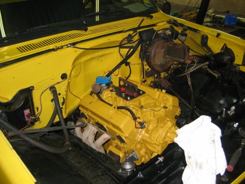

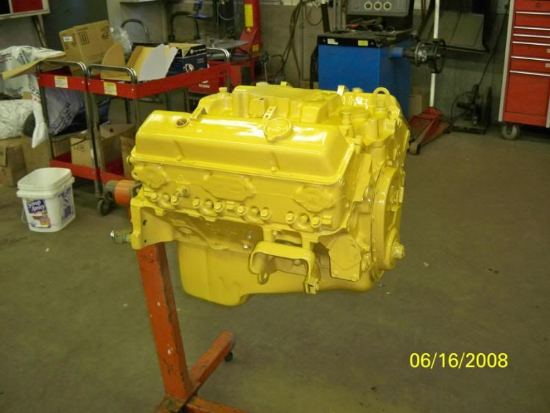

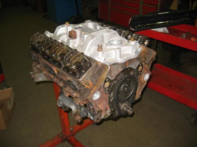

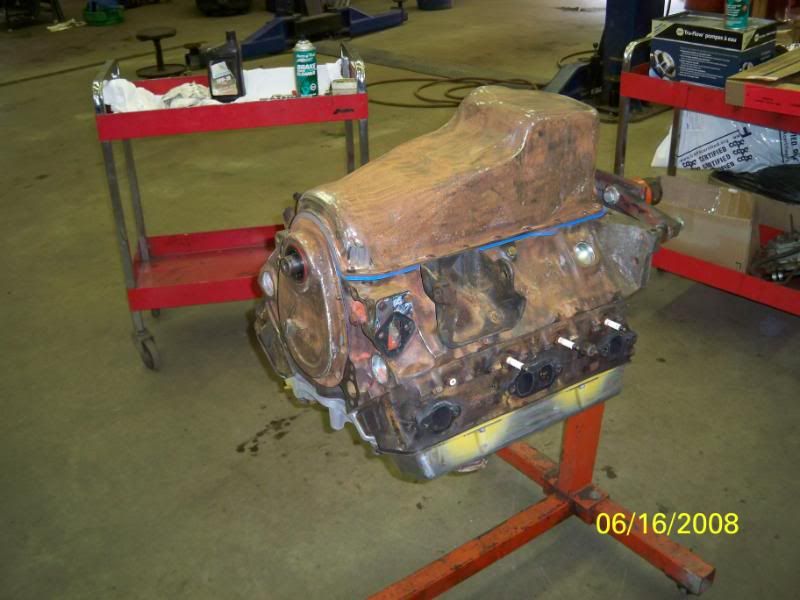

I use all of the above methods, and also Aircraft Paint Stripper. You will need to be careful not to get it on rubber, and your hands. Once the heavy grime is gone with degreasers and a presure washer. the stripper will take off all the old paint. I presure wash the striper off. Then I wire brush, use a mini grinder with scoth brite wheels, and 36 grit wheels. Also use a 3" DA sander to prep it, and a blow gun. For the rusty areas I use Chassis Saver, and the clean metal areas I use a spray bomb self etching primer
( Transtar brand is a good one ). Then paint with a quality top coat.
Few pics of the last one I did.
In the truck.
