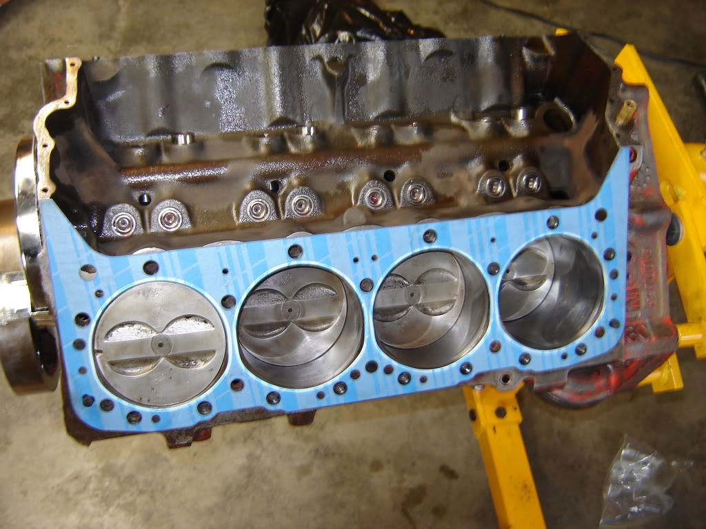

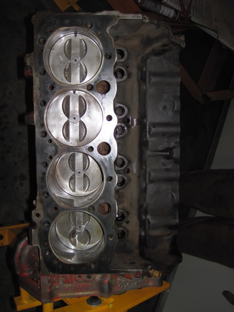

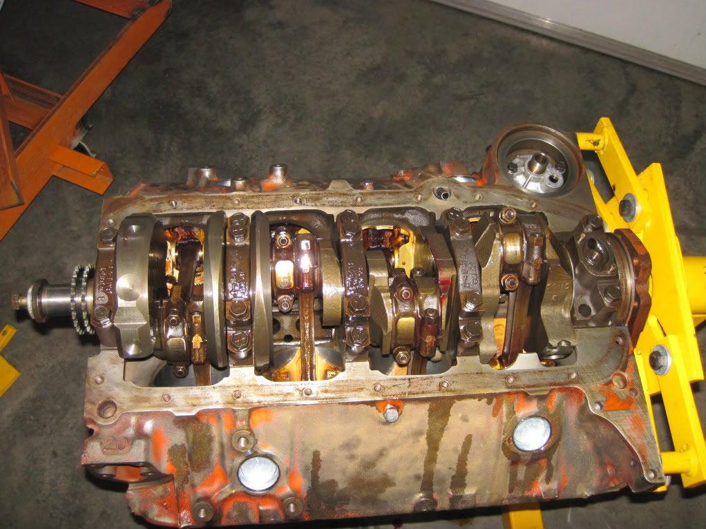

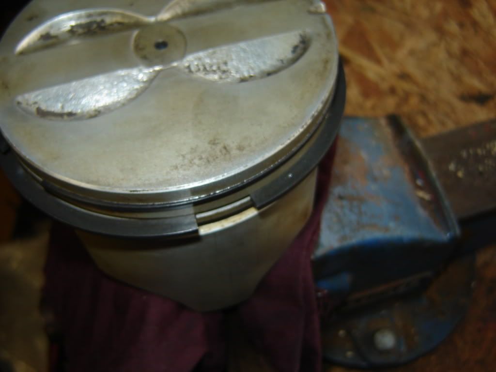

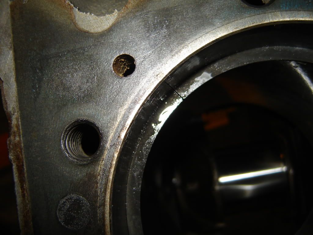

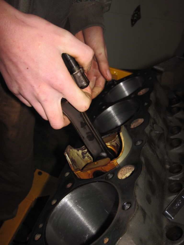

so first thing was to gap the piston rings, the rings i bought were pre gapped and all were within the tolerances but i still when through every one and i found it a very tedious task

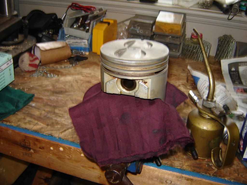

to get the rings square in the bore for measuring i pushed them down with an oiled up piston
instead of gaping all the rings at once i just gap two rings in the bore then put them on the respective piston

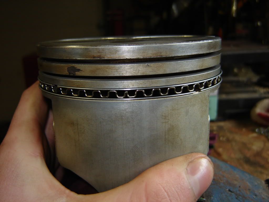

made sure all the dots were in the second row facing up
cheaped out on buying a ring expander and decided to use my thumbs. i will not make this mistake again because my thumbs were quite sore by the end of the 16th ring

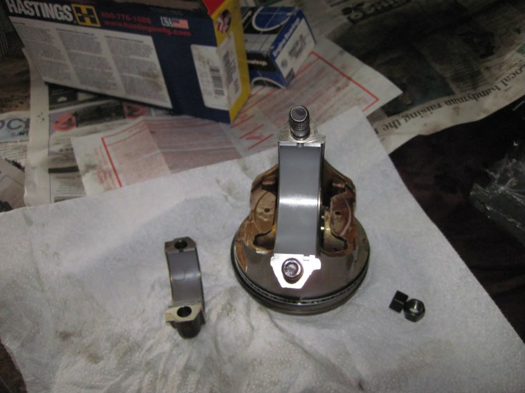

fresh bearings

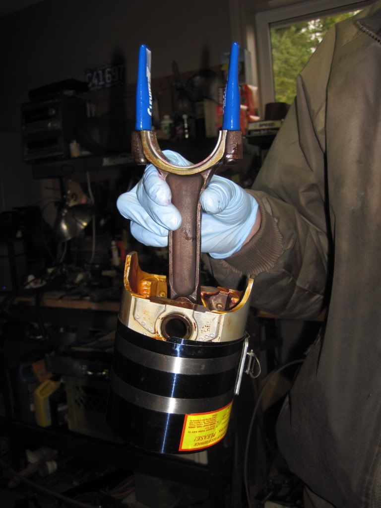

the guy at the machine shop gave me a set of these fancy blue piston socks for free ;D and i picked up this ring compressor for like 10 bucks at the part store which was nice

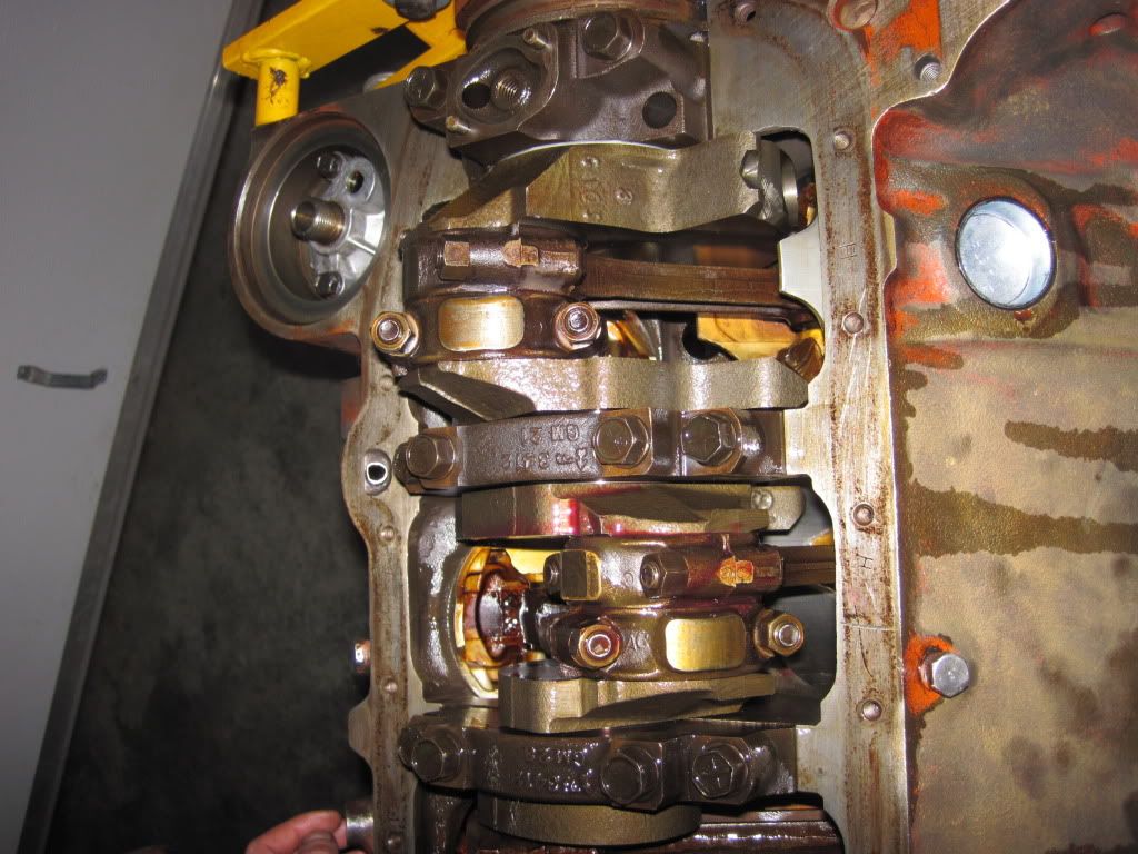

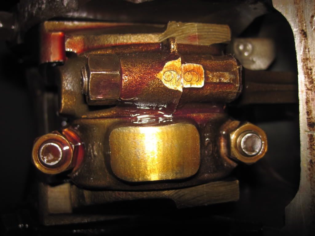

got all the pistons in
conveniently stamped so i knew exactly which way the caps go back on

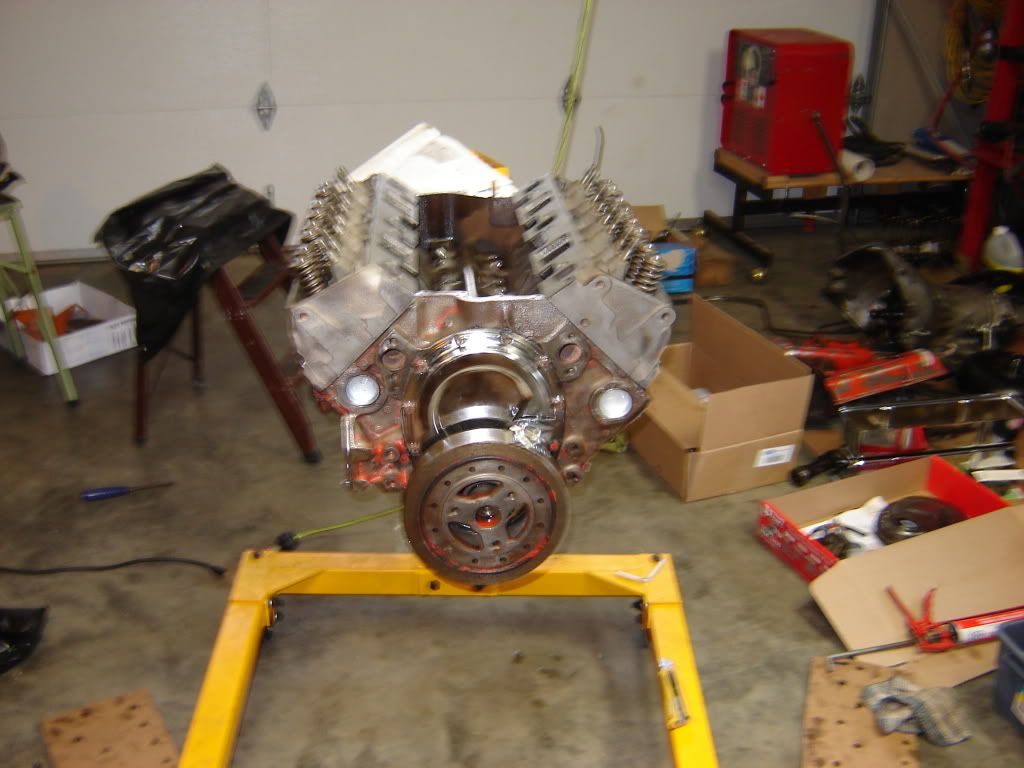

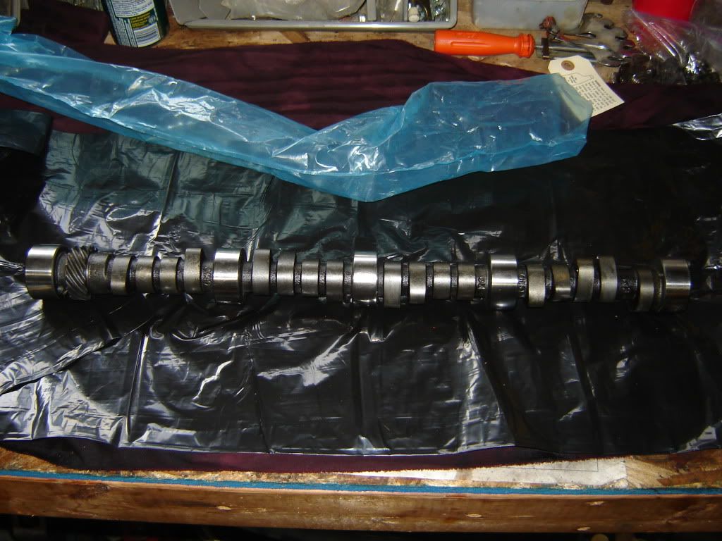

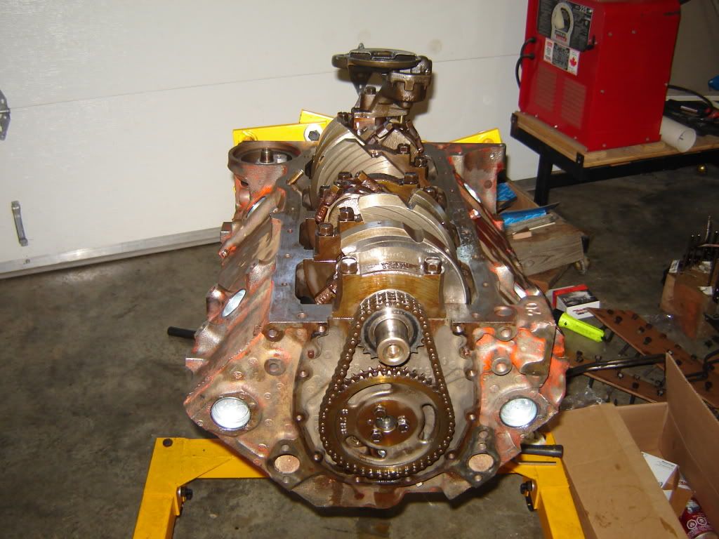

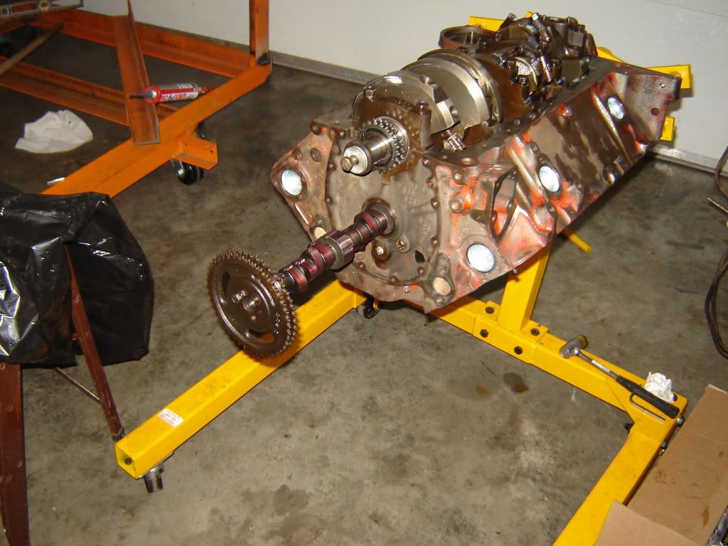

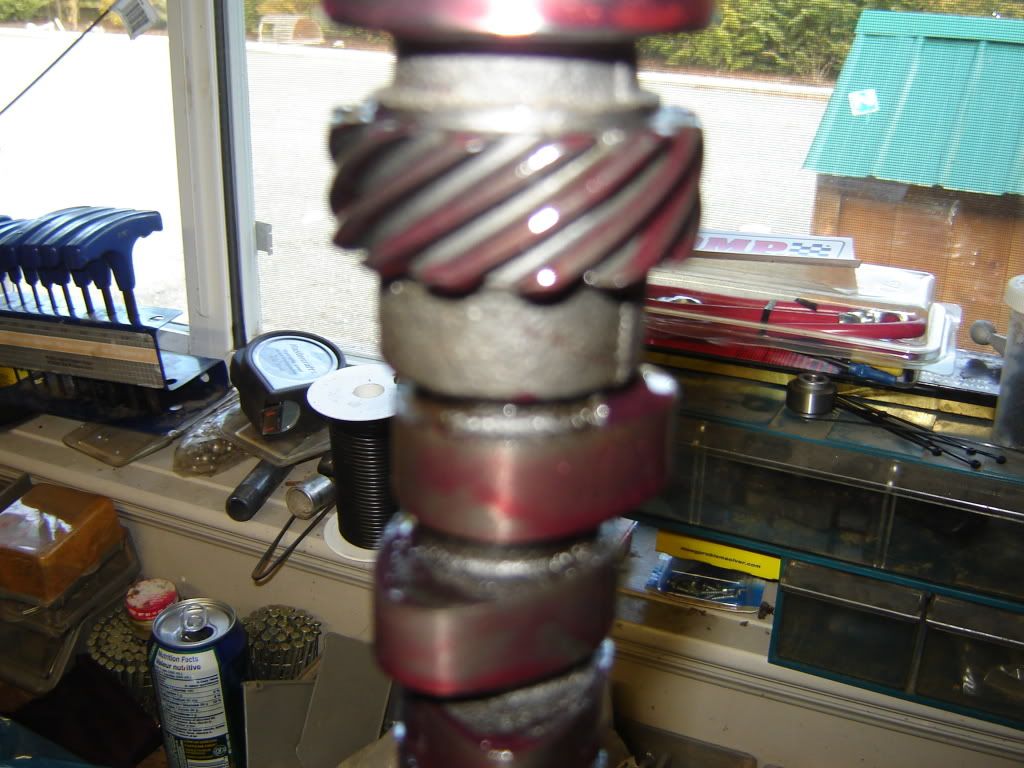

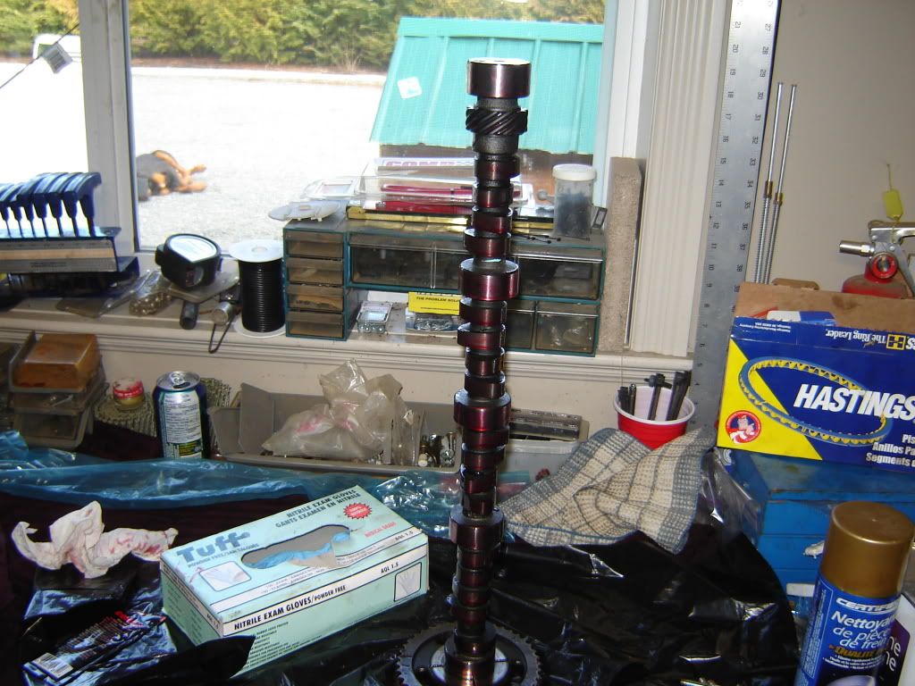

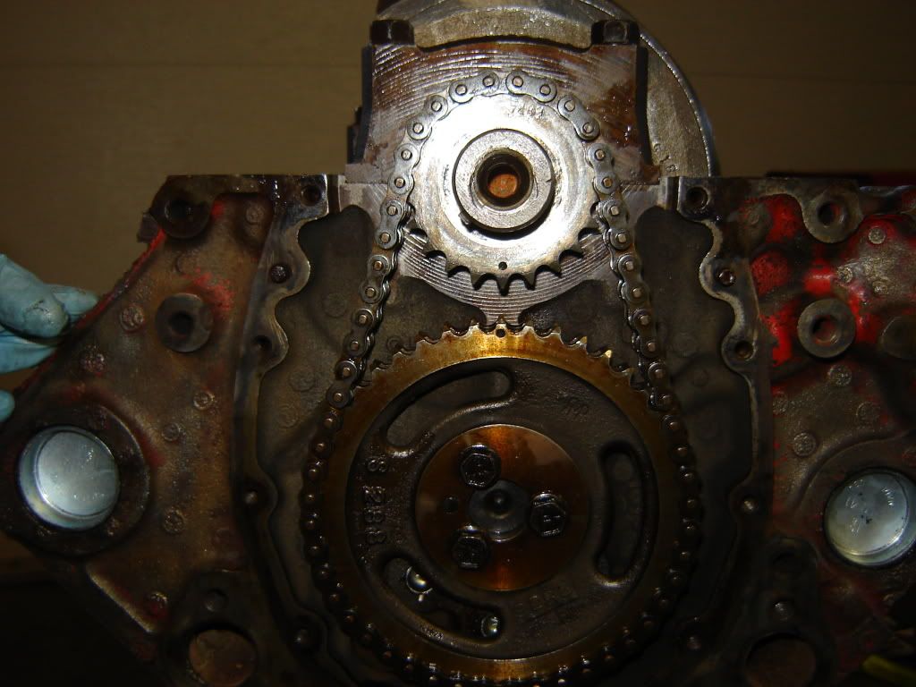

the beast is finally out of the bag, i think the new cam is probably the most exciting part of this build for me
when i looked at it close there was some fuzz stuck the the factory grease in some spots so i gave it a wipe down, it was mostly in the distributor gears. then i got 'er all lubed up with the special comp lube that came with the cam.
i put the gear back on to help ease the cam in, it was pretty stressful i really didnt wana ding any of my bearings

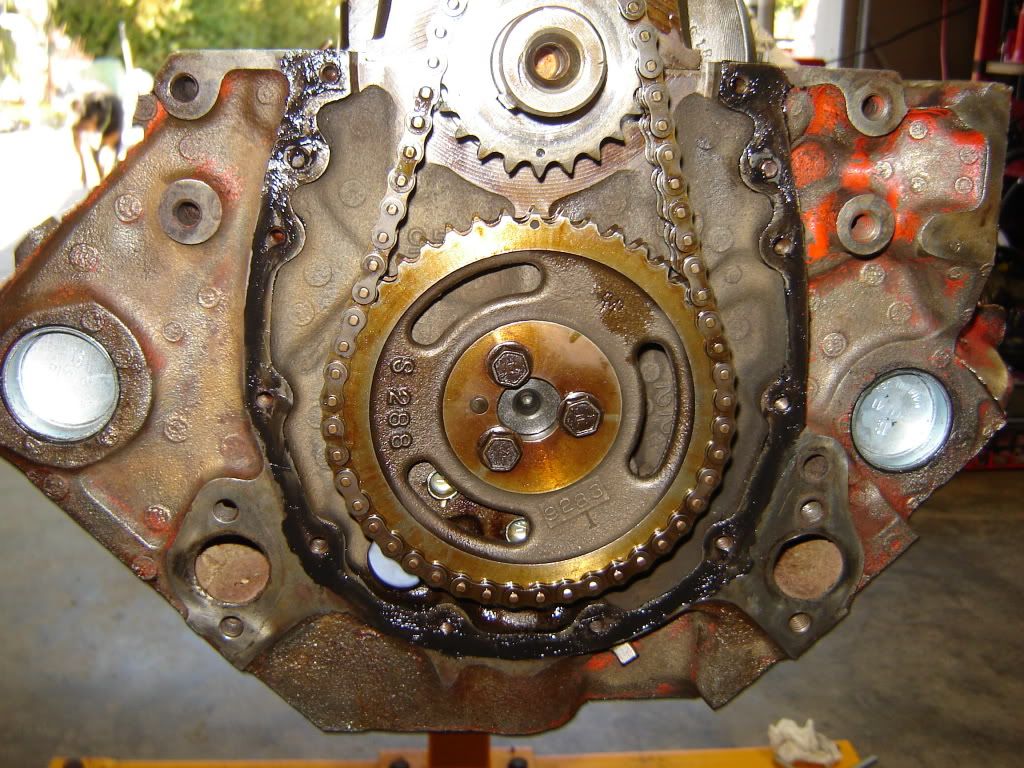

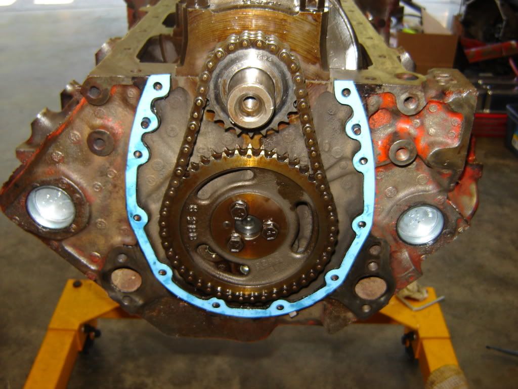

lined up the dots and through the chain on. once i had it on it seemed to me to have a little to much play. so i went to the parts store and picked up a new chain and gears. i test fitted the chain on the old gears and it had the same amount of play. so i went back to the old chain and saved the $50. i had never dealt with the timing chain on one of these before but i figured better safe then sorry. but it turned out to be ok anyways.

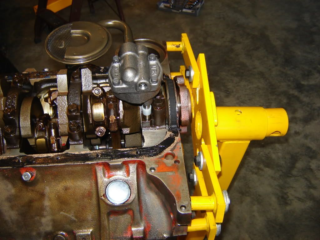

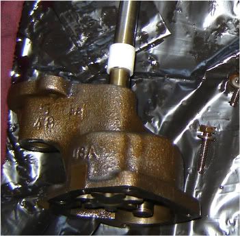

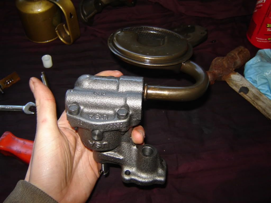

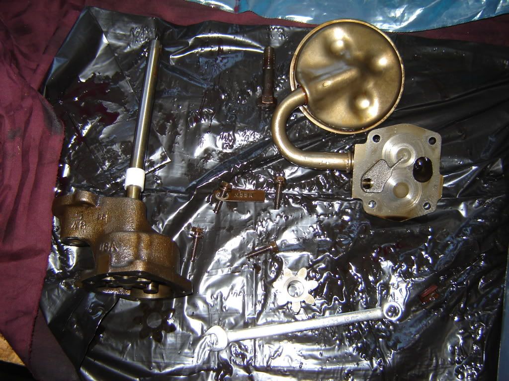

so next i took apart my oil pump to see how the insides were doing
if you look at the cap the scoring on the side nearest the top of the pic there is some pretty deep scoring in the middle circle you can see, also the gear teeth had definitely seen some debry. i didnt get a pic but they had lots of little scores and some deep ones too. then i snapped the little plastic fitting that holds the two shafts together but luckily a new one came in the box with my rear main seals. then later today i went to the parts store to get some odds and ends like timing case gasket and some other things and it turns out a new pump is only 36 bucks so i decided not to chance the old one and got a new one.
this is how it sits. i had already put the old pump on but ill just switch it out tmrw

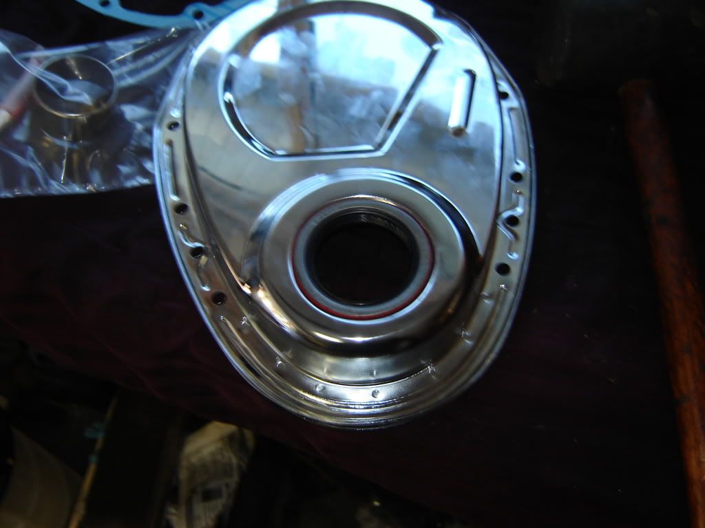

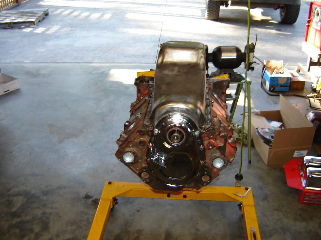

just a little update, got a new timing cover because the old one was pretty warped from being tightened down so much, and i didnt want to risk it leaking oil.
with the new seal pushed in, i just took a rubber hammer and layed a peice of wood across the seal and hammered it until it was in a bit, then finished it off with the rubber hammer
heres a pic of my new pump with the old pickup on it

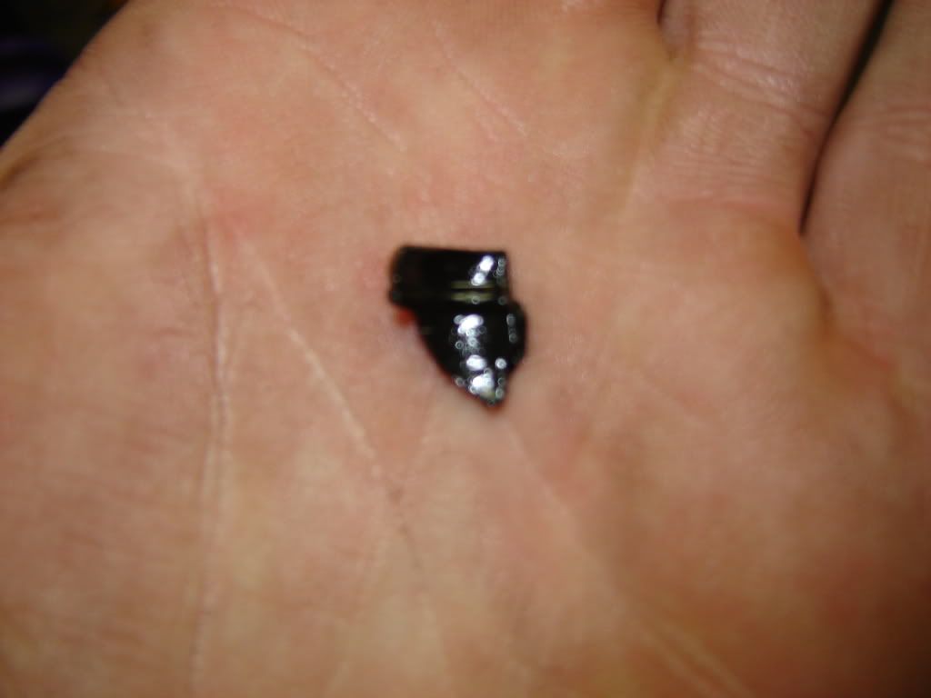

this fell out of the pickup along with some other little pieces, im not really too sure what it is. almost looks like a little piece of the fitting form between the two shafts on the oil pump but im relly not sure
so after i put the new pump on i got all the surfaces ready for gaskets
i smeared just enough sealer on the timing case surface so tha i could stick the gasket in place, they covered the other side of the gaseket with sealer once it was on.

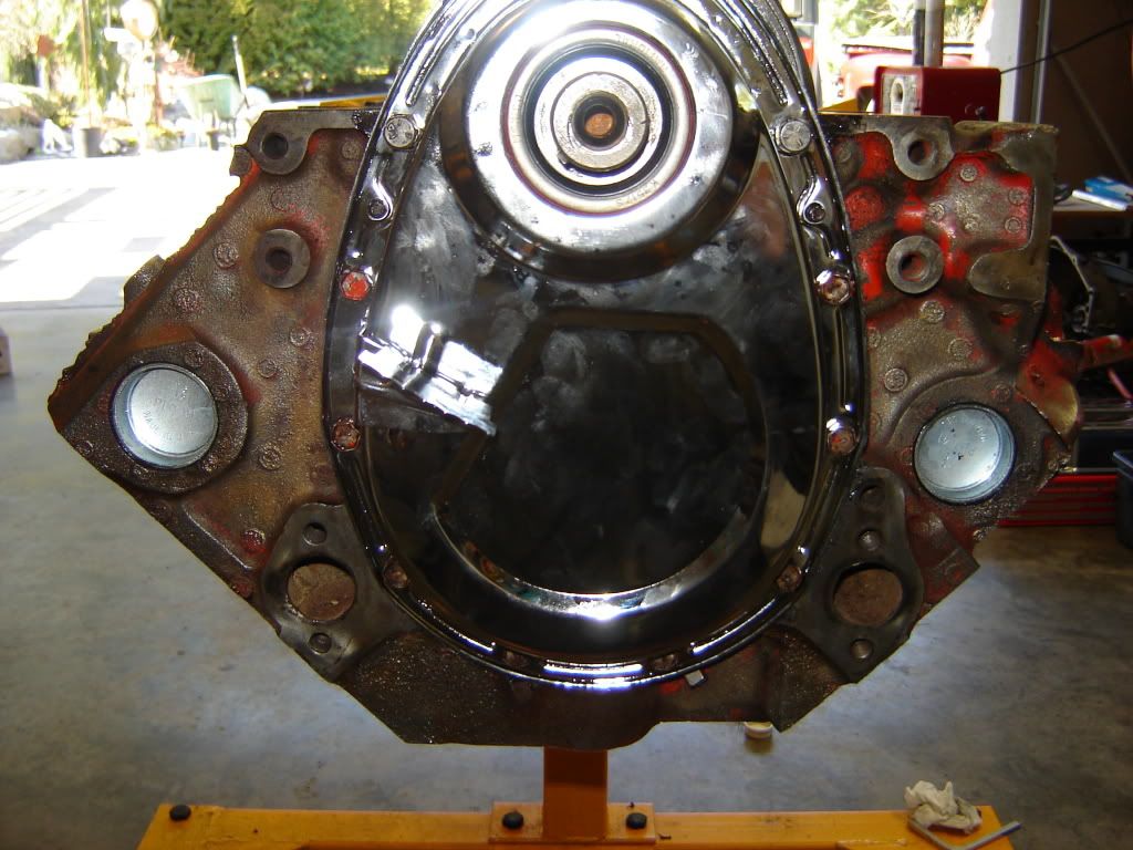

timing cover on, as you can see i went with the nice shiny new bolts :P

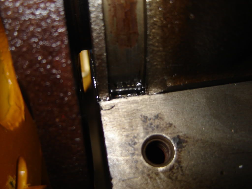

there was some of the sealer in the little nook on the rear main cap, so i had to scrape that off with a little screw driver before i could put the new seals in
pan gasket on with sealer on both sides
pan on and done for the day

     Really good work, I wonder if that piece you found was from your old oil pump/pickup tube ?  Did you happen to look the old one over ?
Offline travh123
  • Posts: 47
Re: 1974 stepside "the burg"
« Reply #20 on: March 26, 2012, 02:15:22 pm »
thanks guys, @bake i took the old pickup off the old pump and put it on the new one. and the old pump had an orange fitting between the two shafts and was super brittle. and if you look at the pic of the piece it has a little ridge running through the middle of it like the oil pump fitting does, so im thinking that was probly it.
this is the fitting im talking about

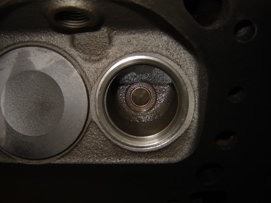

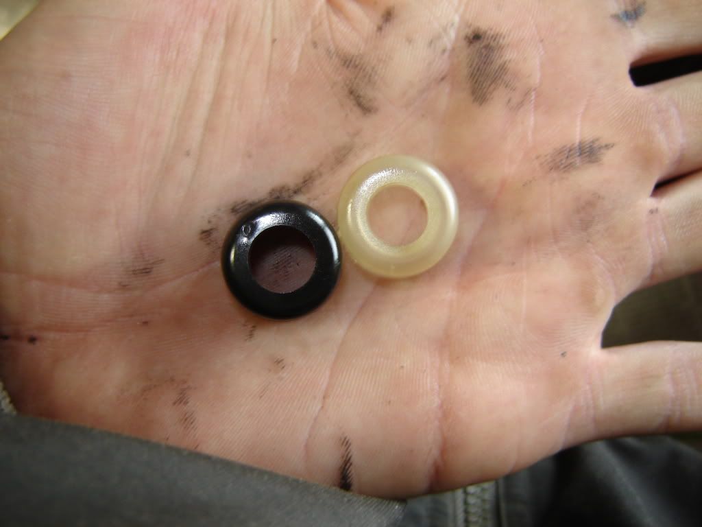

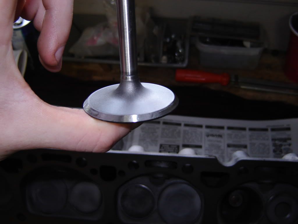

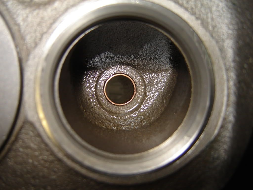

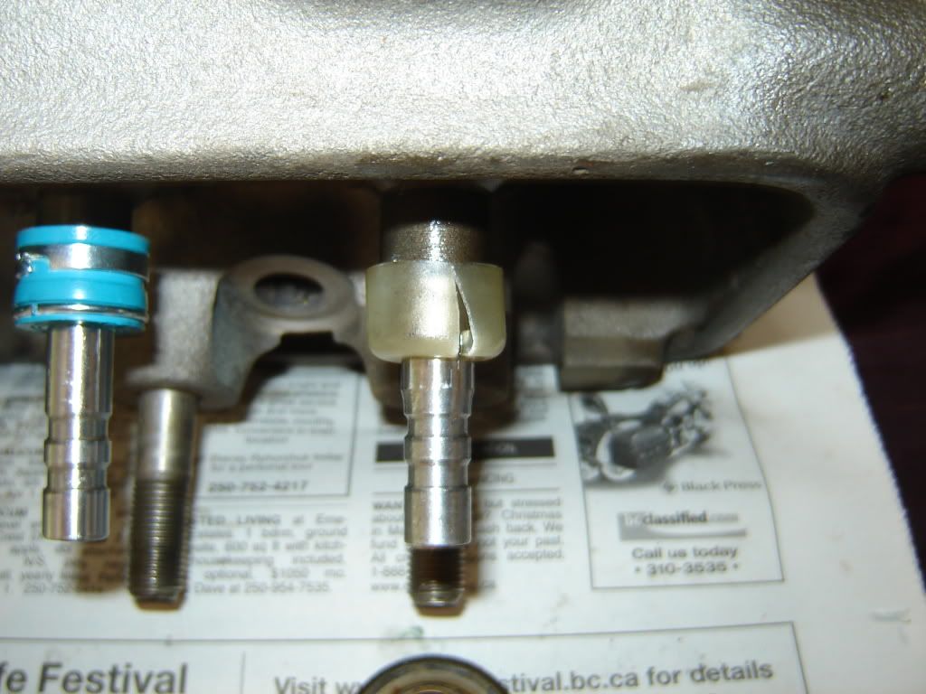

its been slow the last couple days, and to top it off when i went to assemble my heads today and actually get some progress going, i had the wrong exhaust stem seals. the heads i have are from a 3/4 ton so as some may know they have beefier exhaust valves. so the seals i got (not the rubber o-rings) wouldnt fit on and i cracked the first one i tried putting the spring on. so i had to drive all the way back to the machine shop to get new seals because the parts guy at lordco wasnt sure about the difference between the seals, and neither was i. anyways ill have more pics tmrw and hopefully get some real work done.

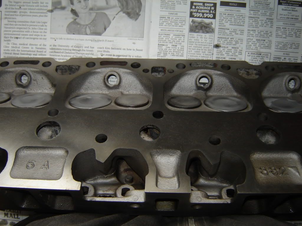

heres a better look at my heads
new seats and guides

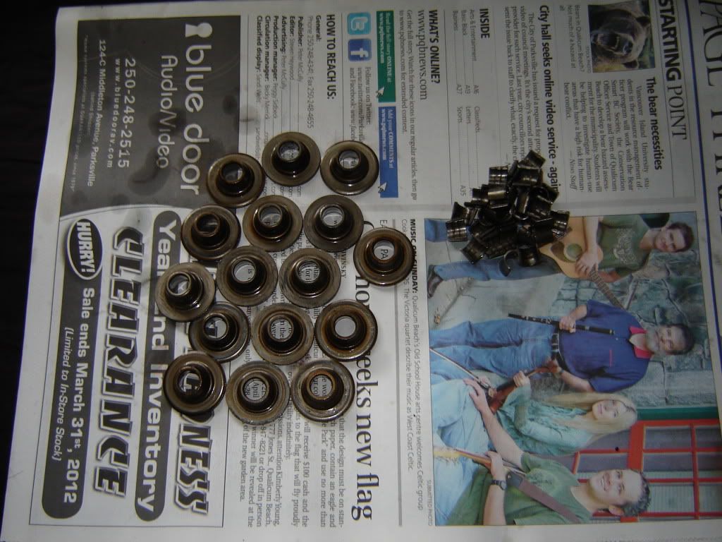

retainers and keepers all cleaned up
so heres what happened when i tried to put the springs on with the smaller seals
this is the bigger seals compared to the smaller ones, minute difference cant really tell from the pic

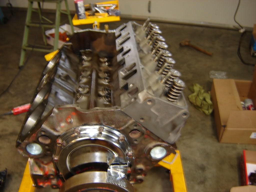

head gasket in place, and head placed on top
and here it is all torqued up and ready to go
so i set the lash on all the valves, and went to prime the oil system. my drill wasnt too good and i dont think it could spin fast enough because i could get oil coming out of one side of rockers but just a bit of bubbling and spitting of oil on the otherside. so im jsut gunna have to be extra carefull on start up and try to prime it again once its in the truck

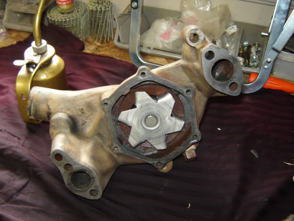

got the water pump cleaned up and pulled the back off to make sure there was no sand inside and washed er out

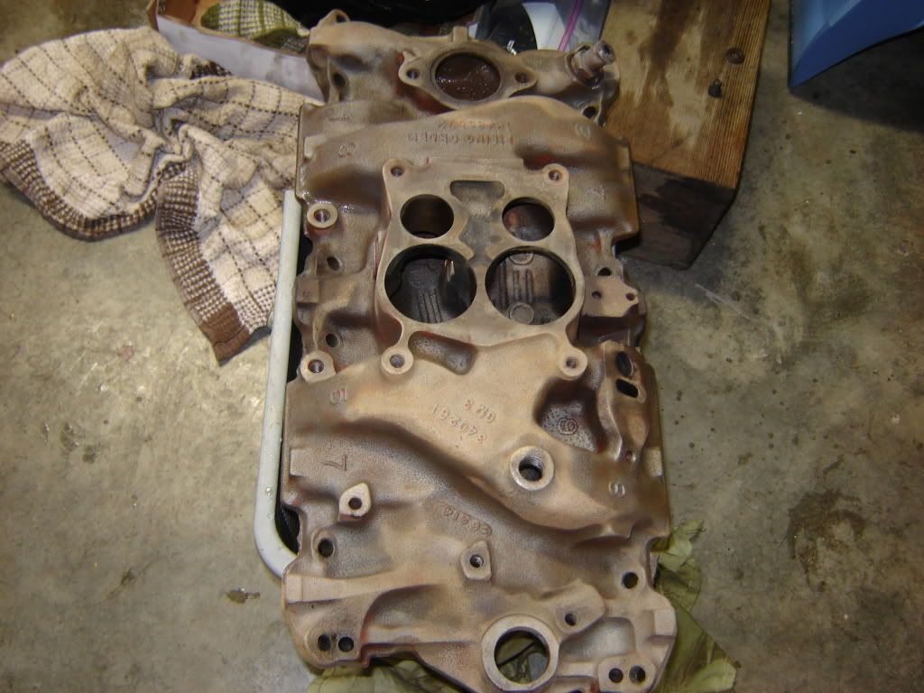

did a second clean up of the intake to get some of the spots i missed
