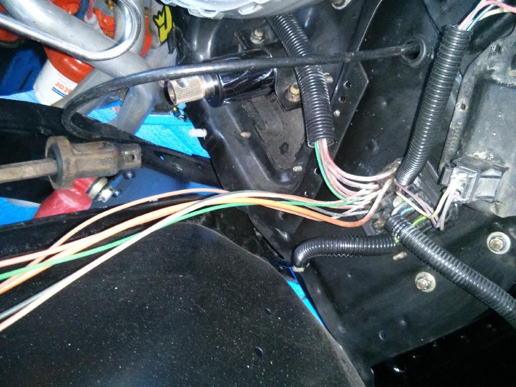

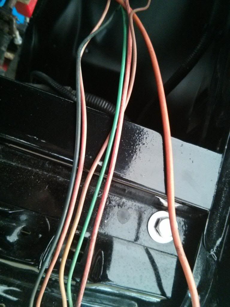

About done with the resto on my 77 K15. Using a wiring harness off an early 80's no A/C 2wd Chevy. Everything is about plugged up at this point but we still have:
Thick Orange wire (10 or 12 gauge wire)
Skinny Green
Skinny pink (this wire is long)
Tan (propertioning valve?)
Also a plug with 3 wires coming out of it- Pink or orange with white stripe, a black wire and a dark green or dark blue colored wire.
Where do these wires go? THANK YOU!!!!

Bake I am so sorry I should have been a lot more descriptive on that. I meant to say all of these were on the engine wiring harness. I will get a pic.

Tonka, show us the connectors at the ends of the wires, as well.  In addition, show us where they exit the loom or firewall, run in the engine compartment, etc. - anything that might make it easier to discern these wires from others with similar colors.
The tan wire with rubber pancake boot in the upper image is for the oil pressure gauge sender.

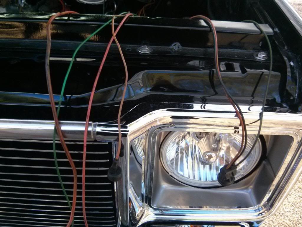

« Reply #6 on: January 27, 2014, 07:32:08 pm »
Does this pic help at all?
I'm not near the truck at the time and I'm having to get my little brother to take the pics and thanks again for your help

« Reply #7 on: January 27, 2014, 08:53:15 pm »
All of it is coming out of the engine harness.
Green should be the coolant temp, brown (tan) looks to be the oil pressure.
Compare them to this image http://www.73-87chevytrucks.com/techinfo/wiring_diagrams/77-80_SBC_eng.jpg

The three-wire connector plugs onto an oil pressure switch for the electric choke circuit.  I agree, the green wire is coolant temp sensor.  Show us the 'free' ends of the wires with their plastic connectors and/or terminals.  Use the diagram Captkaos posted.
