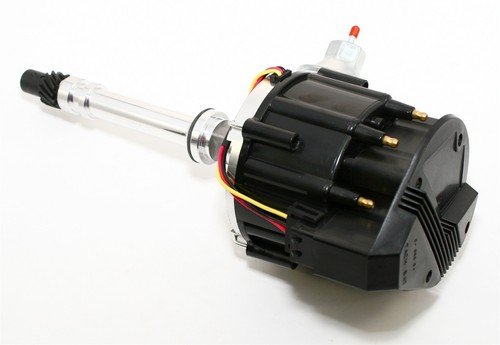

Thank you guys for all the help. Is there a HEI conversation kit you would recommend? I'm looking at HEI distributors and they range from 50-300 dollars, so I'm rather confused with what I need or should get.

I've had a $45 ebay HEI for two years now with not a single issue.  Not sure on the changeover procedure casue mine had HEI already, and especially if you need to keep the smog system.

Okay so I purchased the second clear HEI I got it in the mail yesterday, now what wires should I get?

HEI distributor is in, I connected the red wire from the distributor bat side to my existing yellow wire that was connected to the positive side of the original coil. I checked the wire for volts and it read 11-12. I spliced my red wire to the yellow and when I tried to start I heard a pop and everything went dead and nothing works. Checked the fuses under the dash they are all good. Dont know what's wrong now.
Re: HELP WONT START
« Reply #28 on: February 14, 2015, 06:48:53 pm »
You cannot use the resistance wire on the HEI
You need to run a fused 12V 12 gauge wire from a Key On source at the fuse panel to the distributor. Clip the resistance wire back and tape it up good same with the wire that goes to the R terminal on the starter. Check to see if you blew a fusible link.
