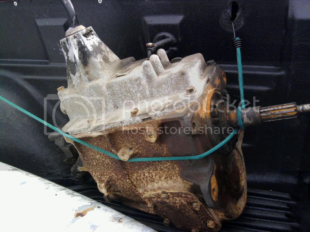

https://forum.ih8mud.com/proxy.php?image=http%3A%2F%2Fi78.photobucket.com%2Falbums%2Fj82%2Fslindsley%2FMobile%2520Uploads%2F1259012547.jpg&hash=26bda7f4556b86648a98312fc5f3f31a
Don't know if that will work, but it's one of the better pictures I found off of google, showing the aluminum top and the relocated shifter(back about 4" from our style transmissions)

I can confirm that the sm465 in the 91 squares had the cast cover, my 91 parts truck had an sm465 pictured here just before i sold it
