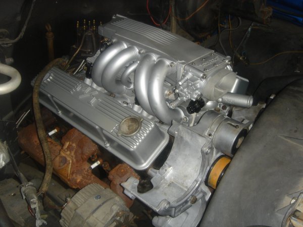

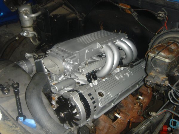

Sunday February 24th, 2008: Pulled the V-belt accessories off the front of the motor to mount the serpentine setup to the block.  Gotta drille/tap a hole in the head to use it though.  I also finished all the polishing to the bracket that I care to do.  The other one is staying raw, or I am painting them...
Re: 73-87chevytrucks.com - Jimmy Project
« Reply #72 on: March 10, 2008, 12:41:40 pm »
Sunday March 1st, 2008: Pulled the 1978 power steering that was currently on the truck and took the 81-up steering pump off the bracket and swapped the serperntine pulley to the 78 pump.  Picked up another partial set of Serpentine pulley brackets (missing the tensioner and all the pulleys).  Remounted the pump back to the truck.

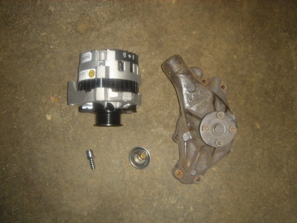

Sunday March 7th, 2008: Picked up an Alternator for the Serpentine, a PCV fitting for the TPI (somehow lost the one I had) and a new Thermostat.  I also picked up a unused waterpump from a buddy that I got the partial Serp setup from.

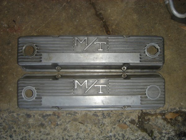

Sunday March 8th, 2008: Went to my mothers house and scrounged around and found some old M/T aluminum valve covers that will probably look better than the ones on there.  I also found the waterpump from a TBI that I couldn't find, so now I have 2.  Went to 3 part houses to find waterpump gaskets and none of them had any, so still have to remove the pump to get the new brackets mounted.  Spent the rest of the evenng until dark cleaning up the valve covers.

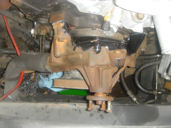

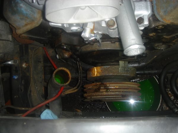

Tuesday March 11th, 2008: Finally got some waterpump gaskets and pulled off the waterpump and installed a the Serpentine one.  Pulled off the V-belt pulley and installed the serpentine pulley.
« Reply #74 on: March 16, 2008, 10:10:17 pm »
Saturday March 15th, 2008: Cleaned up the MT valve covers and decided to just paint them.  Put the waterpump pulley on and then placed the valve covers in place since I didn't have enough bolt to bolt them down.
Sunday March 16th, 2008: Got some bolts for the valve covers and installed them.  Put the Serpentine brackets on and then put the Alternator on.  I love these new hours.
