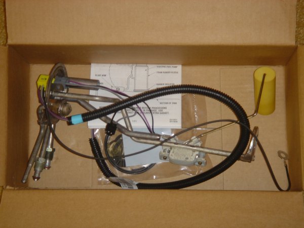

Wednesday August 24th, 2005: recieved the new Blazer EFI sending unit from GM

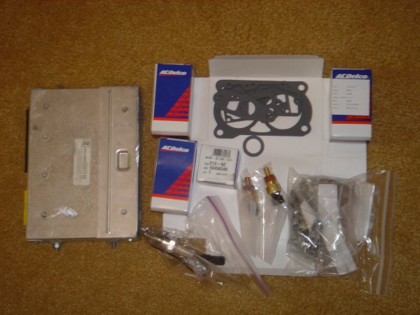

Friday August 25th, 2005: ordered: Sensor kit, 127749 ecm (turbo app ECM), 350 TPI prom, stainless steel bolt kit, and throttle body gasket kit and it arrived on Wednesday.

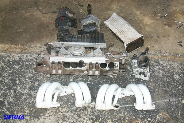

Saturday August 26th, 2005: started laying out the TPI pieces and started cleaning them up.

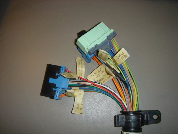

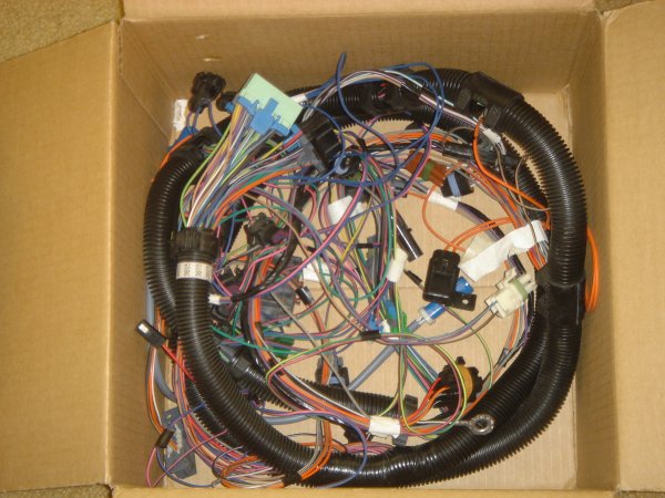

Now that the ECM is here I can start repinning the MAP harness from SLP so it can plug into the 7749 ECM and function properly. This should be fun.

The intake I purchased was a MAF setup (85-89). I am converting the intake to MAP setup. Instead of using the normal MAP ECM (7730) I am using the 7749 computer which allows me to run a 2bar MAP sensor, which adjusts for boost. The 7730 harness is what the SLP setup is for. I have to repin certain wires for the 7730 harness to work with the 7749 ECM. I won't be using a MAF anymore.

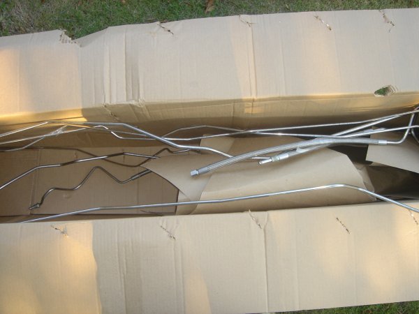

I recieved the EFI stainless fuel lines from Classic Tube. They apparently sent me more than what I needed/wanted though, but... Anyways, here is the latest pic:

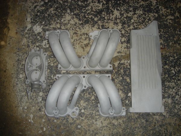

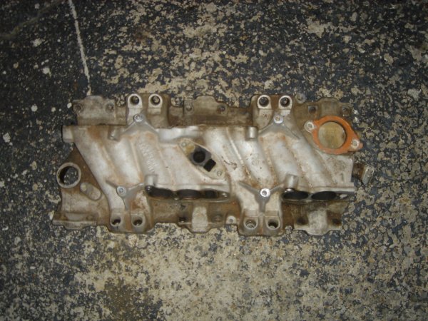

3 weeks ago I sandblasted the upper intake plenum and tubes.
Saturday Sept 3rd, 2005: This weekend I started repinning the ECM 7730 wiring harness to work the the 7749 ECM.

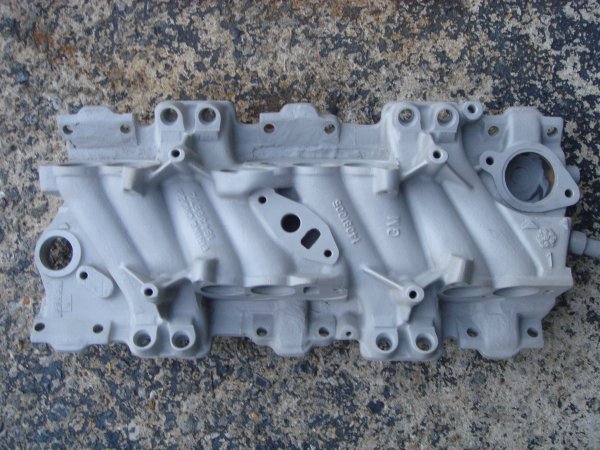

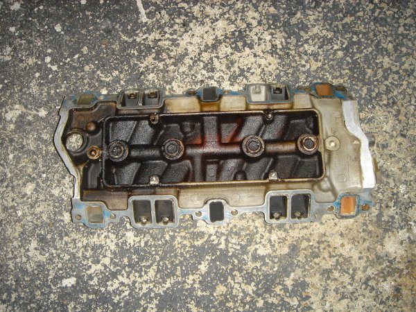

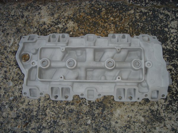

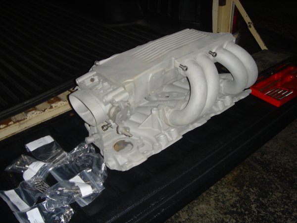

Thursday Sept 8th, 2005: Ok, I must be on a roll. I got in the garage last night and pulled the fuel rails off and disassembled the lower intake to get it cleaned. I also got the pics of the blasted upper pieces.
Re: 73-87chevytrucks.com - Jimmy Project
« Reply #4 on: July 15, 2007, 08:29:02 pm »
Friday Sept. 30th 2005: The lower intake is now sandblasted and I played around and mocked up all of the cleaned pieces. I am still mapping out the wiring in my spare time. The original Pinout sheet I had was different than another one I found so I am going through all the wires now.
Here are the latest pics.

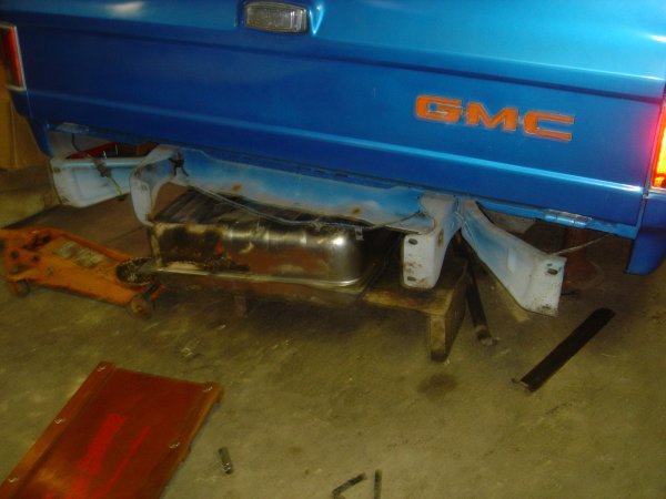

Saturday: September 30th, 2005: Started on replacing the Body Bushings on my Jimmy. Got the tank dropped, fuel fill removed and PB Blasted the bolts/nuts
Sunday: October 1st, 2005: Started on removing the bolts/nuts from the Jimmy. All but 3 came out/off. I had to tack one bolt to the body to get the nut off on the back and I had to cut the floorboard to weld the captured nut bracket back down. I imagine I will have to do the otherside this way also. Should route the new EFI lines once that is done.
