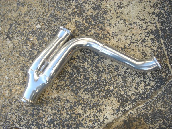

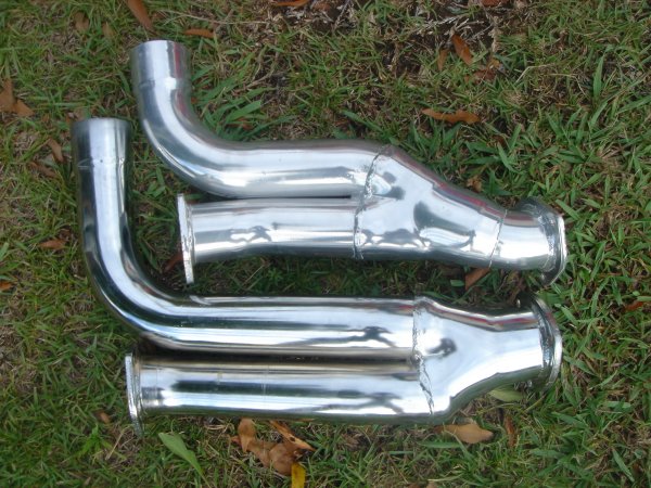

Little update:
Friday, Oct 3,2008: I cut on both Y-pipes that I recieved from Thorley to make one that would fit the truck.  Got 2 of the pipes close
Saturday, Oct 4,2008: After some serious hacking and cutting I got the pipes cut down so they would be close enough to put together
Sunday, Oct 5,2008: Toolmaster came over and got them tacked up and weled up the pipes for me.  Now I just need to send them off to get coated.  No pics as my camara has screwed up on me...
This is where I started (don't have pics of the after fab)

Little update:
Makes me glad I ordered the straight-back long tubes and had a y-pipe fab'd.  How bad was it?  Was it the trans crossmember or the trans itself in the way?
'85 C10 SWB 350 700R4 TKO600
Re: 73-87chevytrucks.com - Jimmy Project
« Reply #111 on: October 07, 2008, 11:19:56 am »
The first pipe I got was just WRONG.  If it had the 3" collector or even a 2.5" instead of a 2.25" on it and wasn't welded so the outlet was pointing towards the framerail, I could have used it.  The second was touching the torque converter WITH pressure, and on the outlet it was pressed up against the floorpan.

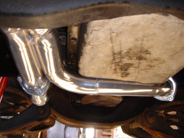

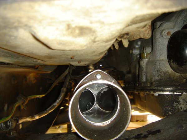

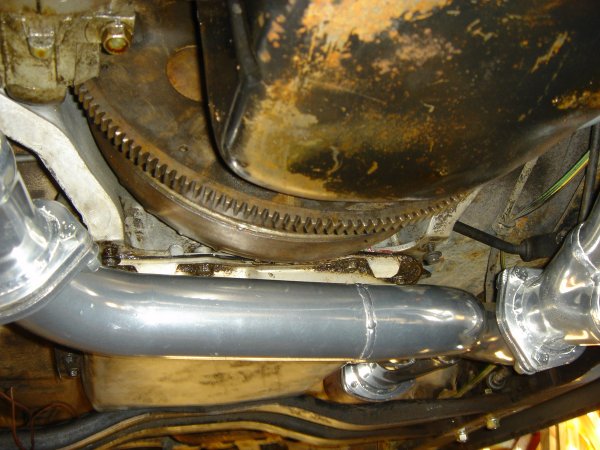

Friday, Oct 31st, 2008: I received they Y-pipe back from Doug Thorley after It was ceramic coated.
This is what I got coated:
Saturday, Nov 1st, 2008: I got it installed!
This is it installed:
This is the floor/crossmember clearance:

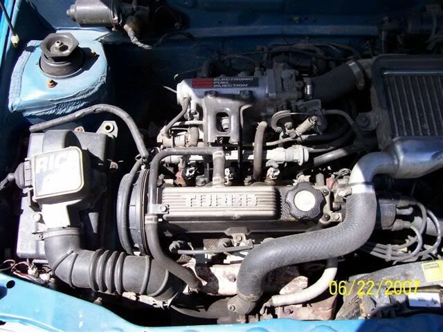

Wow Chris, that looks much better.
Please post PICS of the turbo install.  I am interested in how it goes together.
My first "brand new" car was turbocharged.  Chevy Sprint 3 cylinder, 1 litre built by Suzuki.
A really fun car to drive.  43mpg with using the turbo.
Jeff
