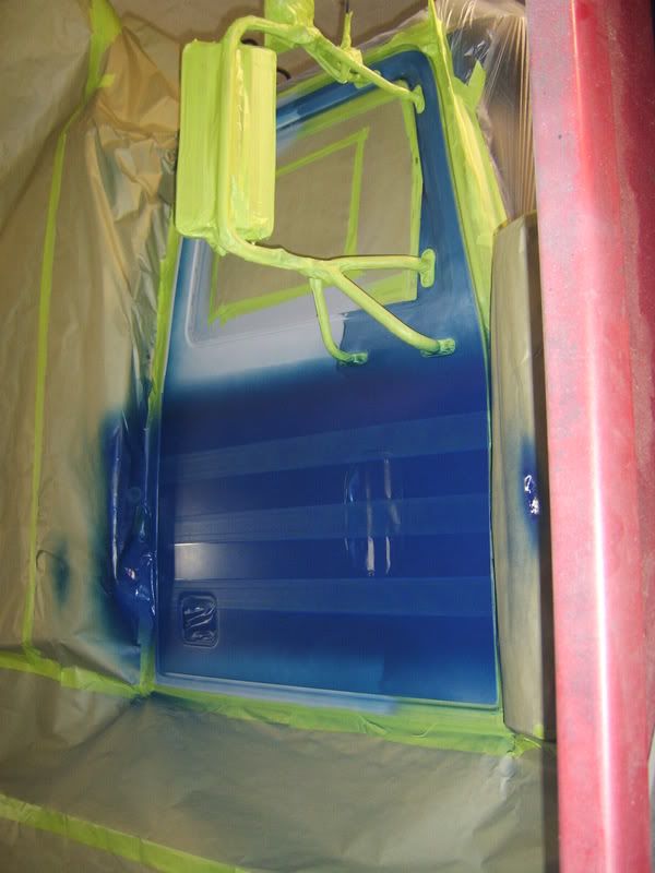

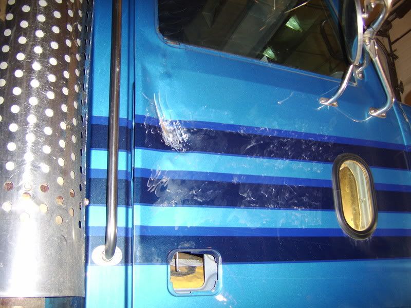

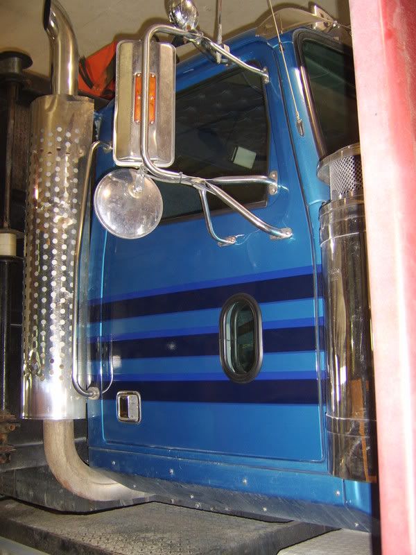

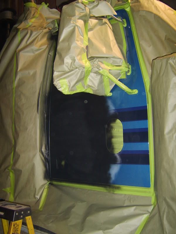

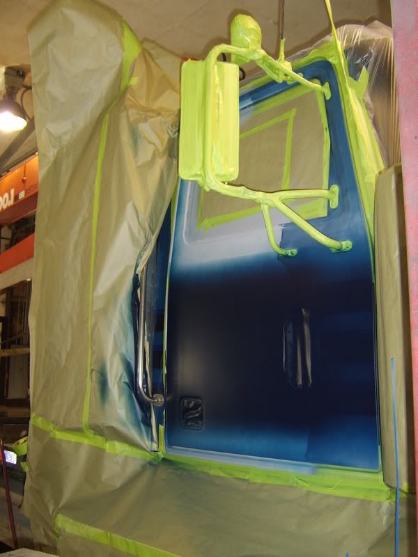

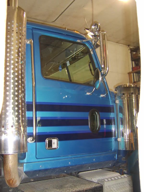

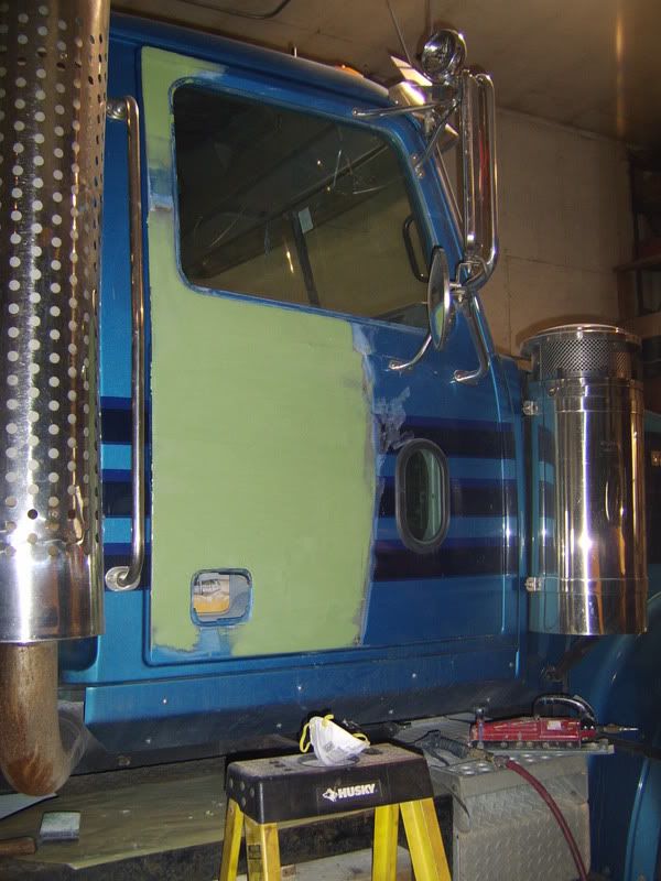

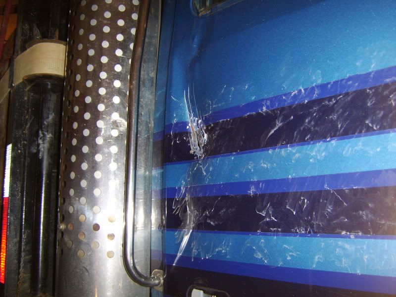

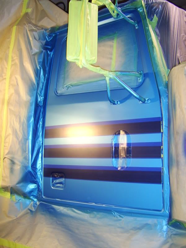

The door on this Western Star was creased so bad it actually had a hole torn in it. I looked from Florida to Canada to California, no used doors. A new one for just the shell was around $2,500. I pulled it, welded the tear up, pulled it some more, did allot of hammer and dolly work. Did use some filler, but I got it strait with only two coats of filler. After it was blocked out the thickest spot was about an 1/8". Did this one about a year ago and it still looks fine. It gets is fair share of vibration as its a concrete form truck and does allot of off road / job site time. It was a rack of forms that tipped over off the other form truck that did the damage. The white crap all over the door used to be the logo before I erased it with a vinyl eraser.
Pull pins welded on.
Filler applied.
Filler blocked out, & self etching primered.
High build urethane primer. Body color cut in on jamb.
Dark blue base coat.
Purple base coat.
Overall body color base coat.
Cleared.
