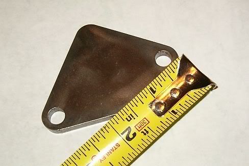

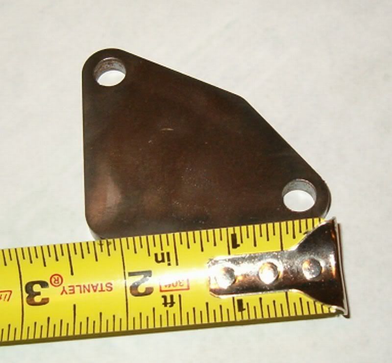

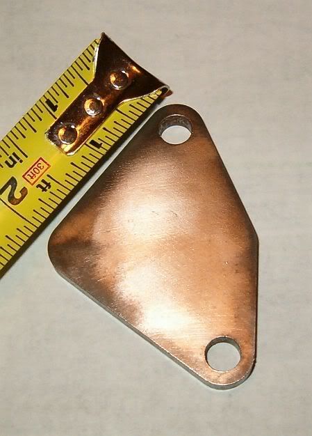

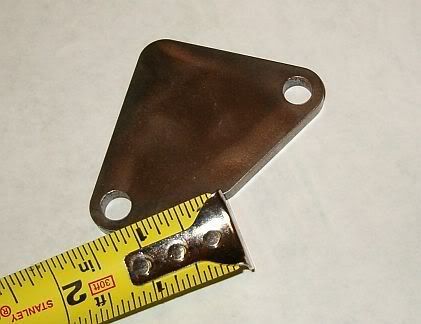

You can actually just leave the valve on and remove and plug the vacuum hose. I have a bunch of EGR block off plates if anyone needs one.
I'm interested in one of those plates.
Re: EGR?
« Reply #9 on: November 28, 2007, 07:00:29 pm »
OK I have 6 of them left
Re: EGR?
« Reply #10 on: November 29, 2007, 09:53:57 am »
You don't have one for a TPI do you?
Re: EGR?
« Reply #11 on: November 29, 2007, 06:00:51 pm »
If it'll fit your manifold you're more than welcome to one. I've had these for years. I had the machine shop make me a bunch of em...

« Reply #14 on: December 07, 2007, 07:05:23 am »
I dropped it in the mail 4 u yesterday so be on the look out for it.
