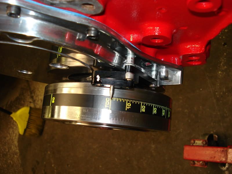

« Reply #10 on: January 14, 2008, 06:59:47 pm »
Your timing tab should be more off to the right...Like this...
Offline Redneckchevy
  • Posts: 697
    • Photo Bucket
Re: Balancer / timing
« Reply #11 on: January 14, 2008, 07:00:55 pm »
Nice set up...Never seen a pointer like that..Only seen the ones with all the teeth :o

« Reply #13 on: January 14, 2008, 07:12:05 pm »
I like it alot Good low profile look.
