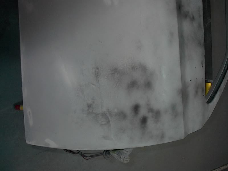

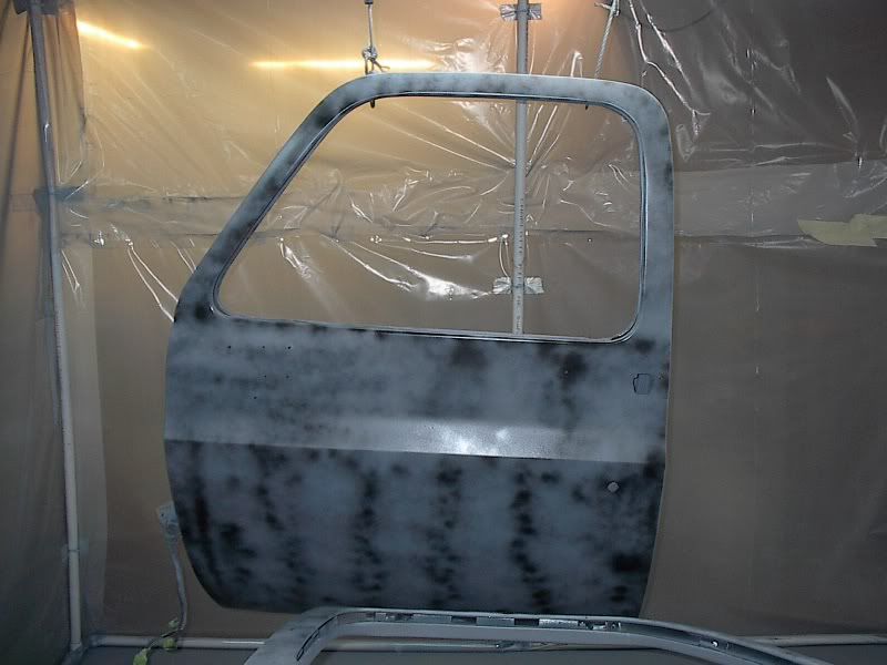

This picture is with guide coat sprayed on so I can start sanding:

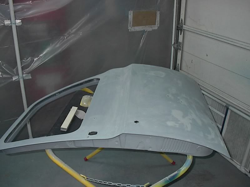

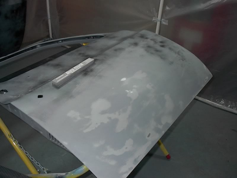

Starting to sand with 320 sand paper:
Keep sanding until all the guide coat comes off:

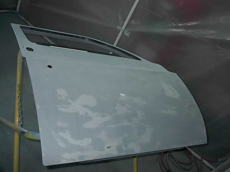

Door finished, waiting to be wax and grease removed, then sealer (reduced epoxy) then color and clear:

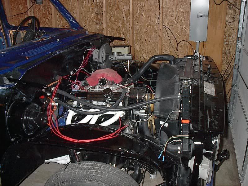

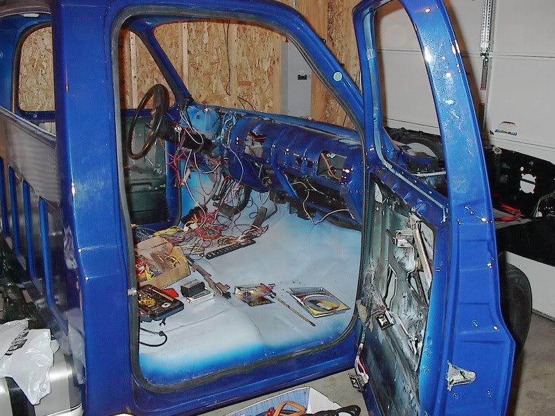

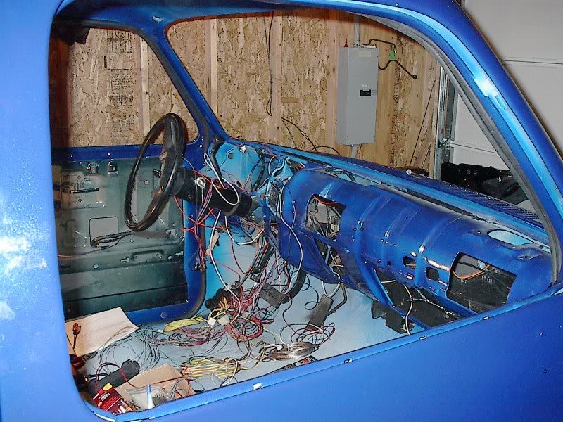

Here is an update on my project:
I do bodywork and paint in my heated detached garage and assembly in my attached UNheated garage:
Time for some wiring:
(ignore the orange peel in my door :-[)
I have the interior lights, heater fan working along with the power windows and door locks.  Had to replace the drivers side lift motor (still have all my fingers - THANKS to this forum and Jeff's 73-87.com/garage site).
I have the wires going to their respective place but have not tied most in:
Truck as it sits right now:
I have the bottom of the hood painted and should finish painting the top this weekend.
Thanks for looking - Jeff :)
